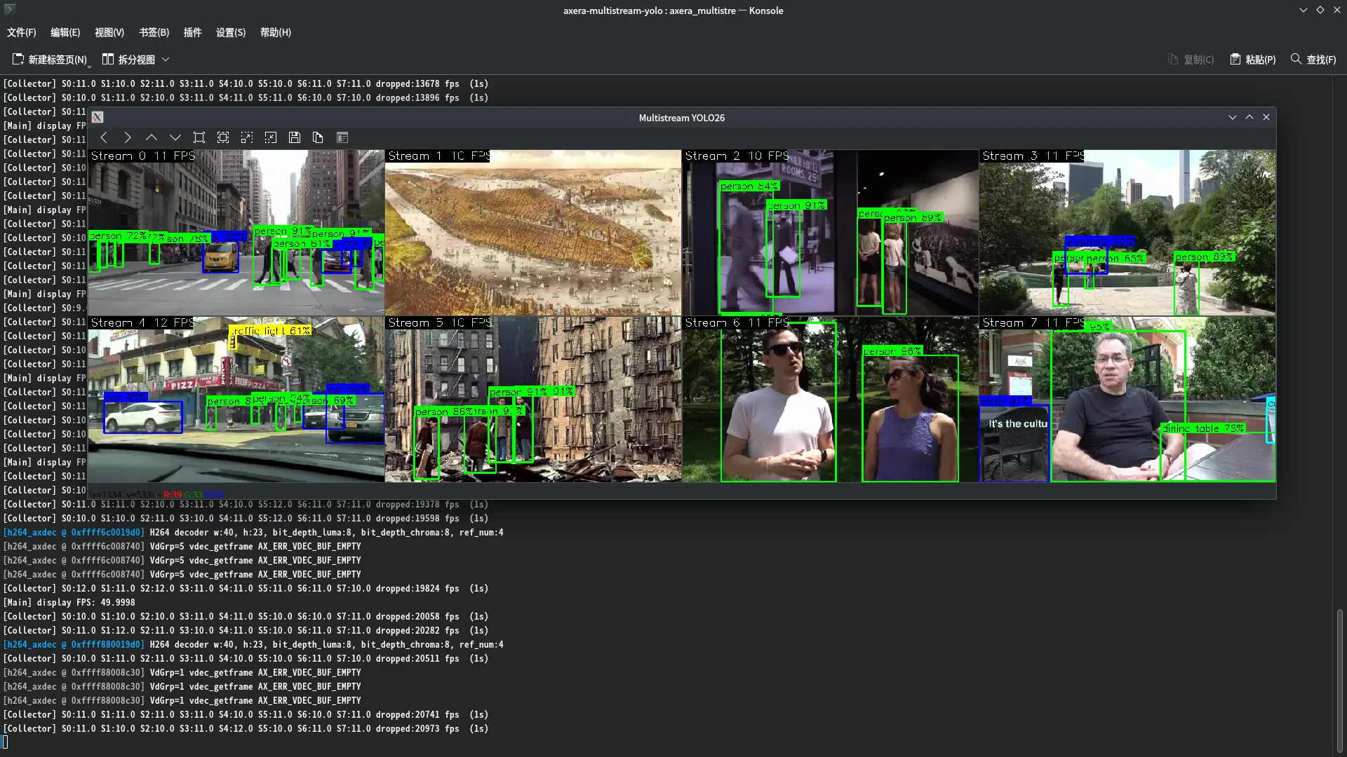

axcl-multistream-yolo demo output
display=false 时仅输出帧率监控日志:
[Collector] S0:14.0 S1:13.0 S2:14.0 S3:13.0 fps (1s)
[Collector] S0:15.0 S1:14.0 S2:14.0 S3:14.0 fps (1s)

性能数据(YOLO26n,640×640)​
配置帧率
单路端到端~40 fps
8 路并发(mosaic 显示)53-57 fps mosaic
AXCL 多线程扩展上限~120 fps(3 线程后停滞)
