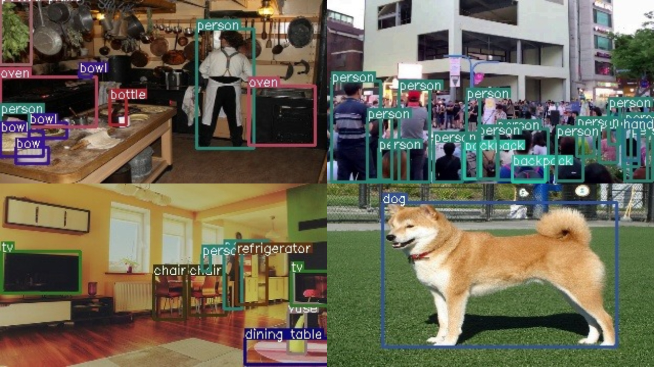

run_detector demo result

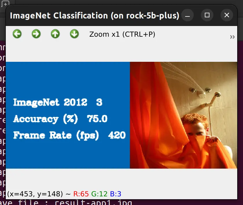

ImageNet 目标分类​
源码位置 ./demos/classification/imagenet_classification.cpp
Host
./bin/imagenet_classification -m assets/models/EfficientNetB0_4.dxnn -i example/imagenet_classification/imagenet_val_map.txt -p sample/ILSVRC2012/
imagenet_classification demo result

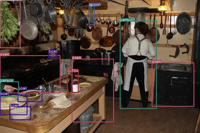

YOLOv5 目标识别​
源码位置 ./demos/object_detection/yolo_1channel.cpp
Host
./bin/yolo -m assets/models/YOLOV5S_3.dxnn -i sample/1.jpg -p 1
rock@rock-5b-plus:~/ssd/deepx/v2.1.0/dx_app$ ./bin/yolo -m assets/models/YOLOV5S_3.dxnn -i sample/1.jpg -p 1
modelpath: assets/models/YOLOV5S_3.dxnn
videoFile:
imgFile: sample/1.jpg
cameraInput: 0
rtspURL:
cfg.numBoxes: 16128
YoloParam:
- conf_threshold: 0.25, score_threshold: 0.3, iou_threshold: 0.4, num_classes: 80, num_layers: 3
- LayerParam: [ name : 378, 64 x 64 x 3boxes], anchorWidth [10, 16, 33, ], anchorHeight [13, 30, 23, ], tensor index [0, ]
- LayerParam: [ name : 439, 32 x 32 x 3boxes], anchorWidth [30, 62, 59, ], anchorHeight [61, 45, 119, ], tensor index [1, ]
- LayerParam: [ name : 500, 16 x 16 x 3boxes], anchorWidth [116, 156, 373, ], anchorHeight [90, 198, 326, ], tensor index [2, ]
- classes: [person, bicycle, car, motorcycle, airplane, bus, train, truck, boat, trafficlight, firehydrant, stopsign, parkingmeter, bench, bird, cat, dog, horse, sheep, cow, elephant, bear, zebra, giraffe, backpack, umbrella, handbag, tie, suitcase, frisbee, skis, snowboard, sportsball, kite, baseballbat, baseballglove, skateboard, surfboard, tennisracket, bottle, wineglass, cup, fork, knife, spoon, bowl, banana, apple, sandwich, orange, broccoli, carrot, hotdog, pizza, donut, cake, chair, couch, pottedplant, bed, diningtable, toilet, tv, laptop, mouse, remote, keyboard, cellphone, microwave, oven, toaster, sink, refrigerator, book, clock, vase, scissors, teddybear, hairdrier, toothbrush, ]
YOLO created : 16128 boxes, 80 classes,
Detected 9 boxes.
BBOX:person(0) 0.873049, (307.488, 138.329, 401.201, 364.832)
BBOX:bowl(45) 0.734457, (46.3406, 315.319, 106.942, 346.32)
BBOX:bowl(45) 0.716818, (25.4639, 359.278, 79.1976, 392.92)
BBOX:oven(69) 0.684362, (0.127205, 227.296, 154.541, 325.347)
BBOX:person(0) 0.617352, (-0.210583, 294.967, 48.6577, 331.301)
BBOX:bowl(45) 0.560206, (-0.456394, 328.875, 69.3085, 379.828)
BBOX:oven(69) 0.531655, (389.404, 246.171, 495.742, 358.992)
BBOX:bottle(39) 0.443776, (172.721, 269.242, 200.909, 322.747)
BBOX:pottedplant(58) 0.393512, (-0.180674, 85.4695, 51.1122, 207.897)
[DXAPP] [INFO] total time : 151422 us
[DXAPP] [INFO] per frame time : 151422 us
[DXAPP] [INFO] fps : 6.62252
yolov5s demo result

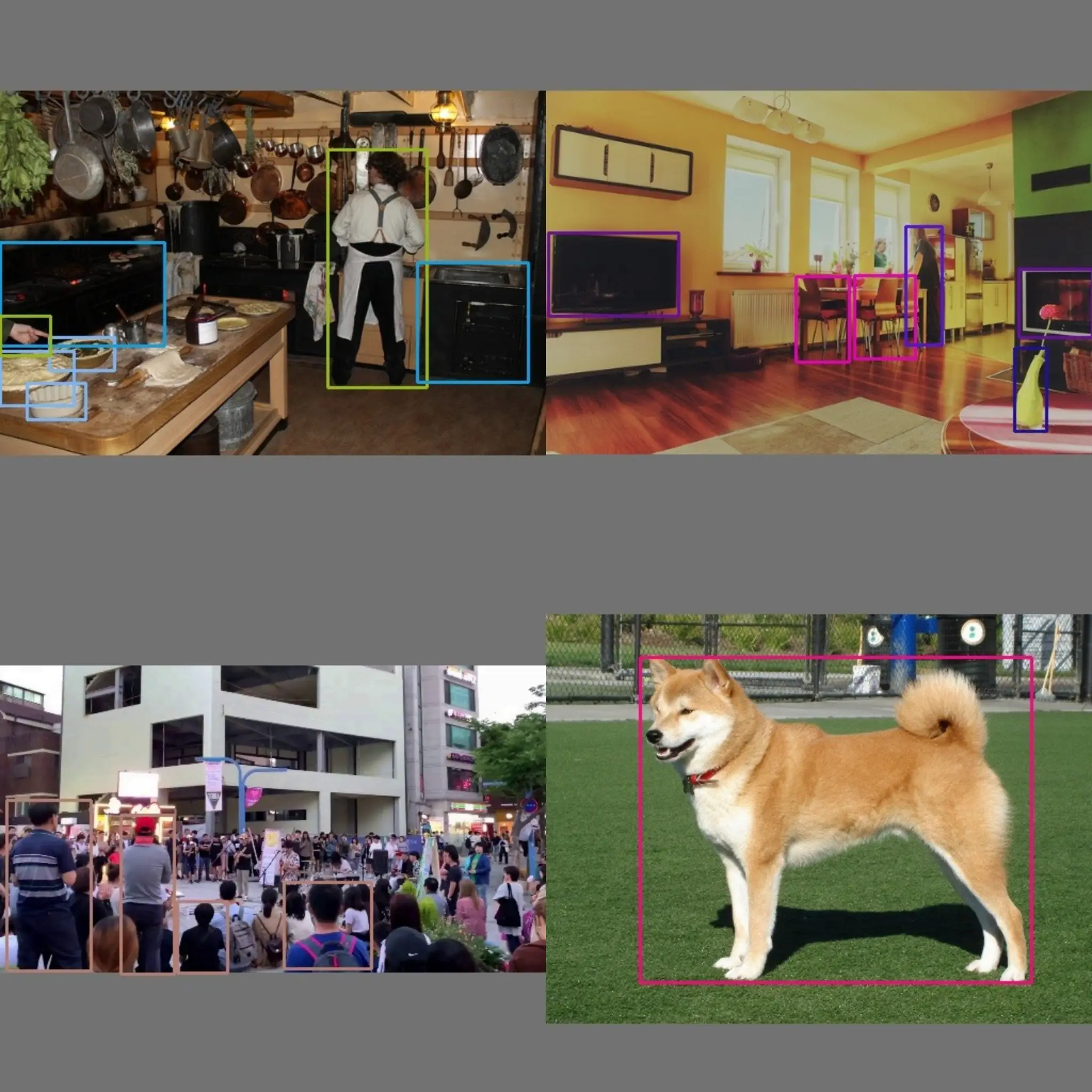

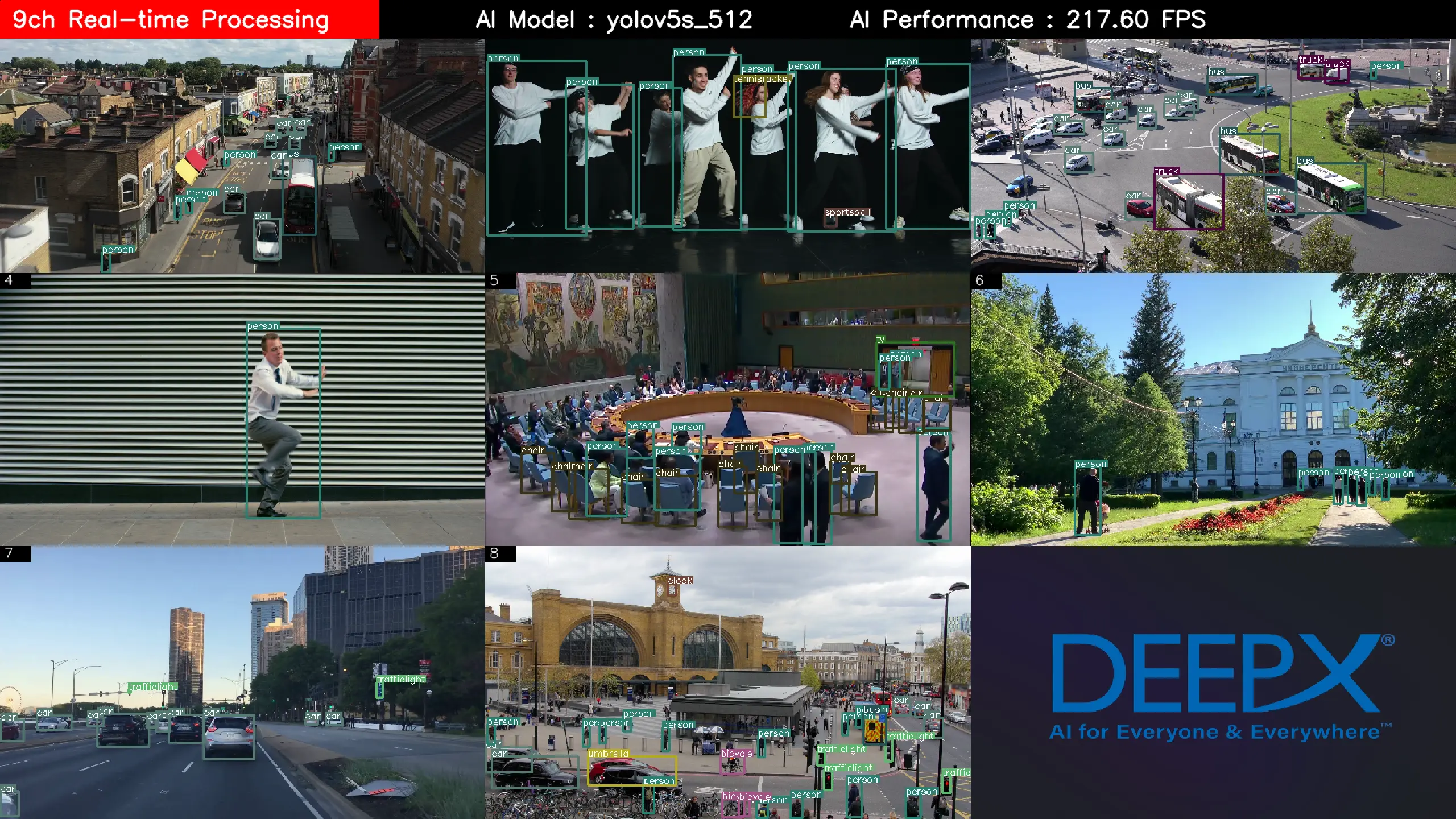

多路目标识别​
源码位置 ./demos/object_detection/yolo_demo_multi.cpp
Host
./bin/yolo_multi -c ./example/yolo_multi/ppu_yolo_multi_demo.json
请参考以下 json 构造配置文件
"usage": "multi",
"model_path": "./assets/models/YOLOV5S_PPU.dxnn",
"model_name": "yolov5s_512_ppu",
"video_sources": [
["./assets/videos/dron-citry-road.mov", "offline", 60],
["./assets/videos/dance-group.mov", "offline", 60],
["./assets/videos/cctv-city-road2.mov", "offline", 60],
["./assets/videos/dance-solo.mov", "offline", 60],
["./assets/videos/codec_test_clip_h264_16Mbps.mp4", "offline", 60],
["./assets/videos/codec_test_clip_h265_8Mbps.mp4", "offline", 60],
["./assets/videos/blackbox-city-road.mp4", "offline", 60],
["./assets/videos/cctv-city-road.mov", "offline", 60]
"display_config": {
"display_label": "output",
"capture_period": 30,
"output_width": 1920,
"output_height": 1080,
"show_fps": true
yolov5s multi result

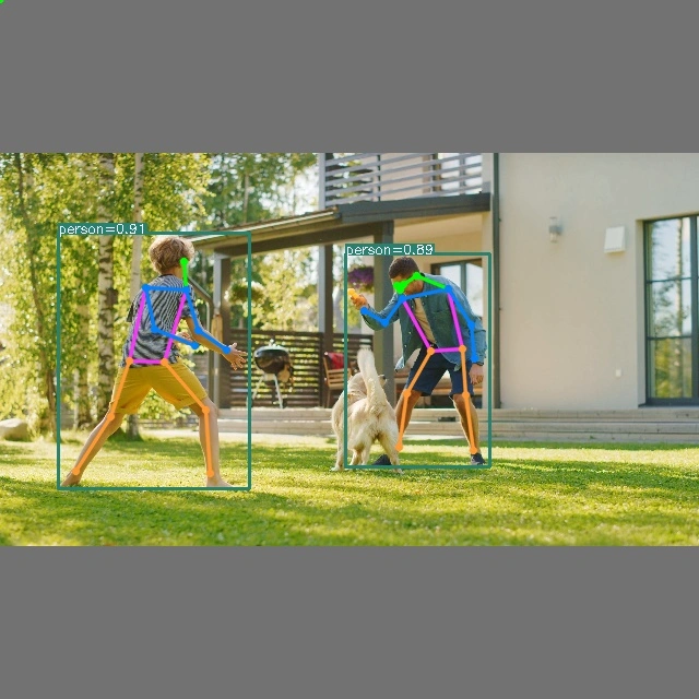

姿态识别​
源码位置 ./demos/pose_estimation/yolo_pose.cpp
Host
./bin/pose -m assets/models/YOLOV5Pose640_1.dxnn -i sample/7.jpg -p 0
rock@rock-5b-plus:~/ssd/deepx/v2.1.0/dx_app$ ./bin/pose -m assets/models/YOLOV5Pose640_1.dxnn -i sample/7.jpg -p 0
modelpath: assets/models/YOLOV5Pose640_1.dxnn
videoFile:
imgFile: sample/7.jpg
cameraInput: 0
[DXAPP] [WARN] The numBoxes is not set. Please check the numBoxes.
cfg.numBoxes: 25500
YoloParam:
- conf_threshold: 0.3, score_threshold: 0.3, iou_threshold: 0.4, num_classes: 1, num_layers: 0
- classes: [person, ]
YOLO created : 25500 boxes, 1 classes,
Detected 2 boxes.
BBOX:person(0) 0.908174, (52.9721, 212.993, 228.171, 448.604)
BBOX:person(0) 0.892166, (316.646, 232.729, 448.644, 428.188)
[DXAPP] [INFO] total time : 157653 us
[DXAPP] [INFO] per frame time : 157653 us
[DXAPP] [INFO] fps : 6.36943
YOLOV5Pose result

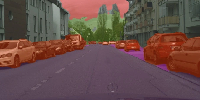

图像分割​
源码位置 ./demos/segmentation/segmentation.cpp
图像分割​
Host
./bin/segmentation -m assets/models/DeepLabV3PlusMobileNetV2_2.dxnn -i sample/8.jpg
rock@rock-5b-plus:~/ssd/deepx/v2.1.0/dx_app$ ./bin/segmentation -m assets/models/DeepLabV3PlusMobileNetV2_2.dxnn -i sample/8.jpg
modelpath: assets/models/DeepLabV3PlusMobileNetV2_2.dxnn
parameter: 0
imgFile: sample/8.jpg
videoFile:
cameraInput: 0
[DXAPP] [INFO] total time : 316640 us
[DXAPP] [INFO] per frame time : 316640 us
[DXAPP] [INFO] fps : 3.16456
segmentation result

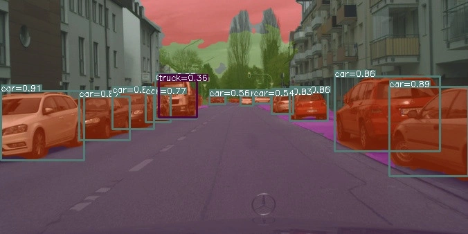

图像检测与分割​
Host
./bin/od_segmentation -m0 assets/models/YOLOV5S_3.dxnn -p0 1 -m1 assets/models/DeepLabV3PlusMobileNetV2_2.dxnn -i sample/8.jpg
rock@rock-5b-plus:~/ssd/deepx/v2.1.0/dx_app$ ./bin/od_segmentation -m0 assets/models/YOLOV5S_3.dxnn -p0 1 -m1 assets/models/DeepLabV3PlusMobileNetV2_2.dxnn -i sample/8.jpg
od_modelpath: assets/models/YOLOV5S_3.dxnn
seg_modelpath: assets/models/DeepLabV3PlusMobileNetV2_2.dxnn
videoFile:
cameraInput: 0
cfg.numBoxes: 16128
YoloParam:
Detected 13 boxes.
BBOX:car(2) 0.89303, (0.480949, 227.935, 93.051, 302.253)
BBOX:car(2) 0.882933, (426.194, 222.593, 511.927, 321.371)
BBOX:car(2) 0.862958, (86.1822, 234.01, 142.1, 281.351)
BBOX:car(2) 0.848508, (317.336, 228.731, 358.4, 260.354)
BBOX:car(2) 0.84496, (366.256, 210.955, 482.539, 293.438)
BBOX:car(2) 0.818492, (297.631, 231.888, 322.464, 252.024)
BBOX:car(2) 0.777943, (122.689, 229.362, 168.695, 268.896)
BBOX:car(2) 0.711904, (158.728, 229.85, 187.161, 261.946)
BBOX:car(2) 0.666848, (262.793, 232.572, 276.692, 243.45)
BBOX:car(2) 0.52669, (169.424, 215.719, 215.506, 257.233)
BBOX:car(2) 0.514303, (277.343, 232.588, 296.351, 241.116)
BBOX:car(2) 0.506402, (228.703, 232.507, 246.448, 241.995)
BBOX:truck(7) 0.343093, (173.549, 215.718, 214.675, 256.886)
[DXAPP] [INFO] total time : 300656 us
[DXAPP] [INFO] per frame time : 300656 us
[DXAPP] [INFO] fps : 3.33333
segmentation and objection detection result

[sample/ILSVRC2012/1.jpeg] Top1 Result : class 321 (admiral)
[sample/ILSVRC2012/2.jpeg] Top1 Result : class 846 (table lamp)
[sample/ILSVRC2012/3.jpeg] Top1 Result : class 794 (shower curtain)
Yolov5s Python 示例​
源码位置 templates/python/yolov5s_example.py
Host
python3 templates/python/yolov5s_example.py
(.venv) rock@rock-5b-plus:~/ssd/deepx/v2.1.0/dx_app$ python3 templates/python/yolov5s_example.py
dxrt inference Done!
decoding output Done!
[Result] Detected 11 Boxes.
[0] conf, classID, x1, y1, x2, y2, : 0.8739, person(0), 383, 66, 501, 348
[1] conf, classID, x1, y1, x2, y2, : 0.7595, bowl(45), 57, 288, 133, 327
[2] conf, classID, x1, y1, x2, y2, : 0.7423, bowl(45), 31, 342, 98, 385
[3] conf, classID, x1, y1, x2, y2, : 0.6719, oven(69), 0, 170, 191, 300
[4] conf, classID, x1, y1, x2, y2, : 0.5923, bowl(45), 0, 303, 86, 368
[5] conf, classID, x1, y1, x2, y2, : 0.5887, oven(69), 487, 201, 621, 342
[6] conf, classID, x1, y1, x2, y2, : 0.5675, person(0), 0, 263, 60, 307
[7] conf, classID, x1, y1, x2, y2, : 0.4376, potted plant(58), 0, 0, 62, 151
[8] conf, classID, x1, y1, x2, y2, : 0.3855, bottle(39), 215, 231, 251, 297
[9] conf, classID, x1, y1, x2, y2, : 0.3226, cup(41), 147, 268, 171, 302
[10] conf, classID, x1, y1, x2, y2, : 0.3183, bowl(45), 155, 167, 181, 185
save file : yolov5s_1.jpg
[Result] Detected 9 Boxes.
[0] conf, classID, x1, y1, x2, y2, : 0.8261, chair(56), 291, 215, 355, 318
[1] conf, classID, x1, y1, x2, y2, : 0.7895, tv(62), 2, 164, 155, 266
[2] conf, classID, x1, y1, x2, y2, : 0.7772, chair(56), 361, 215, 433, 311
[3] conf, classID, x1, y1, x2, y2, : 0.6629, person(0), 422, 158, 463, 296
[4] conf, classID, x1, y1, x2, y2, : 0.6128, vase(75), 548, 299, 586, 399
[5] conf, classID, x1, y1, x2, y2, : 0.5882, tv(62), 553, 208, 640, 286
[6] conf, classID, x1, y1, x2, y2, : 0.5303, person(0), 385, 171, 403, 211
[7] conf, classID, x1, y1, x2, y2, : 0.4672, dining table(60), 470, 360, 637, 423
[8] conf, classID, x1, y1, x2, y2, : 0.4226, refrigerator(72), 451, 168, 510, 290
save file : yolov5s_2.jpg
[Result] Detected 17 Boxes.
[0] conf, classID, x1, y1, x2, y2, : 0.8743, person(0), 18, 476, 318, 1068
[1] conf, classID, x1, y1, x2, y2, : 0.8742, person(0), 420, 528, 615, 1080
[2] conf, classID, x1, y1, x2, y2, : 0.7187, person(0), 993, 753, 1308, 1068
[3] conf, classID, x1, y1, x2, y2, : 0.6268, person(0), 622, 832, 795, 1080
[4] conf, classID, x1, y1, x2, y2, : 0.5648, person(0), 300, 870, 487, 1076
[5] conf, classID, x1, y1, x2, y2, : 0.5136, person(0), 1785, 791, 1920, 1076
[6] conf, classID, x1, y1, x2, y2, : 0.5084, backpack(24), 802, 881, 903, 1061
[7] conf, classID, x1, y1, x2, y2, : 0.4755, backpack(24), 1083, 963, 1290, 1080
[8] conf, classID, x1, y1, x2, y2, : 0.4404, person(0), 1732, 723, 1841, 982
[9] conf, classID, x1, y1, x2, y2, : 0.4285, person(0), 1657, 630, 1725, 855
[10] conf, classID, x1, y1, x2, y2, : 0.4195, person(0), 1597, 750, 1710, 967
[11] conf, classID, x1, y1, x2, y2, : 0.4082, person(0), 885, 787, 1012, 1061
[12] conf, classID, x1, y1, x2, y2, : 0.4081, person(0), 236, 693, 393, 1057
[13] conf, classID, x1, y1, x2, y2, : 0.4052, person(0), 1466, 742, 1578, 922
[14] conf, classID, x1, y1, x2, y2, : 0.3827, person(0), 817, 570, 903, 840
[15] conf, classID, x1, y1, x2, y2, : 0.3682, person(0), 1338, 791, 1511, 1076
[16] conf, classID, x1, y1, x2, y2, : 0.3127, person(0), 690, 588, 746, 765
save file : yolov5s_3.jpg
[Result] Detected 1 Boxes.
[0] conf, classID, x1, y1, x2, y2, : 0.8201, dog(16), 187, 91, 1073, 808
save file : yolov5s_4.jpg
[Result] Detected 4 Boxes.
[0] conf, classID, x1, y1, x2, y2, : 0.8946, horse(17), 1, 190, 315, 409
[1] conf, classID, x1, y1, x2, y2, : 0.7735, cow(19), 436, 212, 597, 346
[2] conf, classID, x1, y1, x2, y2, : 0.7386, horse(17), 0, 184, 150, 280
[3] conf, classID, x1, y1, x2, y2, : 0.7217, horse(17), 244, 197, 428, 366
save file : yolov5s_5.jpg
yolov5s objection detection result
