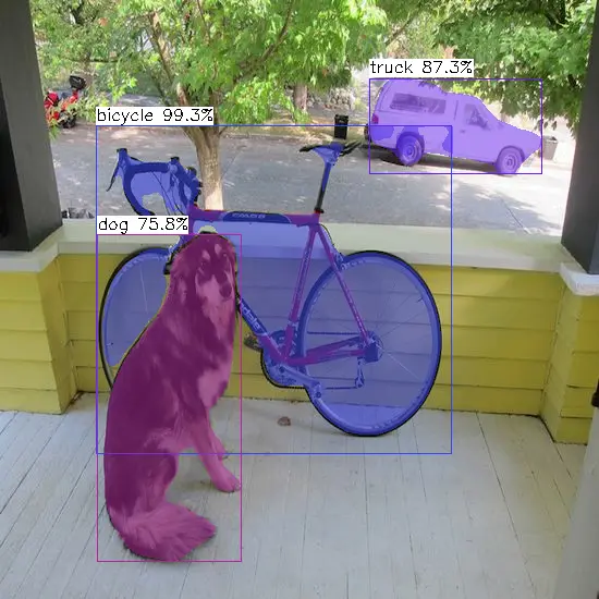

2 = 0.99268 at 88.14 115.14 327.19 x 302.04
8 = 0.87305 at 339.16 71.52 158.58 x 87.82
17 = 0.75830 at 89.21 215.20 132.53 x 301.23
awnn_destroy total: 3.74 ms.
awnn_uninit total: 0.71 ms.
yolact demo result
