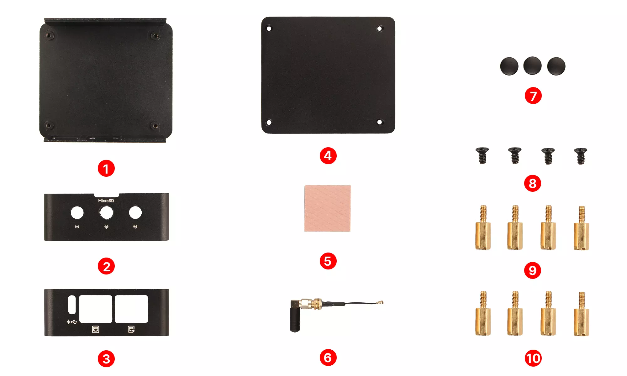

Parts List​
The following parts are needed for installing Cubie A5E with PoE+ HAT:
  • ① : 1x Heatsink
  • ② : 1x Right side cover
  • ③ : 1x Left side cover
  • ④ : 1x Bottom cover
  • ⑤ : 1x Thermal pad
  • ⑥ : 1x Set of rod antennas
  • ⑦ : 3x Antenna hole plugs
  • ⑧ : 4x KM2*4*3.5 mm screws
  • ⑨ : 4x M2*7 mm standoffs (for securing the mainboard with PoE HAT)
  • ⑩ : 4x M2*8 mm standoffs (for securing the PoE HAT)

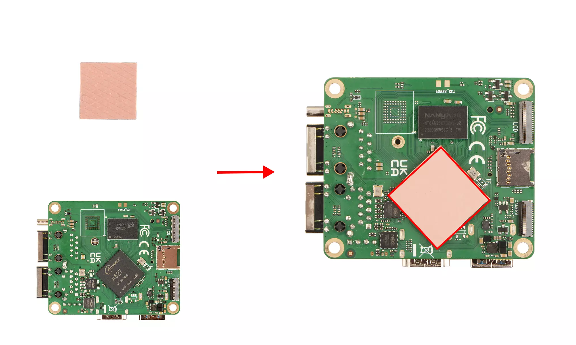

Step 1: Install Thermal Pad​

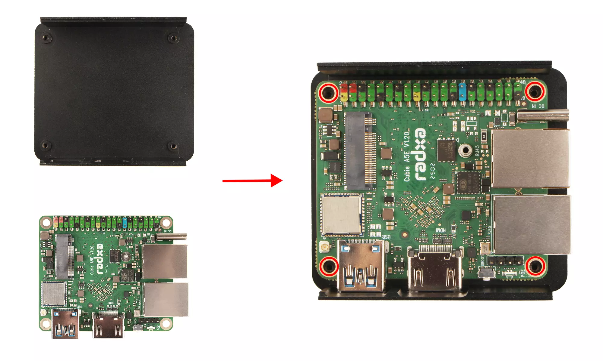

  • Apply the thermal pad to the back of the mainboard at the SoC location
Step 2: Place the Mainboard​
  • Align the heatsink so that its side cutouts match the board's ports (USB, HDMI, etc. should be exposed)
  • Gently place the mainboard onto the four raised positioning posts of the heatsink

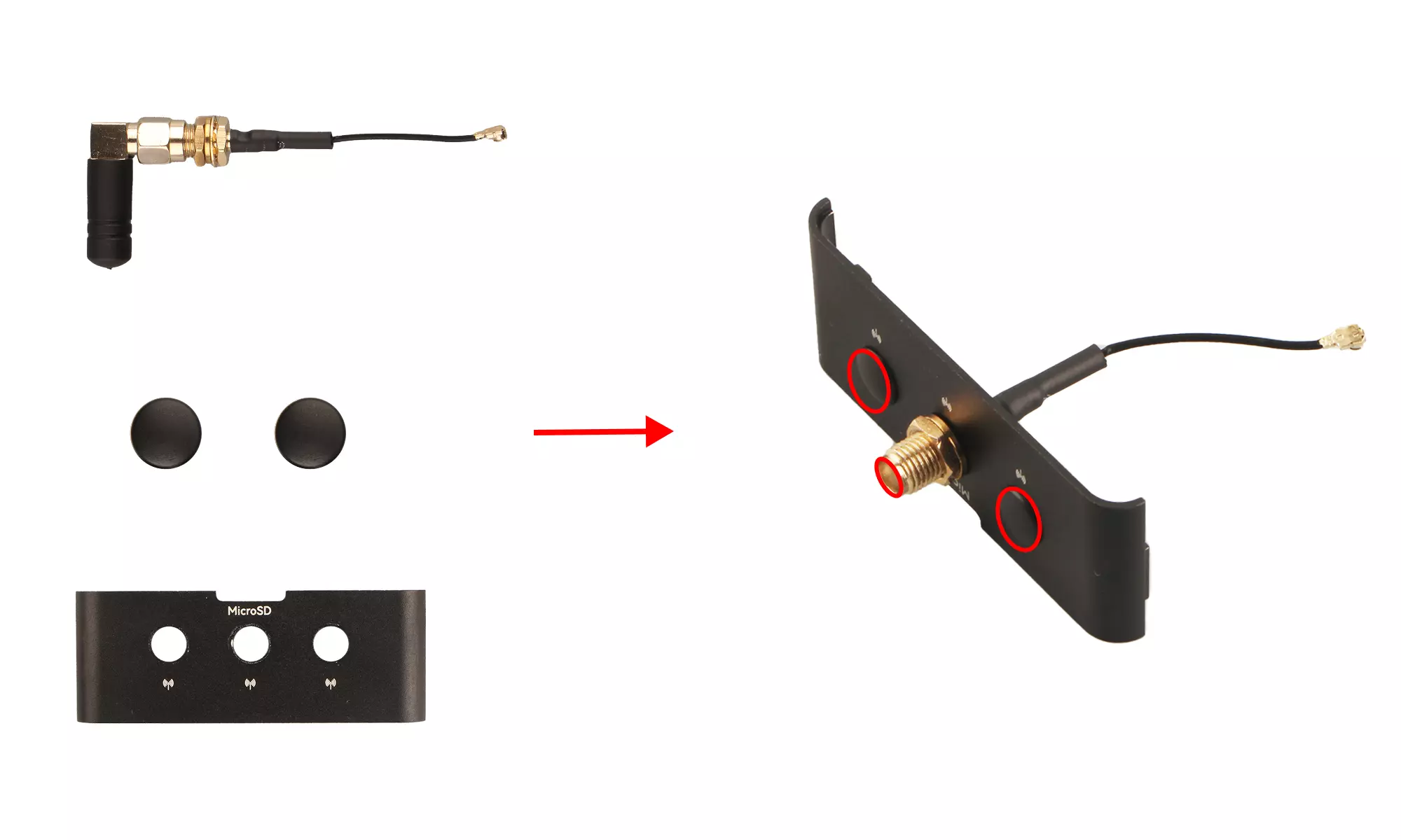

Step 3: Install Antennas​
  • Attach the antennas to the left side cover (do not install the antenna rods yet)
  • Use the antenna hole plugs to cover any unused antenna holes to prevent dust and debris from entering

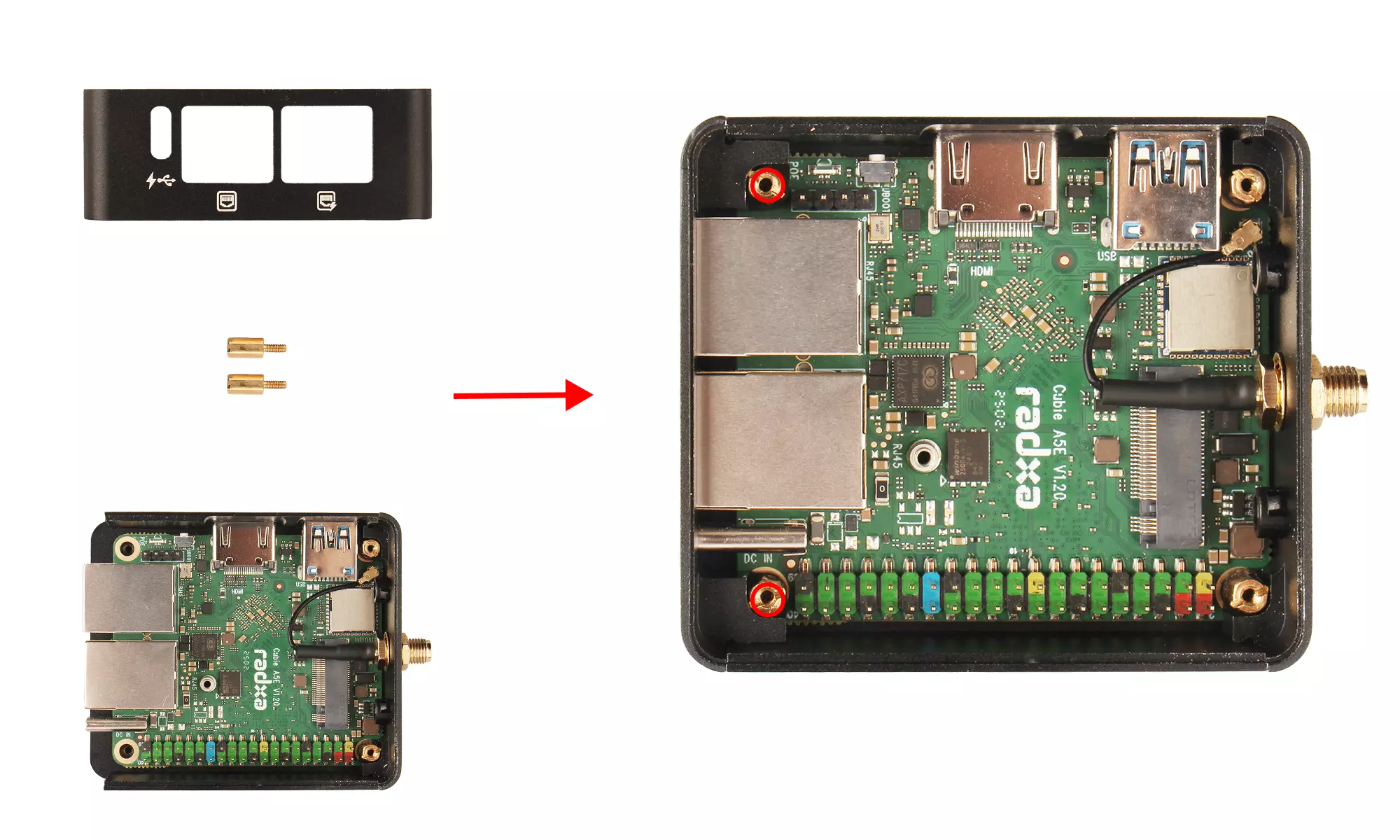

Step 4: Secure the Right Side Cover​
  • Align the antenna IPEX connectors vertically with the WiFi module interface on the mainboard and press down until you hear a "click"
  • Align the holes on the right side cover with the positioning holes on the heatsink
  • Use a flathead screwdriver to tighten the 2x M2*7 mm standoffs to secure the right side cover
Step 5: Secure the Left Side Cover​
  • Align the holes on the left side cover with the positioning holes on the heatsink
  • Use a flathead screwdriver to tighten the 2x M2*7 mm standoffs to secure the left side cover

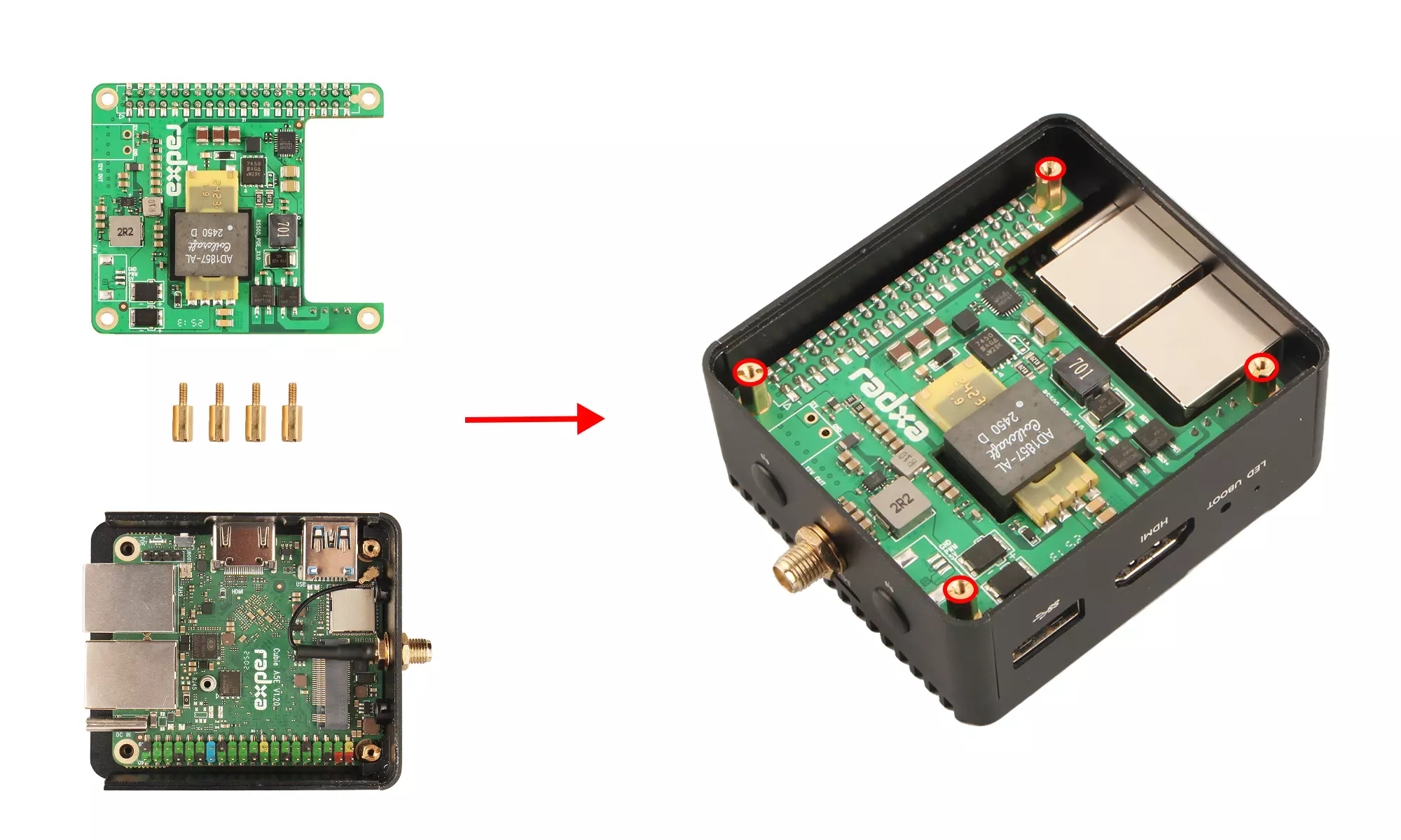

Step 6: Install PoE HAT​
  • Align the PoE HAT with the 40-pin header and PoE Header pins for installation
  • Use a cross-head screwdriver to tighten the 4x M2*8 mm standoffs in a diagonal sequence to secure the PoE HAT

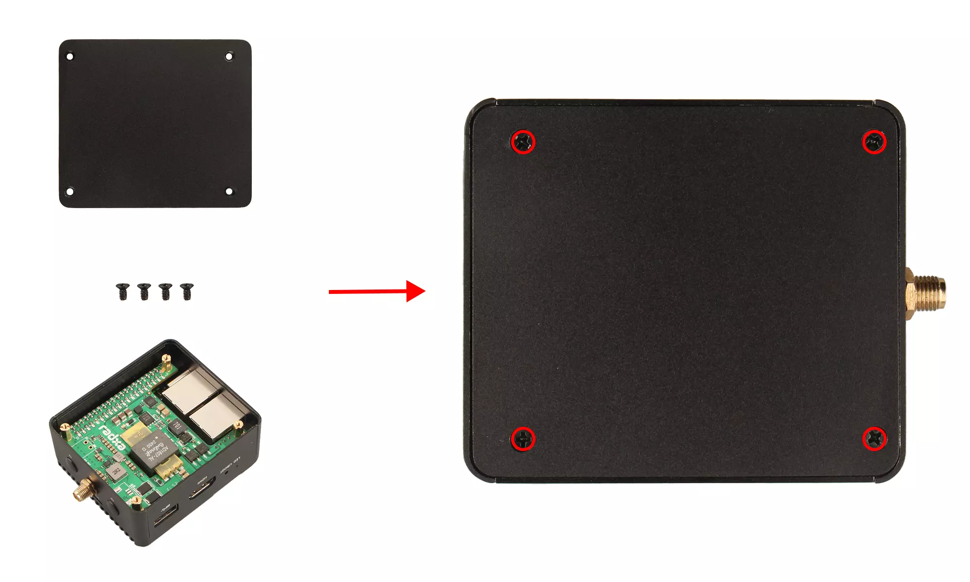

Step 7: Install the Bottom Cover​
  • Align the holes on the bottom cover with the standoffs
  • Use a cross-head screwdriver to tighten the 4x KM2*4*3.5 mm screws in a diagonal sequence to secure the bottom cover

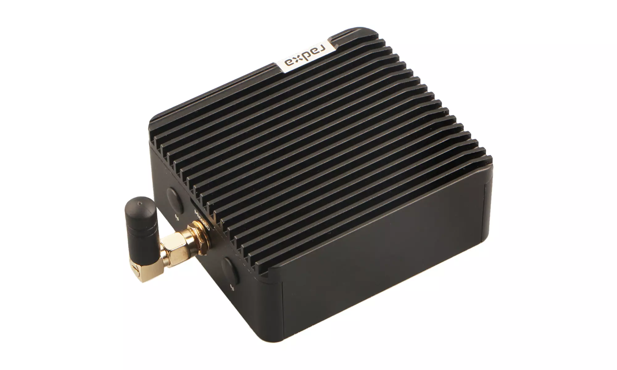

Step 8: Install Antenna Rods​
  • Rotate the antenna rod nuts to secure them in place
