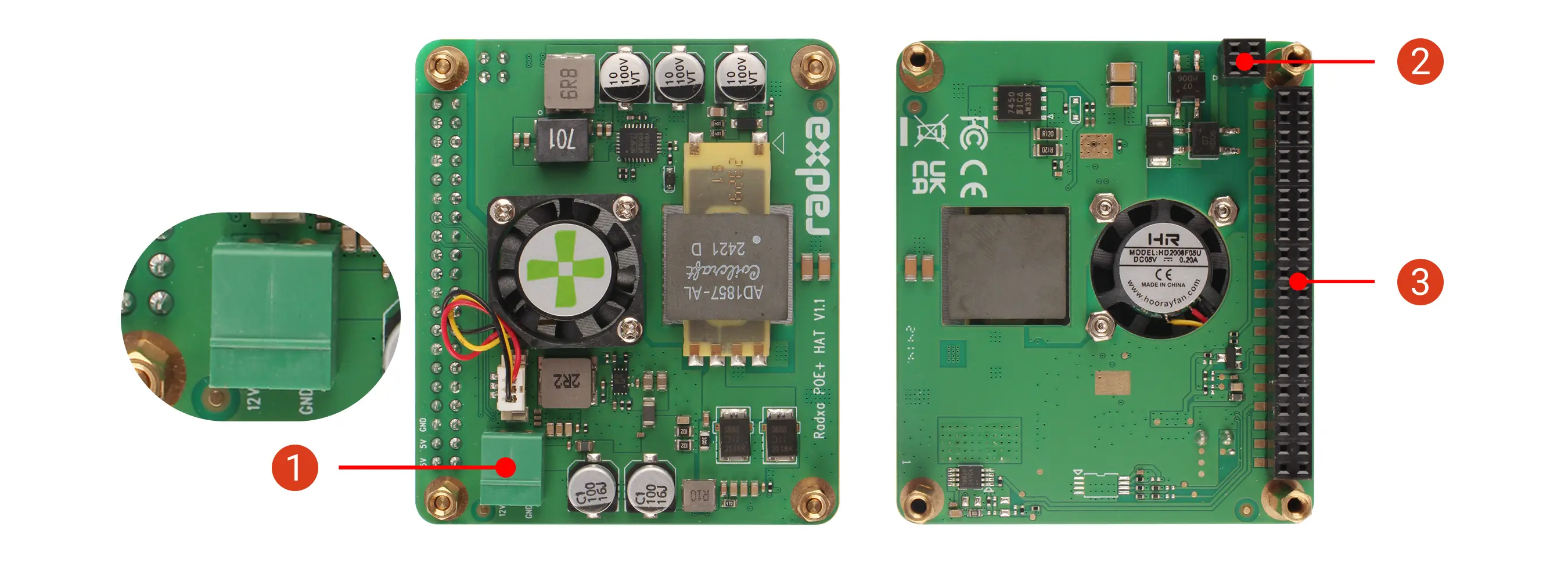

Interface​
  • ①: 12V DC Output
    • 1x 2-Pin 3.5mm Plug-in PCB Terminal Block
  • ②: PoE Header
  • ③: 40-Pin GPIO Header

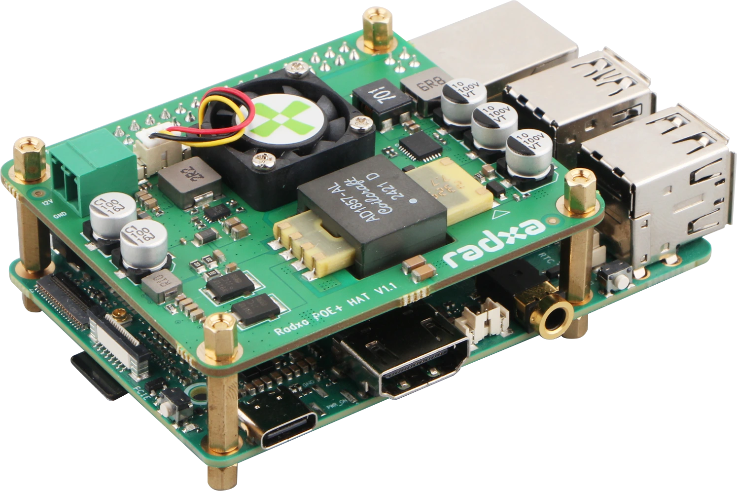

  1. AccessPass four M2.5 x 4 Copper Pillars through the four positioning holes of Radxa SBCs, and individually secure them to M2.5 x 9 Copper Pillars to ensure a sturdy fixation.
25W PoE copper pillars on-board
  1. Align the Radxa 25W PoE+ HAT with the PoE interface and the 40-Pin interface, and insert it carefully, ensuring that it passes through the four M2.5 x 9 Copper Pillars.
25W PoE connected
  1. On top of the Radxa 25W PoE+ HAT, align the four M2.5 x 4 Copper Pillars with the four M2.5 x 9 Copper Pillars, then secure them by rotating them into place. The following is the Illustrated Outcome:
25W PoE 5A
