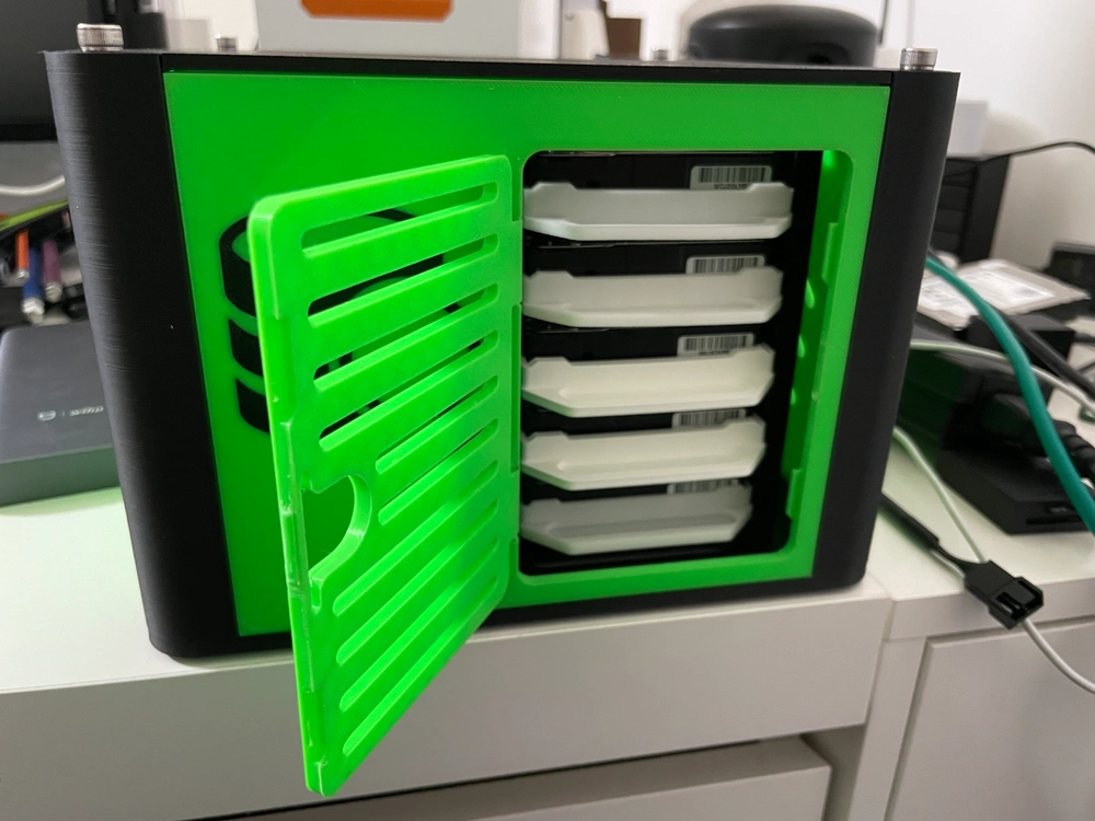

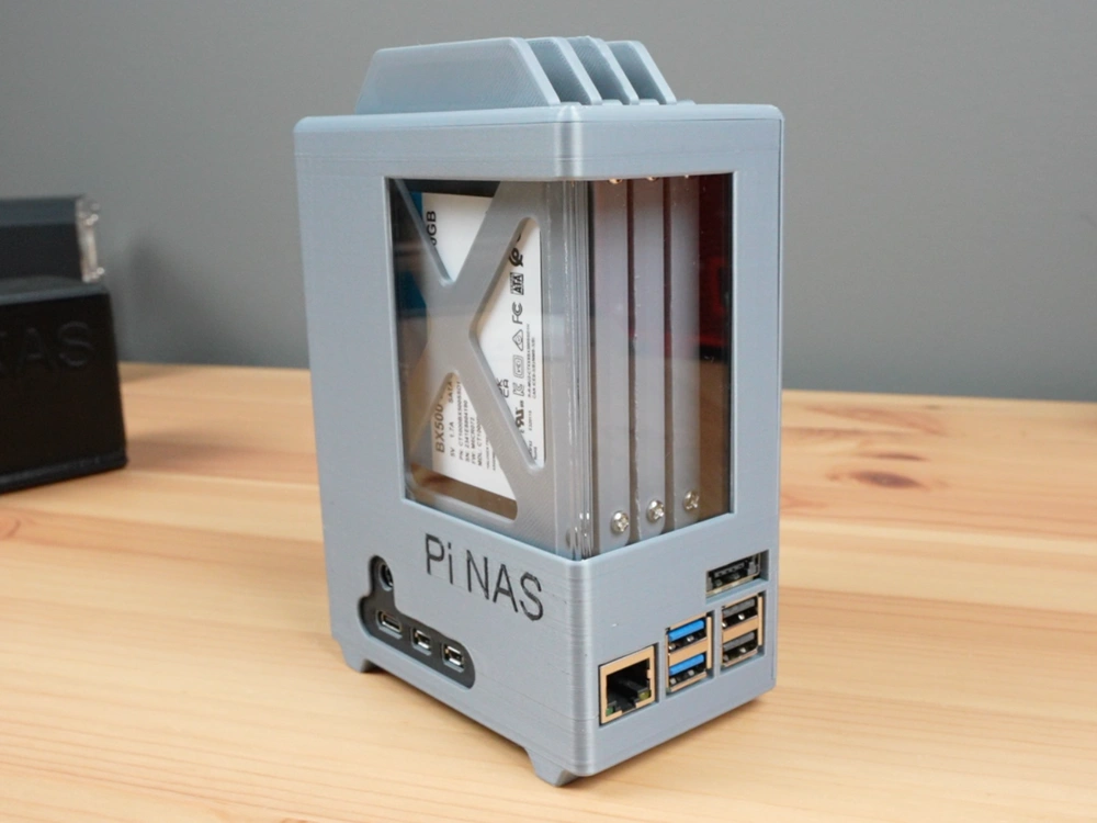

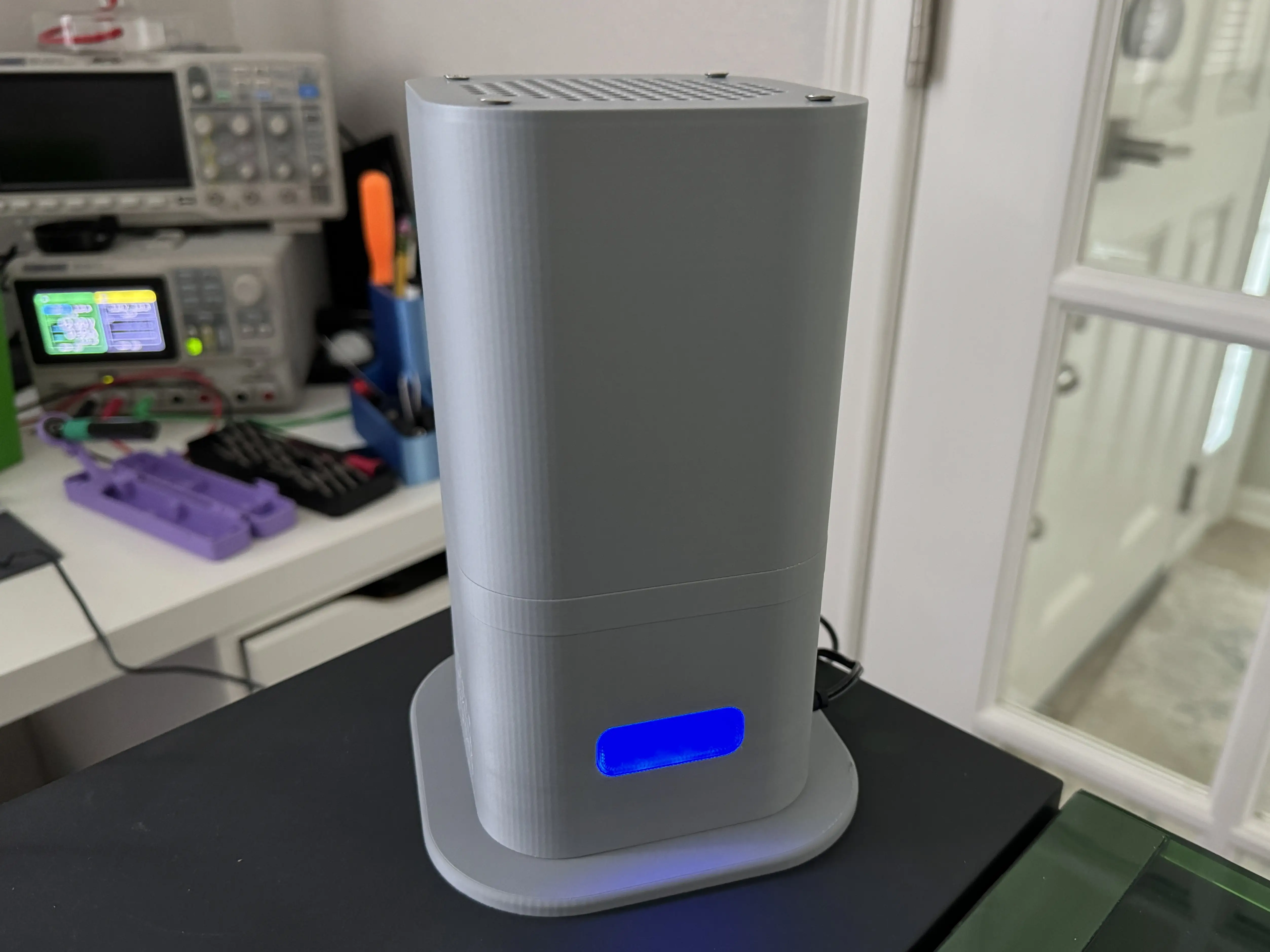

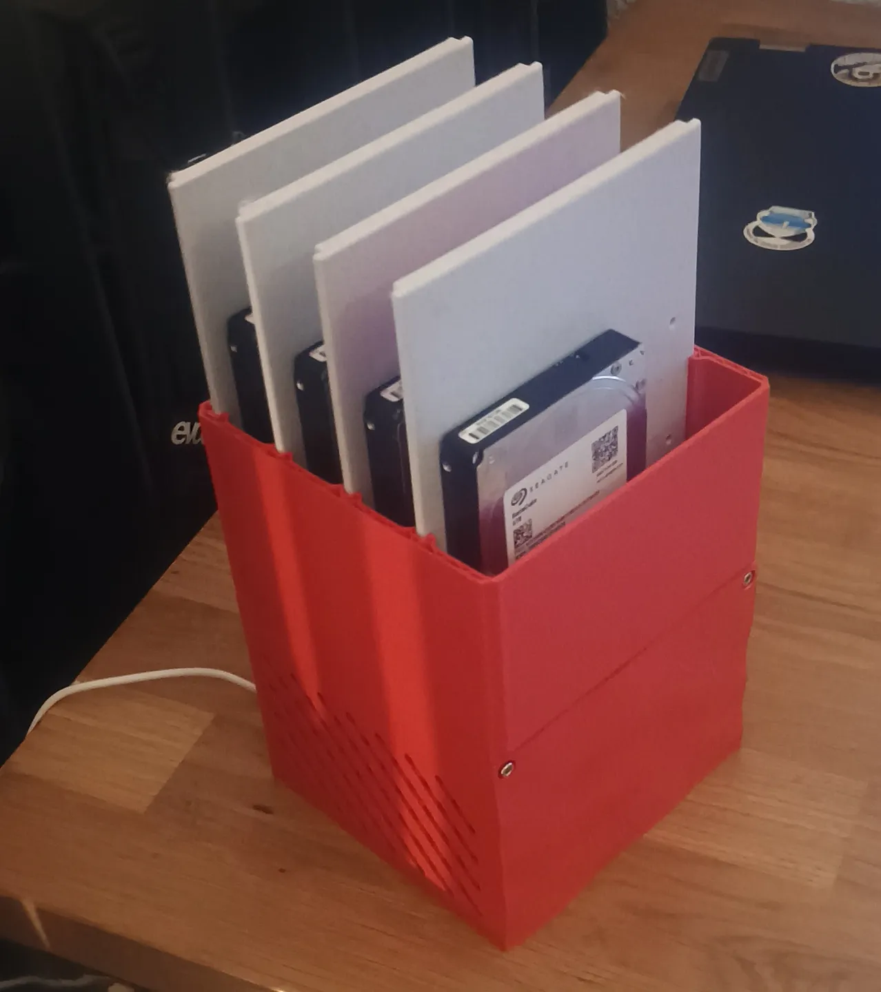

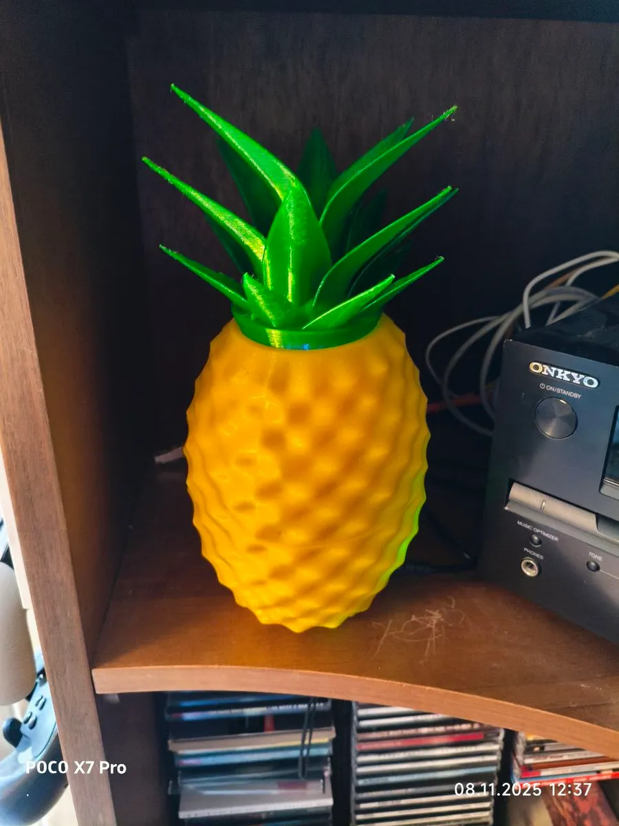

We have not yet produced the corresponding case for sale. But we and the community users have provided some very nice 3D printed cases, you can try to print these cases:
Case namePreviewDownload linkAuthorNote
Radxa Penta NAScase-1GrabCADRadxa ComputerSupports installation of Top board
Issue discussion: Raspberry Pi 3D print penta hat case quirks
Pi 5 Four Bay NAScase-2MakerWorldMichael KlementsVideo: I Built A 4-Bay NAS Using A Raspberry Pi 5
Pi 5 NAS TOWERcase-3Cults 3DCeIIyNoctua 8CM fan, excellent heat dissipation
Pi 5 NAS BOXcase-4MakerWorldWikiZellHard disk is easy to plug and play
Radxa Penta Casecase-5PrintablesPatrick Friedel8CM fan, excellent heat
Pi 5 NAS 2.5" 3.5"case-6PrintablesWhyzardSimple casing, supporting 2.5/3.5-inch hard drives
AnaNAS (PiNASpple)case-7PrintablesIngo HA big pineapple 🍍
