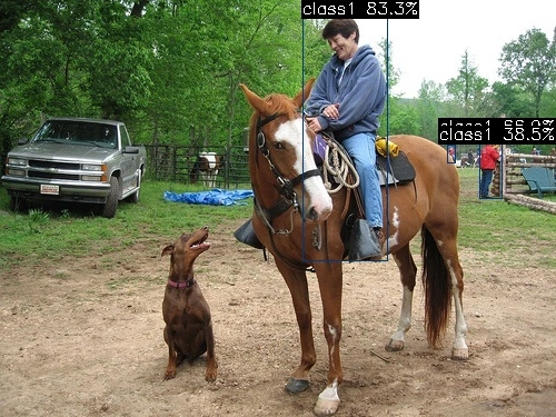

yolo_world_v2 demo output
If your board IP address is 192.168.1.100, open your browser and visit: http://192.168.1.100:7860.
