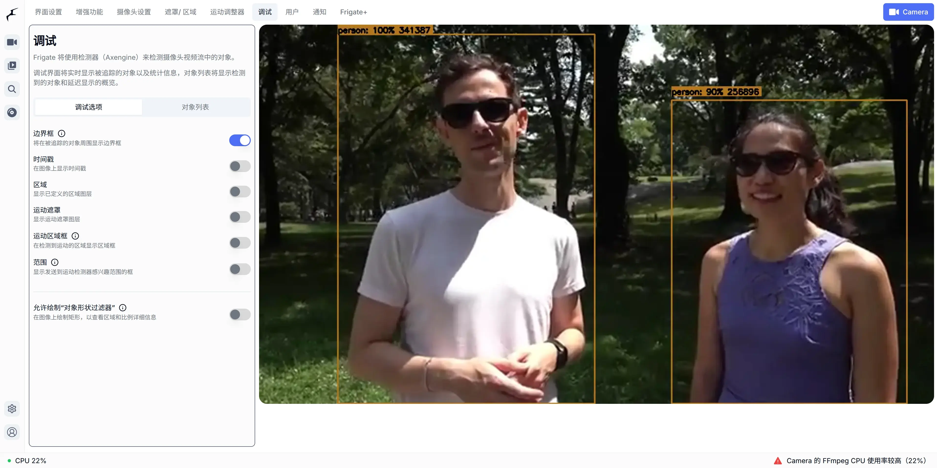

In the web UI, click Settings -> Config Editor, then update the configuration as follows:
mqtt:
enabled: false
cameras:
camera: # <--- Replace with your camera name. Only letters, numbers, underscores, and hyphens are supported.
enabled: true
ffmpeg:
inputs:
- path: rtsp://192.168.2.245:8554/mystream # <--- Replace with your camera RTSP URL
roles:
- detect
detectors:
axengine:
type: axengine
model:
path: yolov5s_320
width: 320
height: 320
input_pixel_format: bgr
labelmap_path: /labelmap/coco-80.txt
detect:
enabled: true
version: 0.16-0
Restart Frigate:
You have now successfully deployed Frigate on Rock5b+ using AX-M1 for inference.
