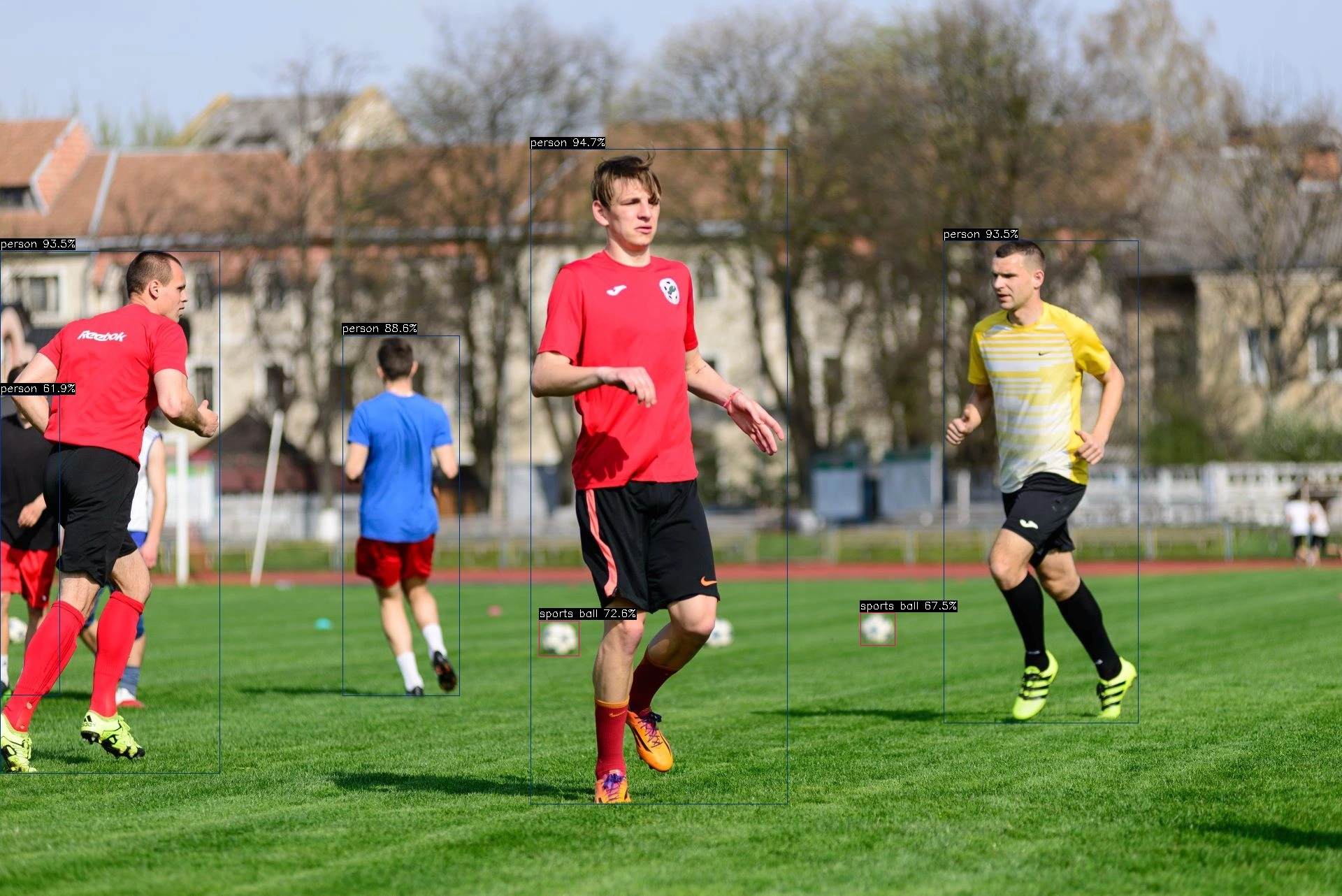

detection num: 7
0: 95%, [ 759, 213, 1126, 1152], person
0: 94%, [ 0, 359, 315, 1107], person
0: 94%, [1350, 344, 1629, 1036], person
0: 89%, [ 490, 480, 658, 996], person
32: 73%, [ 771, 888, 830, 939], sports ball
32: 67%, [1231, 876, 1280, 924], sports ball
0: 62%, [ 0, 565, 86, 995], person
YOLOv11 demo output
