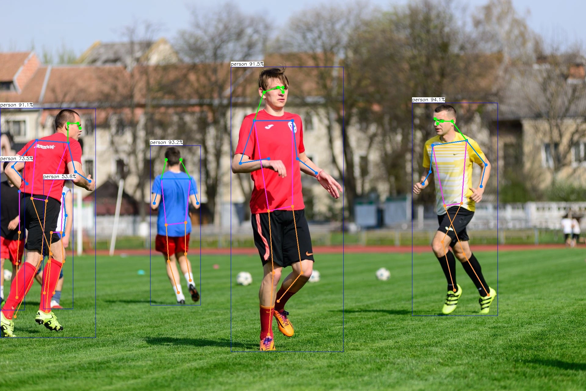

./axcl_aarch64/axcl_yolo11_pose -m ax650/yolo11x-pose.axmodel -i football.jpg

detection num: 6
0: 94%, [1350, 337, 1632, 1036], person
0: 93%, [ 492, 477, 658, 1000], person
0: 92%, [ 756, 219, 1126, 1154], person
0: 91%, [ 0, 354, 314, 1108], person
0: 73%, [ 0, 530, 81, 1017], person
0: 54%, [ 142, 589, 239, 1013], person
yolov11-pose demo output
