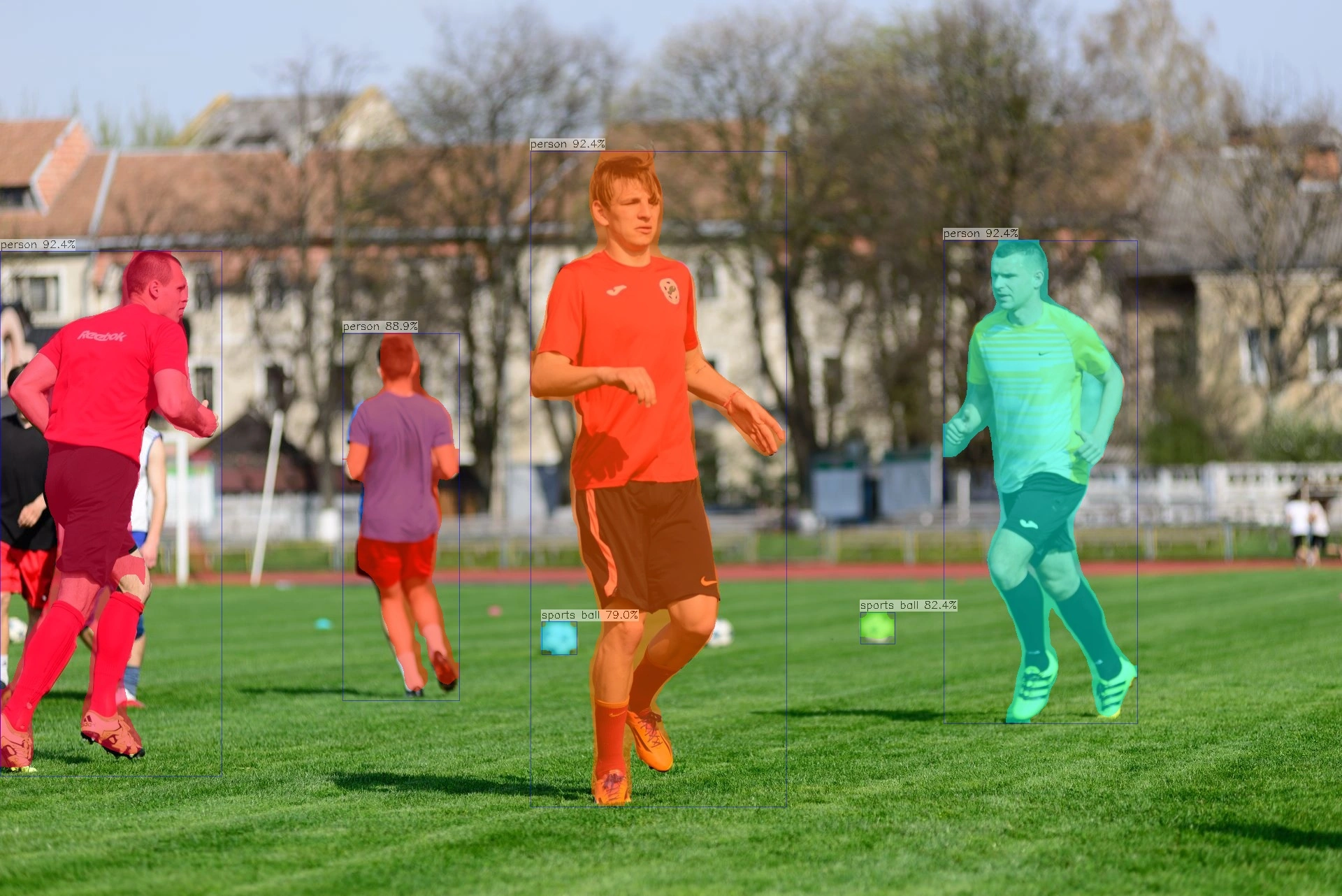

detection num: 6
0: 92%, [ 0, 359, 318, 1111], person
0: 92%, [1350, 344, 1628, 1036], person
0: 92%, [ 759, 216, 1126, 1155], person
0: 89%, [ 490, 477, 658, 1003], person
32: 82%, [1231, 876, 1281, 922], sports ball
32: 79%, [ 775, 889, 826, 937], sports ball
yolov11-seg demo output
