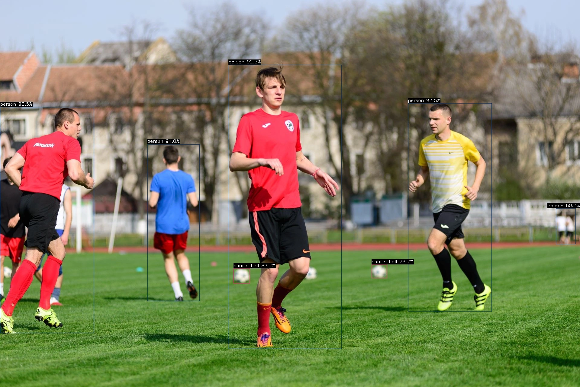

[INFO] Compiler version: 6.0-dirty a498e20d-dirty
yolov8 demo output
