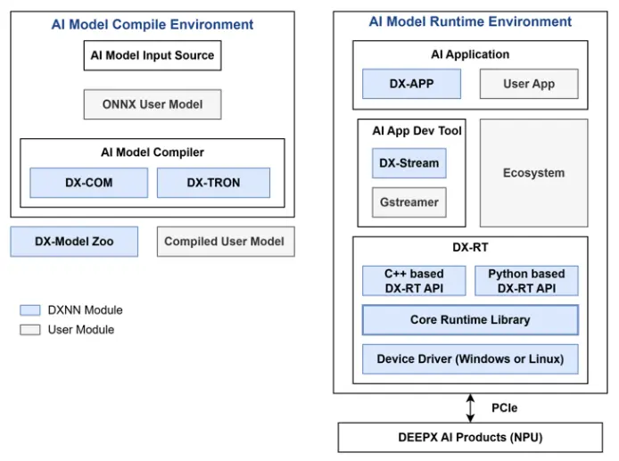

The DX-M1 / DX-M1M SDK is a software development kit for optimizing AI models and efficiently deploying them on Radxa AIcore DX-M1 / DX-M1M accelerator cards. With the DX-M1 / DX-M1M SDK, you can port models from mainstream AI frameworks (PyTorch, ONNX, TensorFlow) to Radxa AIcore DX-M1 / DX-M1M, and run hardware-accelerated inference on the DEEPX NPU.
DX-M1 / DX-M1M SDK overview
SDK components​
The DX-M1 / DX-M1M SDK consists of two parts: model compilation and model inference.
For DX-M1 / DX-M1M SDK packages, go to the Downloads page or use DX-ALL-SUITE.
Model compilation​
  • DX-COM (model compiler) compiles an ONNX model file along with a configuration file into the DXNN model format that can be executed on the NPU.
Model inference​
  • DXRT-NPU-Driver (driver) provides driver support for AIcore DX-M1 / DX-M1M.
  • DX-RT (runtime) is the runtime used to interact with AIcore DX-M1 / DX-M1M NPU hardware. It provides pre-processing and post-processing during inference and manages NPU inputs and outputs.
  • DX-APP (demo application) is a demo application template based on the AIcore DX-M1 / DX-M1M NPU.
  • DX-STREAM (GStreamer plugin) is a custom GStreamer plugin used to integrate real-time streaming data into applications based on the DEEPX NPU.
DX-ALL-SUITE​
DX-ALL-SUITE is an integration repository for the DEEPX SDK, which helps you install and use the DEEPX SDK more conveniently.
