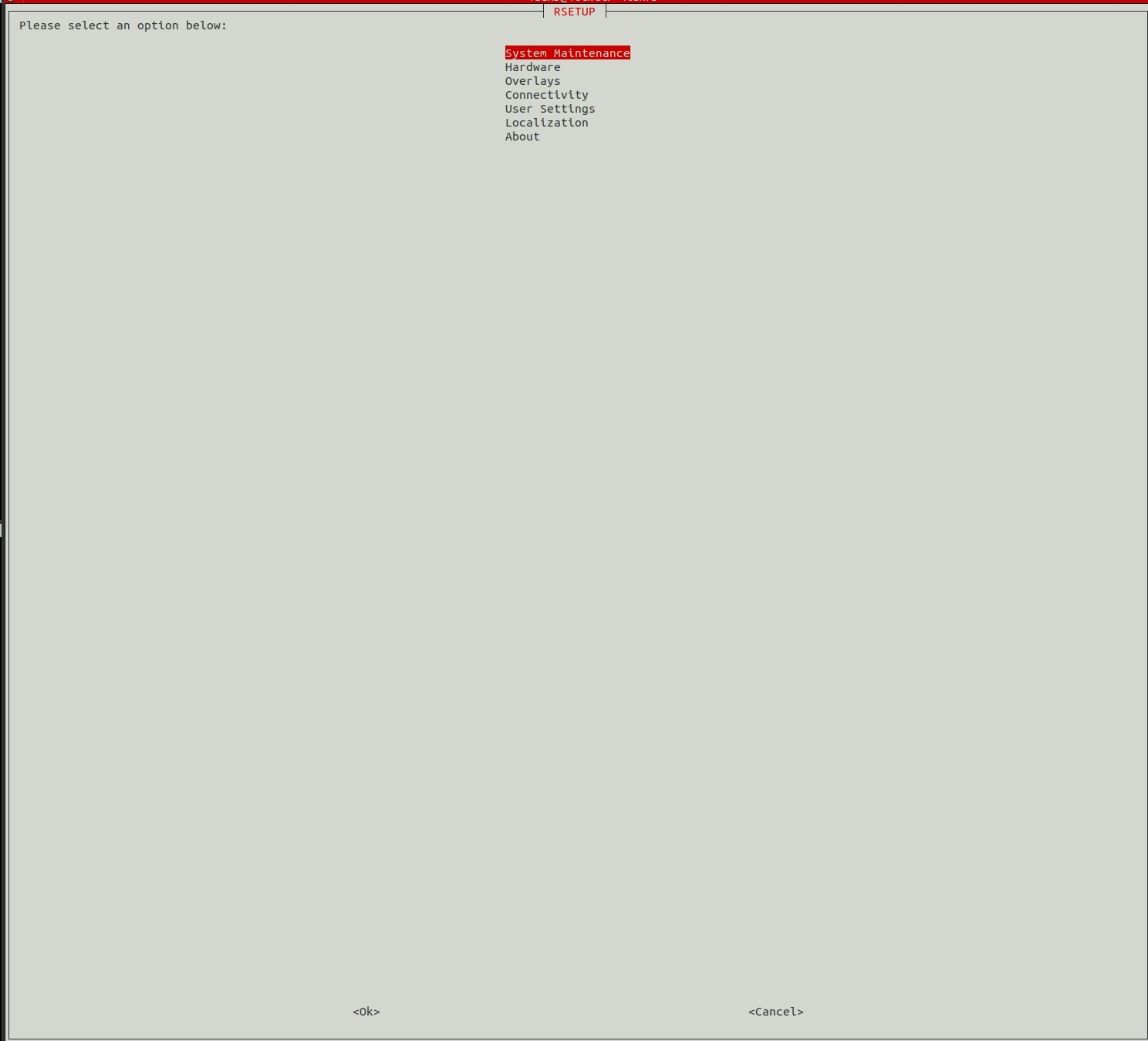

Using System Tool rsetup to Flash SPI
Select the System Maintenance option:

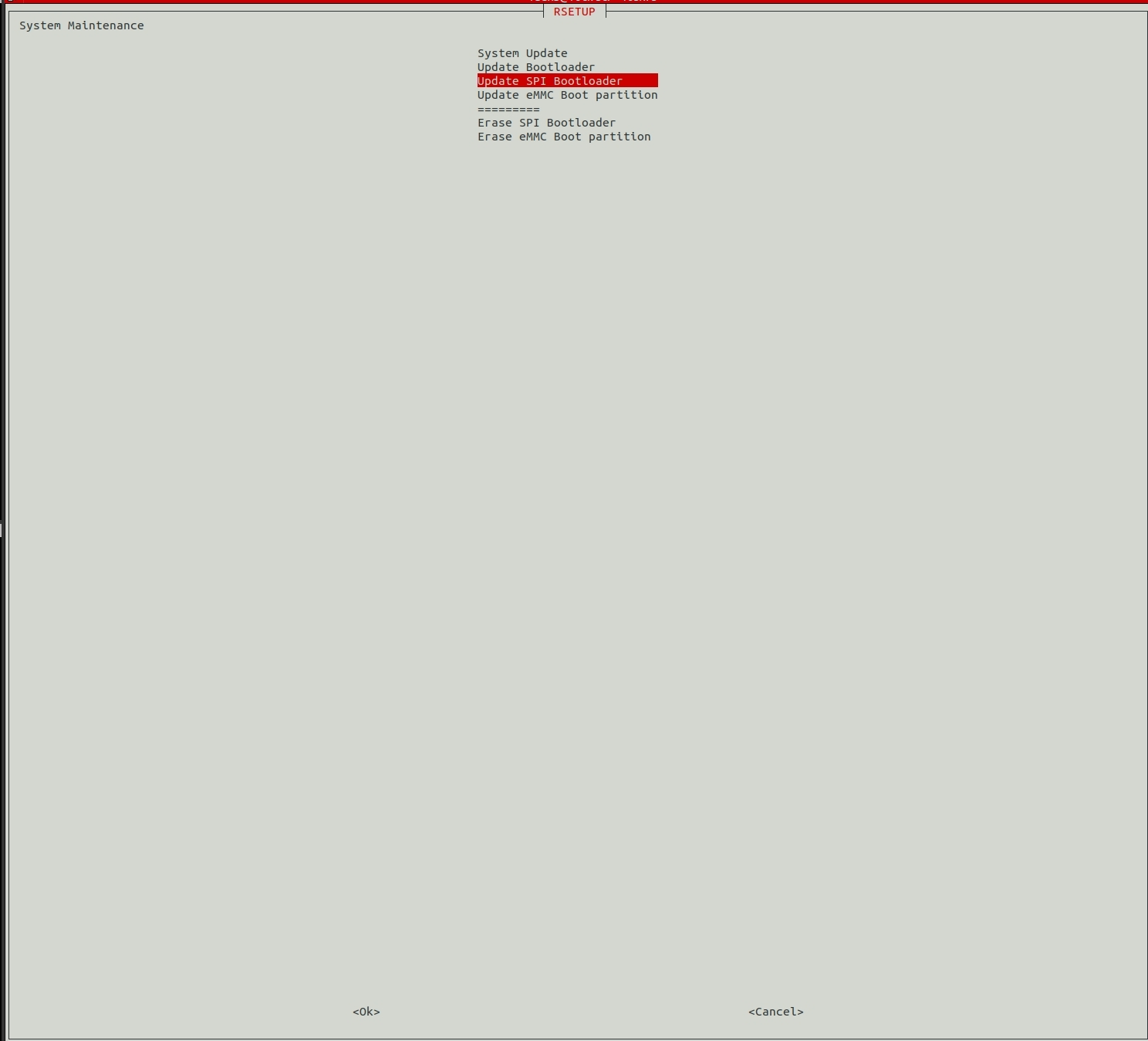

Select the Update SPI Bootloader option:
update spi bootloader

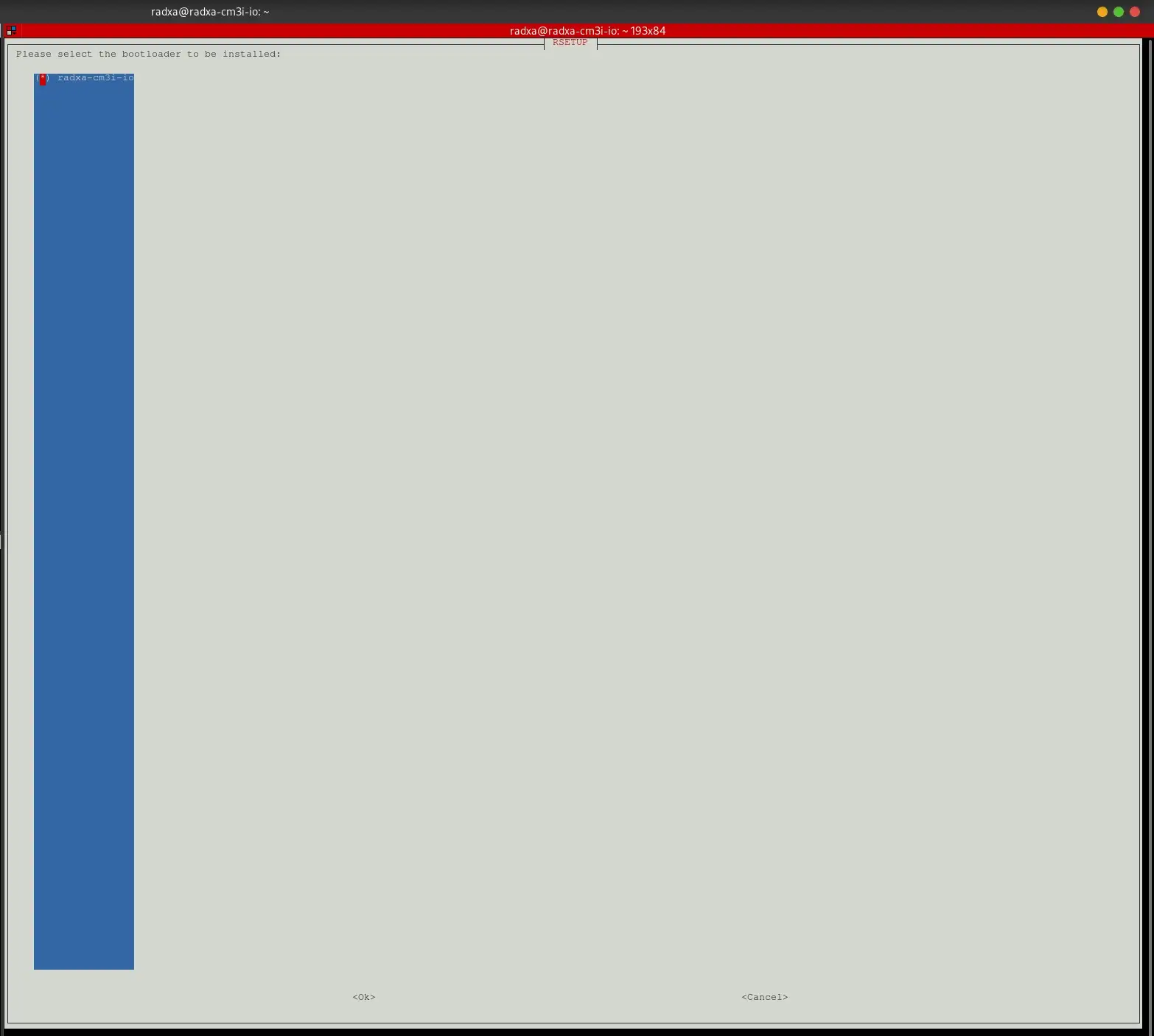

Select the bootloader option from the menu, then follow the prompts to update the SPI Flash:
radxa-cm3i-io

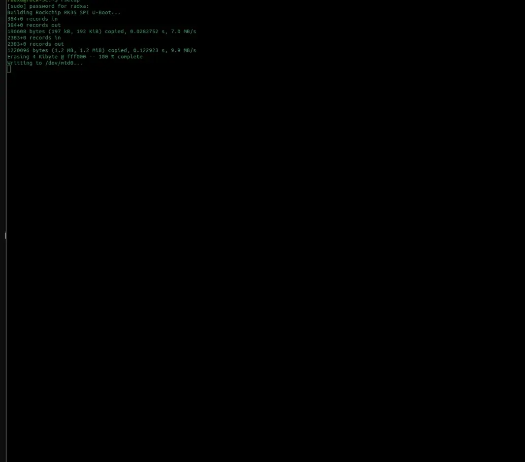

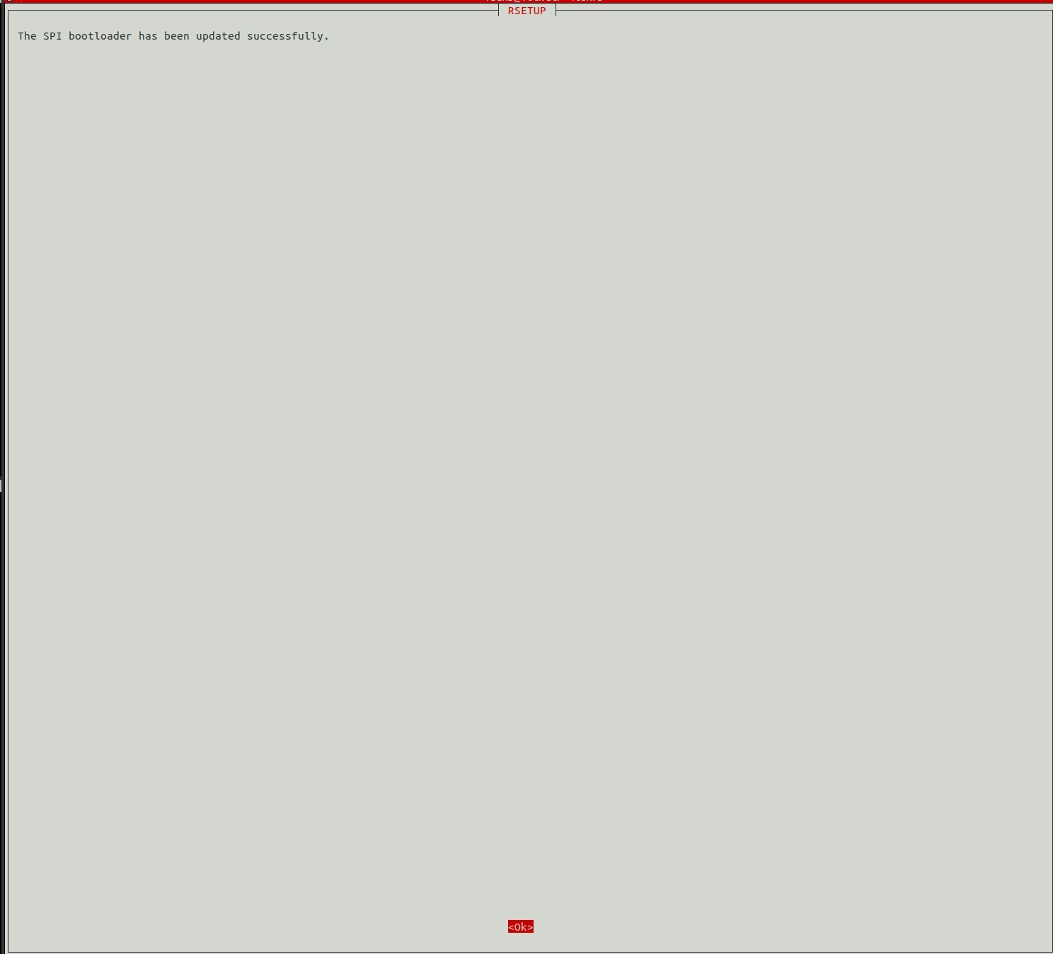

Wait for the update to complete.
writing to mtd success
