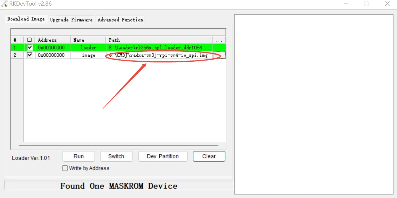

Operation on the PC
On the PC side, you need to flash the Bootloader to the SPI Flash via USB. This process also requires entering Maskrom mode and using the RKdevtools tool for flashing.
The steps to enter Maskrom mode are similar to those for Installing the System to eMMC, with the following modifications:
  • When powering on, you need to press the SPI Flash Button.
    spi flash
  • In the RKdevtools tool, change the "image" option to use the SPI Image from the Resource Download Summary.
    spi flash
