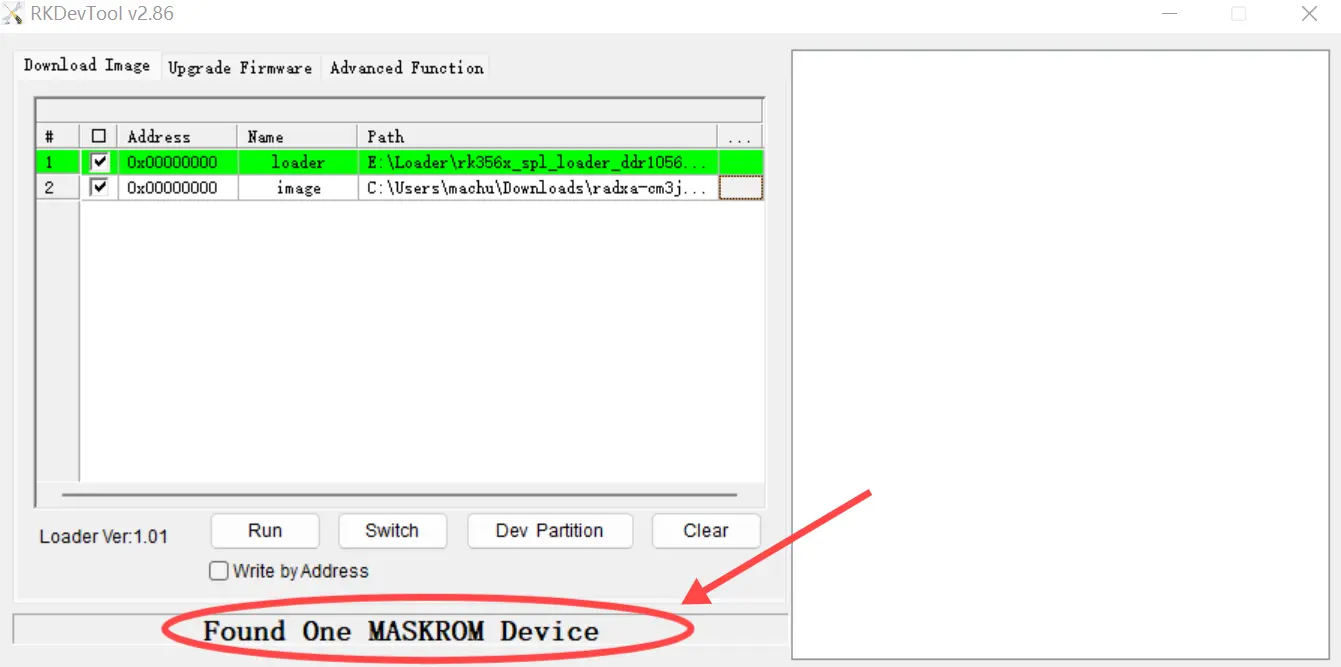

Open the RKDevTool, and you will see that the device is in the "Found One MASKROM Device" state.

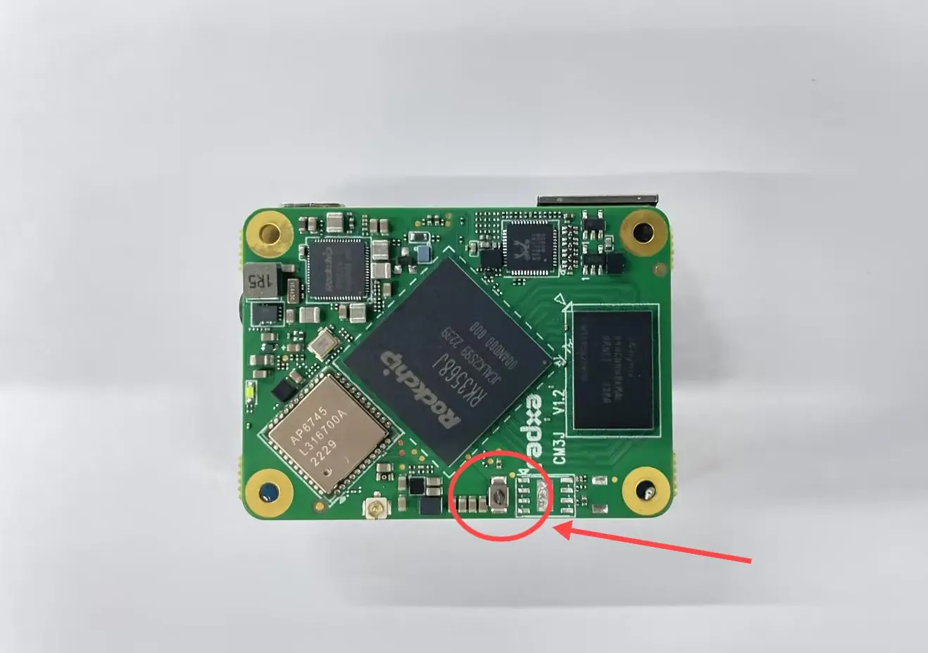

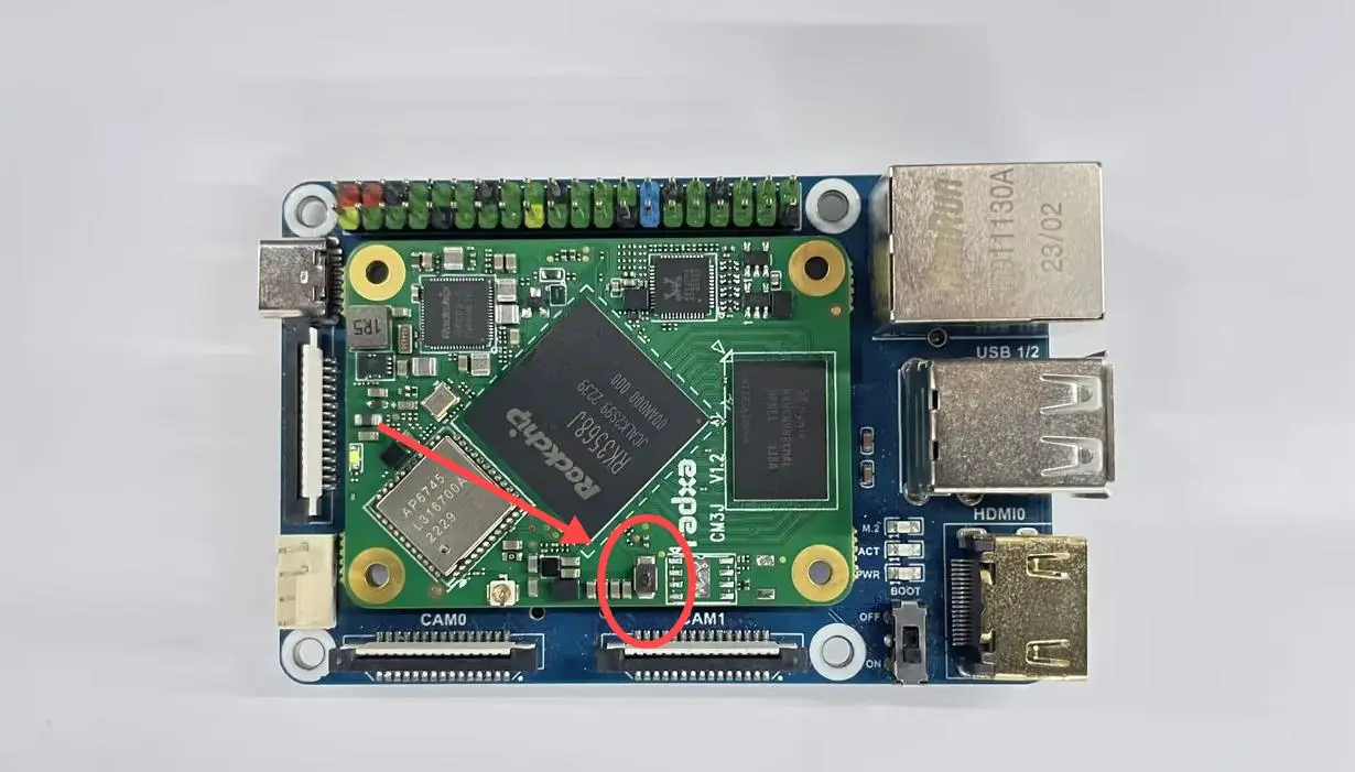

How to enter Maskrom mode

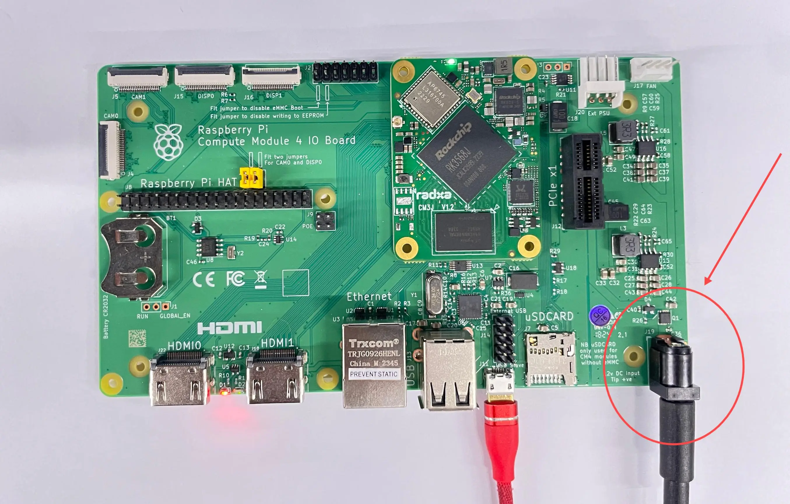

- Raspberry Pi CM4 IO Board

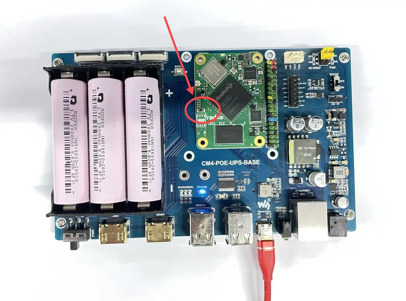

- WaveShare CM4-POE-UPS-BASE

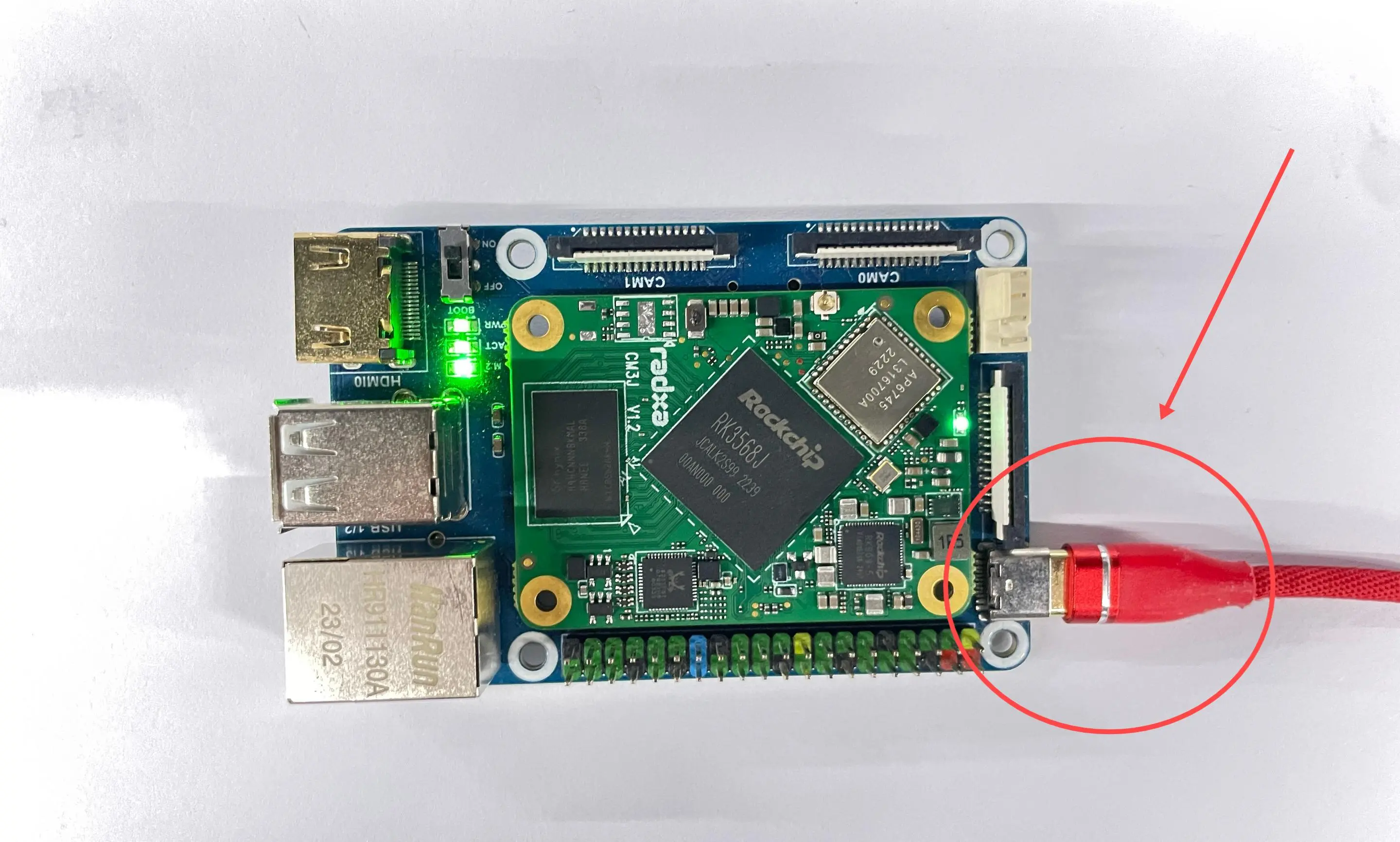

- WaveShare CM4-IO-BASE-B

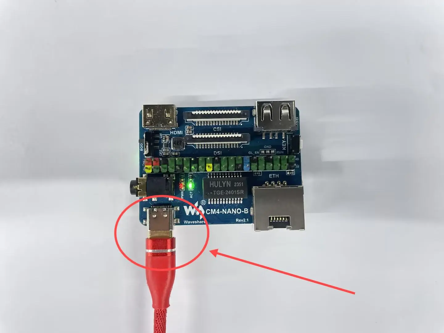

- WaveShare CM4-NANO-B
Prepare a USB-A to MicroUSB cable
Insert the USB-A to MicroUSB cable into the OTG port (Micro USB port) of the Raspberry Pi Compute Module 4 IO Board, and plug the other end into the computer.
- Then press and hold the eMMC Button (if this is the first time flashing, the button does not need to be pressed).
- Power on.
- At this point, under normal circumstances, it will enter Maskrom mode, and the RKdevTool will detect a Maskrom device.

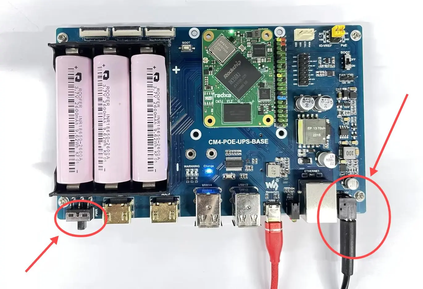

Prepare a USB-A to USB-C cable.
Insert the USB-A to USB-C cable into the USB Type-C port of the WaveShare CM4-POE-UPS-BASE board, and plug the other end into the computer.
- Set the BOOT DIP switch on the board to the ON position.
- Power on, then switch the switch at the position shown in the image to the ON position.
First, set the BOOT DIP switch on the board to the ON position.
- Insert the USB-A to USB-C cable into the USB Type-C port of the WaveShare CM4-IO-BASE-B board, and plug the other end into the computer.

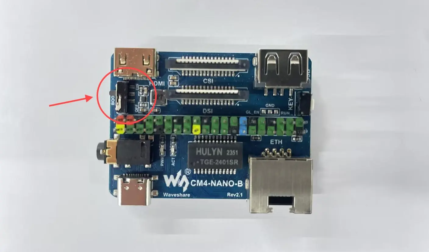

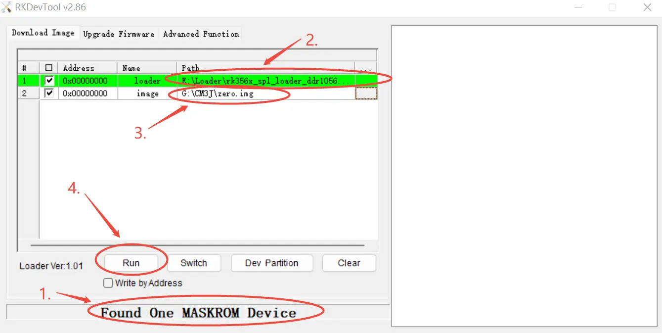

Open the RkDevTool and use it to perform the erasing operation.
Make sure the PC recognizes Maskrom
Download zero.img from Resource Download
Select the Loader (see the Resource Download section)
Change the "image" option to "zero.img"
Click to run
Click to run
