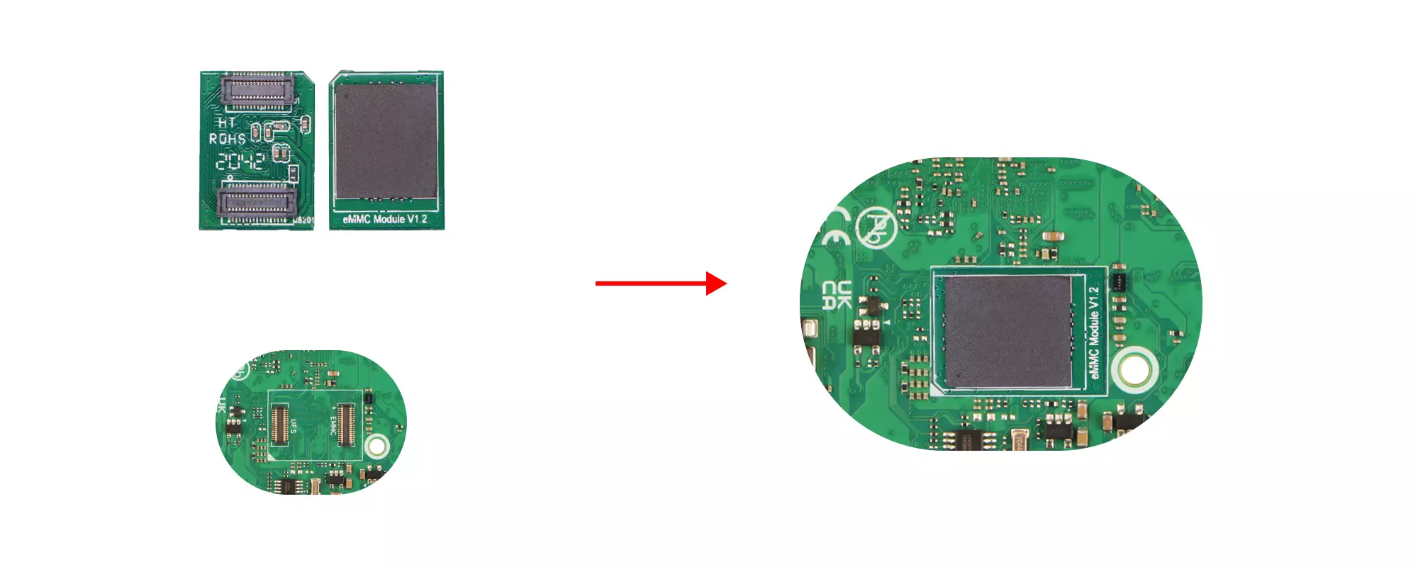

eMMC Module Installation Steps:
- Observe the notch direction on the eMMC module and the notch marking on the motherboard's eMMC module interface to determine the correct installation orientation.
- Place the eMMC module above the motherboard's eMMC module interface, ensuring the eMMC module interface is properly aligned with the motherboard's eMMC module interface.
- Gently press one end of the eMMC module until you hear a "click" sound, then press the other end in the same way to ensure the eMMC module is properly installed.
If your motherboard has onboard eMMC, no installation is required.
