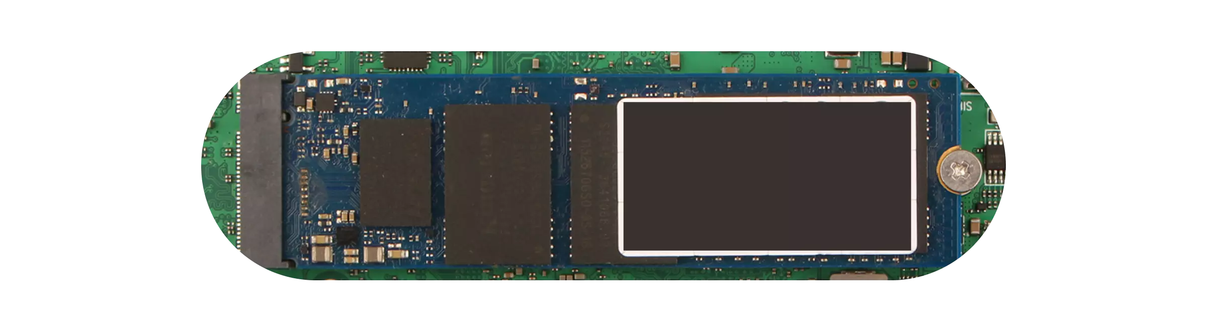

There are two scenarios for installing an NVMe SSD on the motherboard:
- Motherboard has an M.2 M Key interface: You can directly install the NVMe SSD
- Motherboard doesn't have an M.2 M Key interface but has a PCIe FPC interface: You can install the NVMe SSD using a PCIe to M.2 M Key HAT module
- M.2 2280 Interface
- M.2 2230 Interface
- PCIe FPC Interface
Install NVMe SSD through M.2 M Key 2280 interface.
Install NVMe SSD through M.2 M Key 2230 interface.
Install NVMe SSD through PCIe FPC interface with M.2 M Key HAT.
