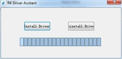

Download and extract the DriverAssistant v5.0 file.
Locate the DriverInstall.exe
file and run it as administrator:
To install drivers: Click the Install Driver
option
To uninstall drivers: Click the Uninstall Driver
option
If you have previously installed other versions of the driver, please uninstall them before installing the new one.
