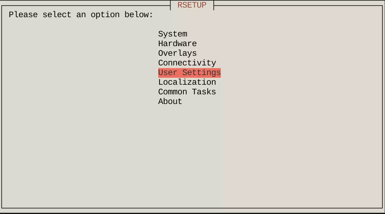

  1. Use the arrow keys to select the User Settings option, then press Enter to confirm.
Rsetup User Settings menu

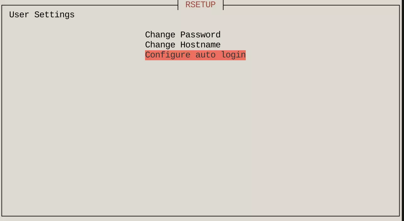

  1. Use the arrow keys to select the Configure auto login option, then press Enter to confirm.

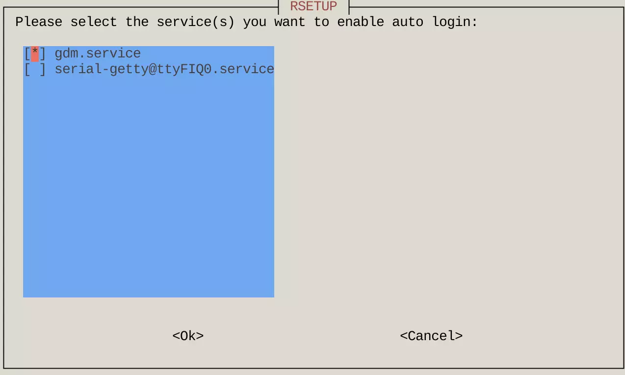

  1. Use the arrow keys to select the Enable auto login option, press Space to check the gdm.service box, then press Enter to confirm.
A * in the checkbox indicates that the option is enabled.
Enable auto login configuration
