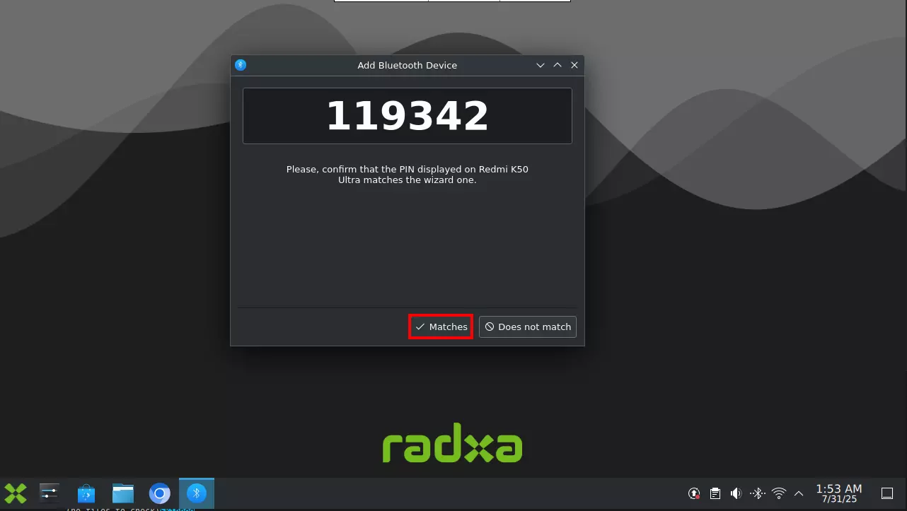

- Pair Bluetooth Device
Select the Matches
option to pair with a Bluetooth device. The device will connect automatically after successful pairing.

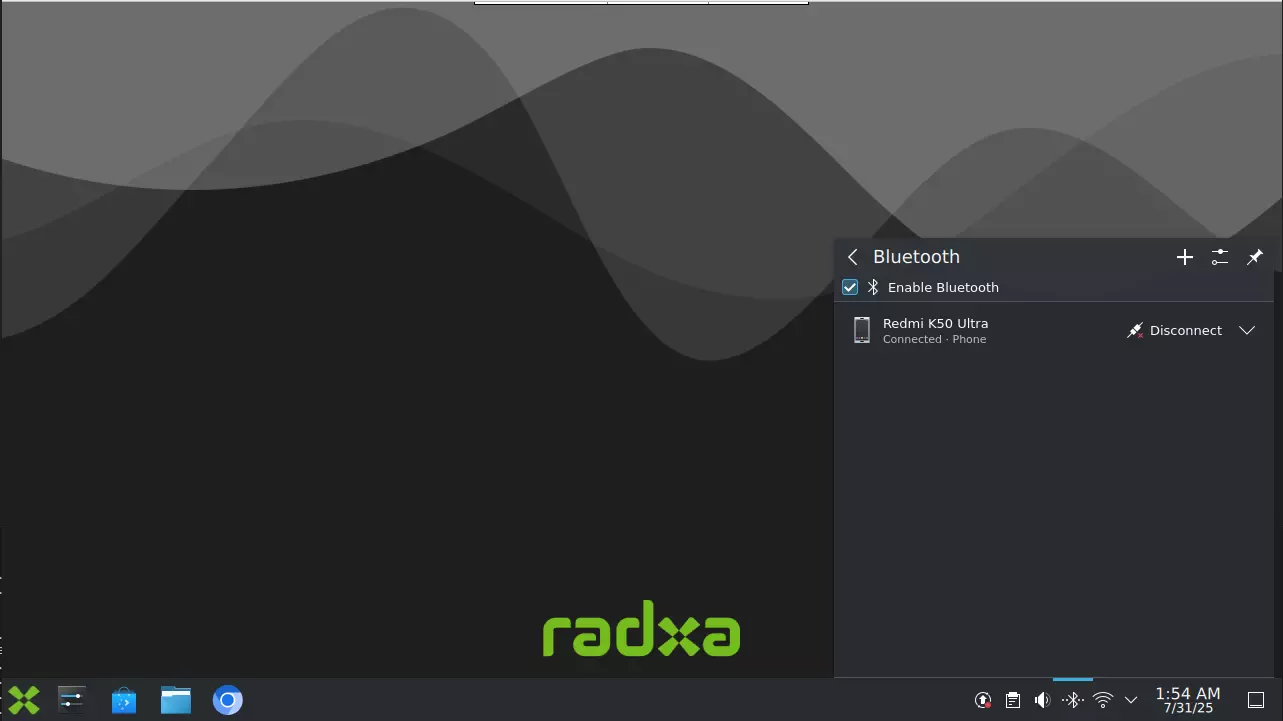

- View Connected Devices
Click the Bluetooth icon to view connected Bluetooth devices.
