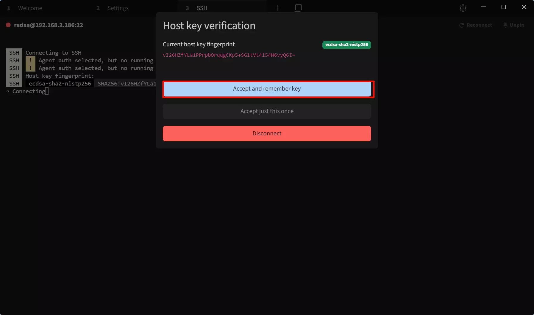

You will be prompted to confirm the connection by typing yes

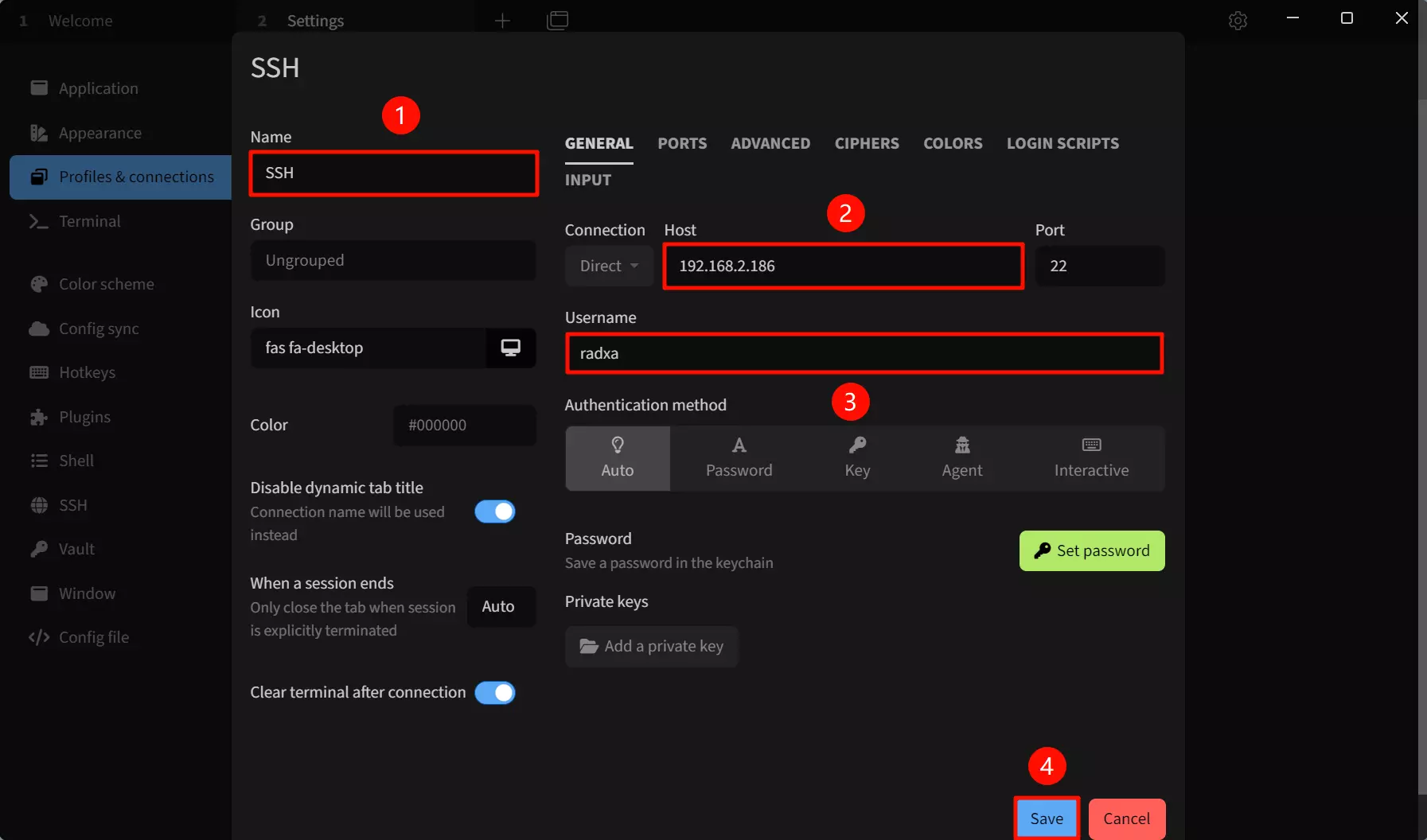

Select SSH Template
Choose a base configuration as a template: Select the SSH connection
template. You can modify parameters such as device name, IP address, and port in the subsequent configuration interface.
After selecting the SSH connection
template, modify the following parameters:
① → Name
: Set the connection name
② → Host
: Enter the IP address of the target device
③ → User
: Set the username (default is radxa
for factory settings)
④ → Save
: Save the configuration
The default port is 22
and typically doesn't need to be changed.

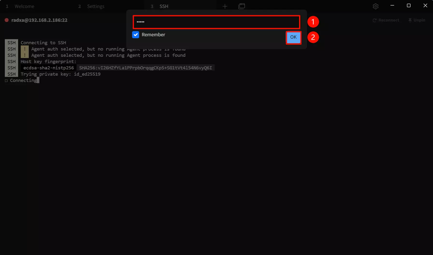

After clicking the run button, Tabby will display a key verification and password input interface.
① → password: Enter the password for the target device
② → OK: Confirm the connection
It's recommended to check the Remember
option so you won't need to enter the password again for future connections.

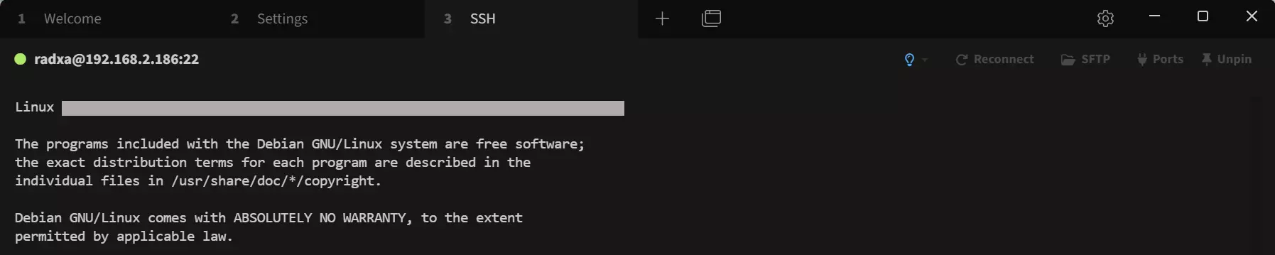

After a successful connection, the remote terminal interface will appear.
Once you've successfully logged in via SSH, you can run commands to control the system through the SSH session.
