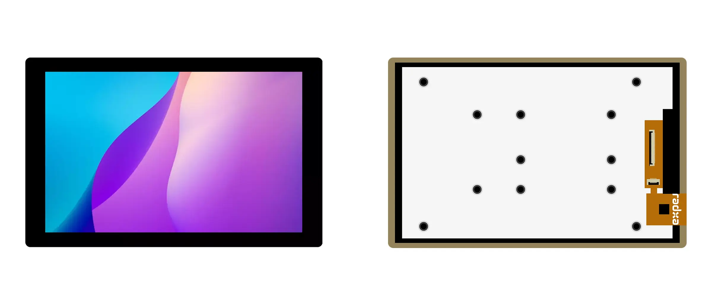

Radxa 8-inch Display
Radxa Cubie A5E's onboard MIPI DSI interface can be used to connect the Radxa 8-inch Display for video output.

The Radxa 8-inch Display interface specifications are as follows:
  • Interface type: 40-Pin 0.5 mm pitch SMD horizontal FPC connector
  • Connection method: Flip-lock, bottom contact

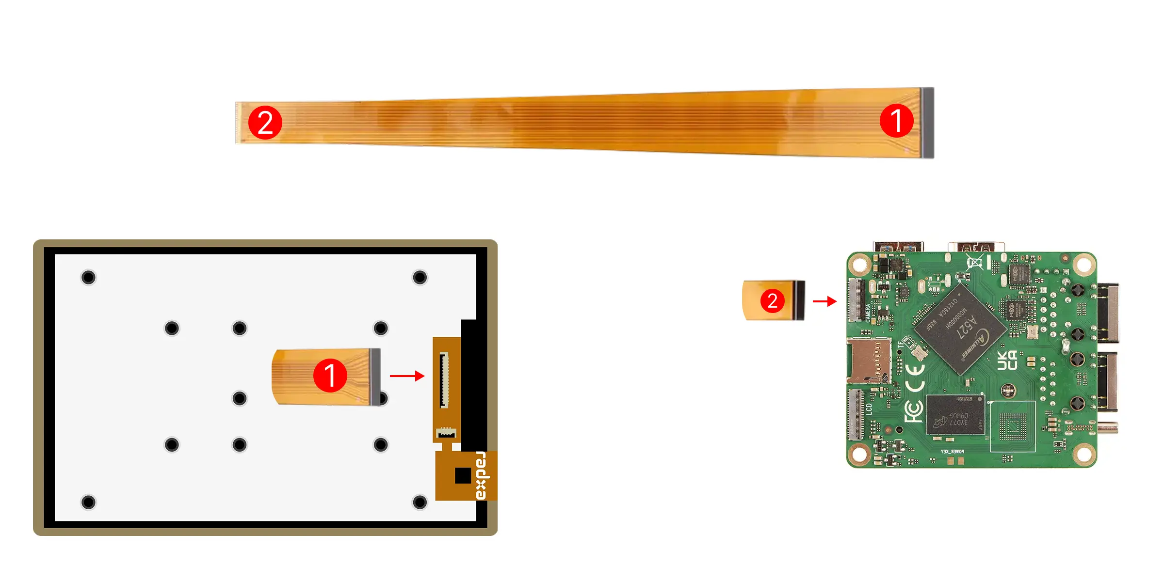

Display FPC Cable​
Uses a 40-Pin 0.5 mm pitch to 39-Pin 0.3mm pitchopposite side FPC cable
Hardware Connection​
Insert the 40-Pin metal contact end of the FPC cable into the display interface, and insert the 39-Pin metal contact end of the FPC cable into the board's MIPI DSI interface.
Precautions
  • Ensure both cable edges are flush with the socket edges, with no skew or partially exposed contacts
  • Confirm the cable has no creases, is not loose, and the lock is in the closed position
