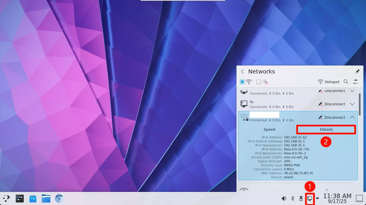

  1. Click the network icon
  2. Click the Connect button next to the WiFi network name you want to connect to
  3. Enter the WiFi password and follow the prompts to complete the connection
After a successful connection, select the Details option to view detailed network connection information, such as IP address, subnet mask, gateway address, etc.
For example, 192.168.31.62 is the IP address assigned by the router.
