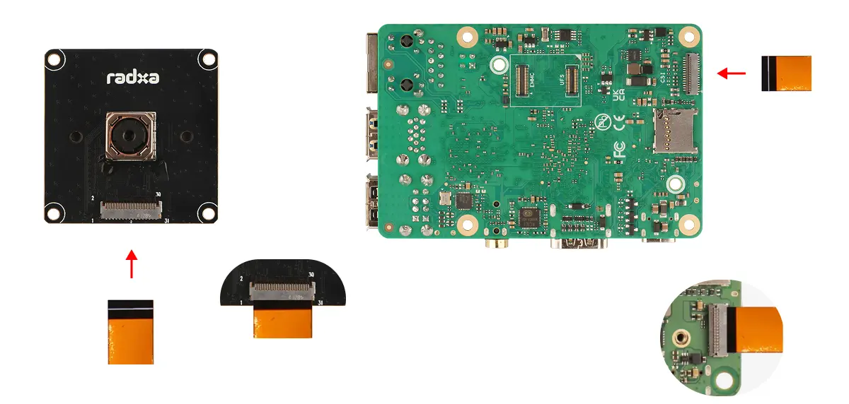

  • Connector type: 31-Pin 0.3 mm pitch SMD horizontal FPC connector
Camera FPC cable​
Hardware connection​
