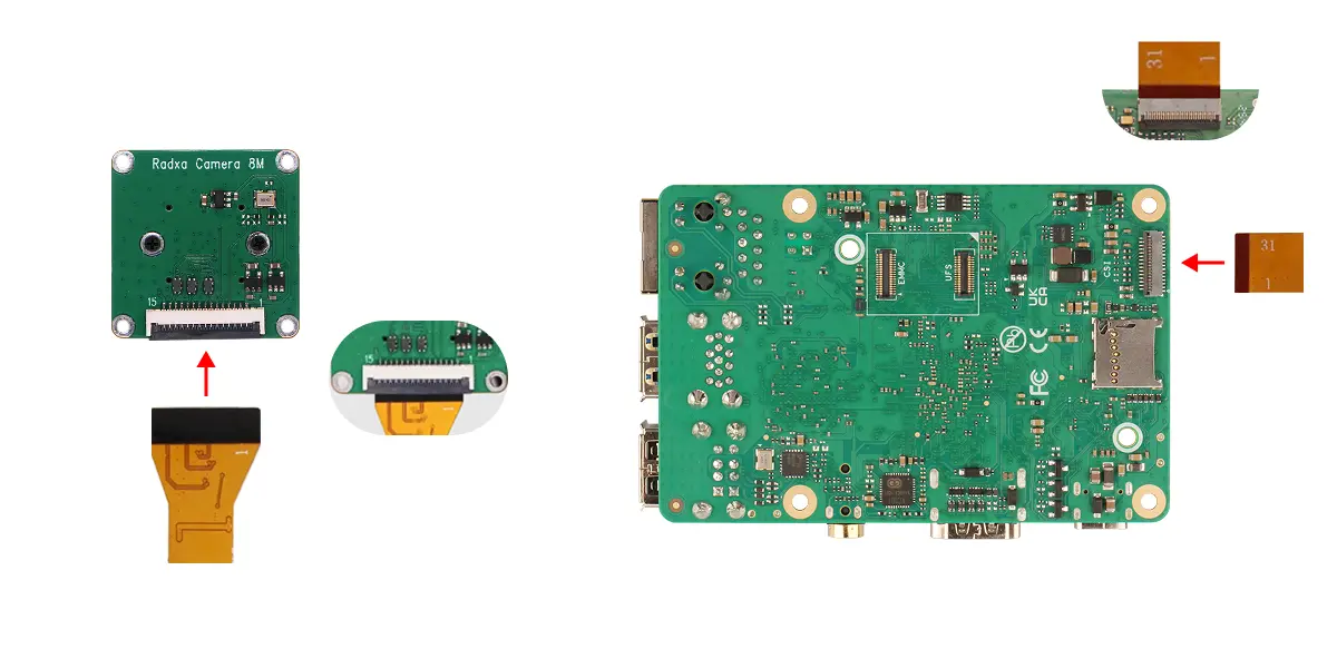

Camera FPC cable​
Use a 15-Pin 1.0 mm pitch to 31-Pin 0.3mm pitch same side FPC cable.
Hardware connection​
Insert the 15-pin metal contacts of the FPC cable into the camera connector, and insert the 31-Pin metal contacts of the FPC cable into the board MIPI CSI connector.
