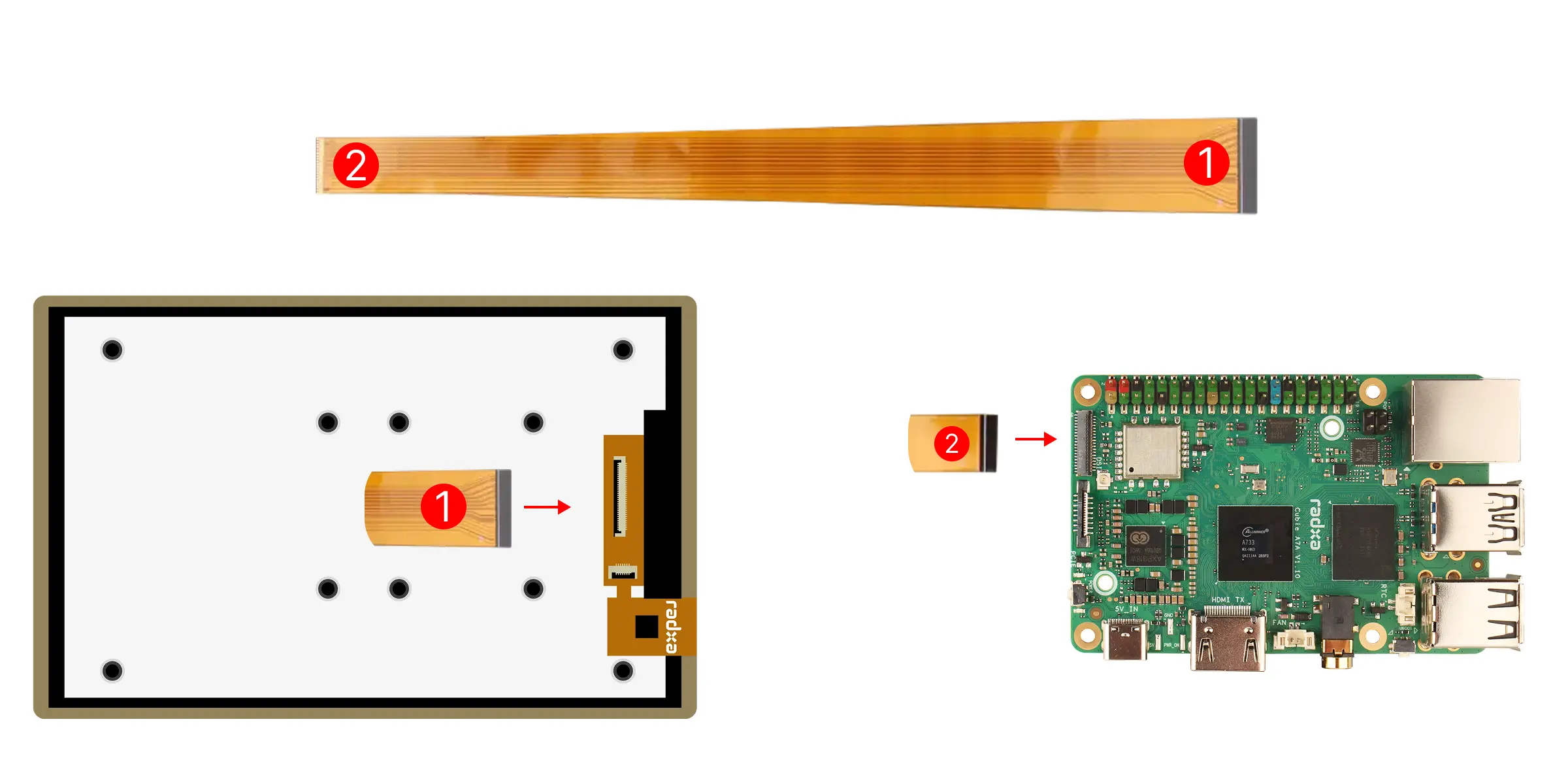

Display FPC Cable​
Uses a 40-Pin 0.5 mm pitch to 39-Pin 0.3mm pitchopposite side FPC cable
Hardware Connection​
Insert the 40-Pin metal contact end of the FPC cable into the display interface, and insert the 39-Pin metal contact end of the FPC cable into the board's MIPI DSI interface.
Precautions
  • Ensure both cable edges are flush with the socket edges, with no skew or partially exposed contacts
  • Confirm the cable has no creases, is not loose, and the lock is in the closed position
