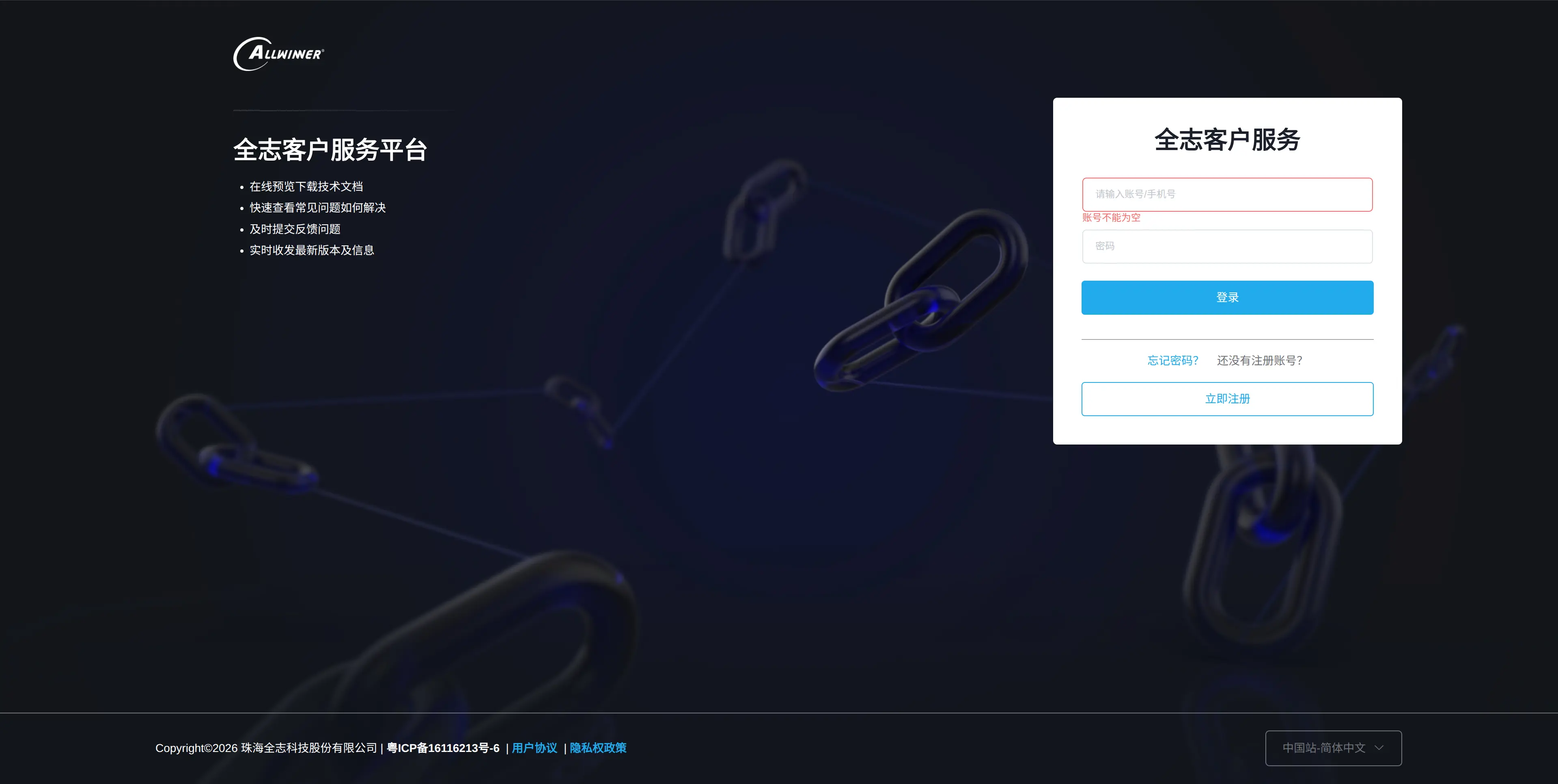

Click Register Now:
Allwinner Customer Service Platform Login

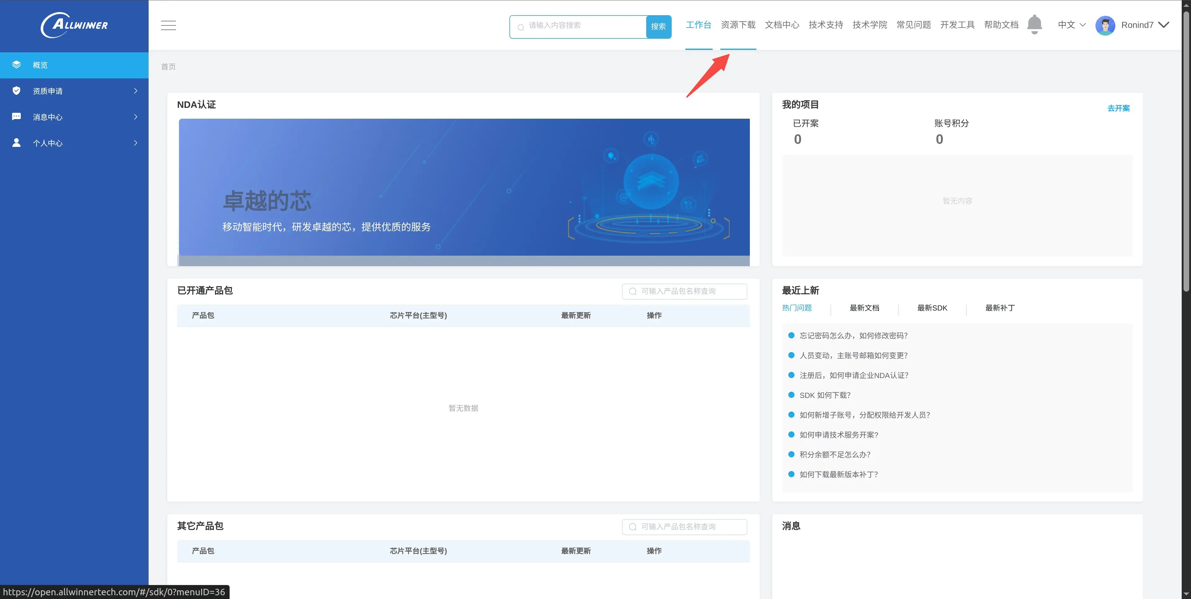

After successfully registering and logging in, you will enter the dashboard interface. Click Resource Download:

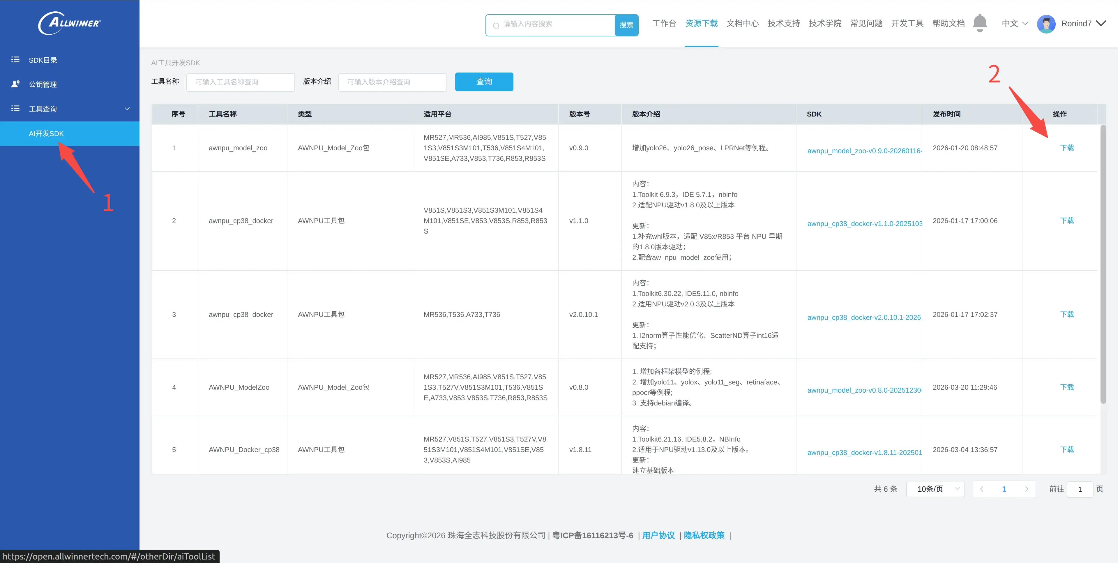

Click AI Development SDK under Tool Query on the left sidebar, then find the v0.9.0 version of Model Zoo and download it to your local machine.
Download Model Zoo
