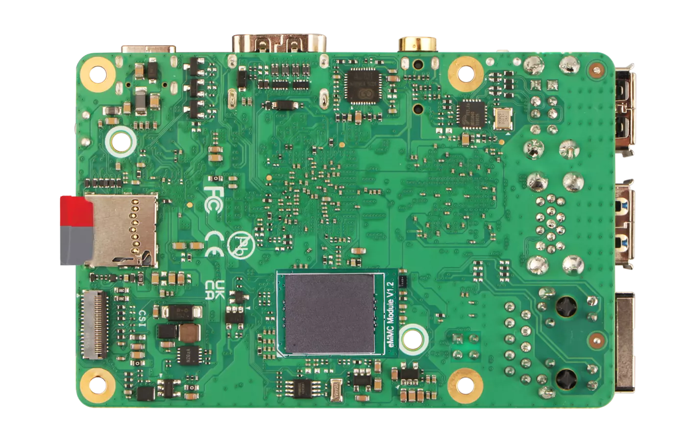

After confirming that the Cubie A7A has successfully booted from the microSD card, install the eMMC module into the eMMC/UFS combo module interface of the Cubie A7A.
caution
eMMC Module Installation Steps:​
  1. Ensure the notch on the eMMC module aligns with the notch on the Cubie A7A's eMMC/UFS combo module interface
  2. Align the bottom edge connector of the eMMC module with the eMMC/UFS combo module interface on the Cubie A7A
  3. Gently press down on one end of the eMMC module until you hear a "click" sound, indicating successful installation. Repeat the same process for the other end to ensure the eMMC module is properly seated.
eMMC module installation diagram
