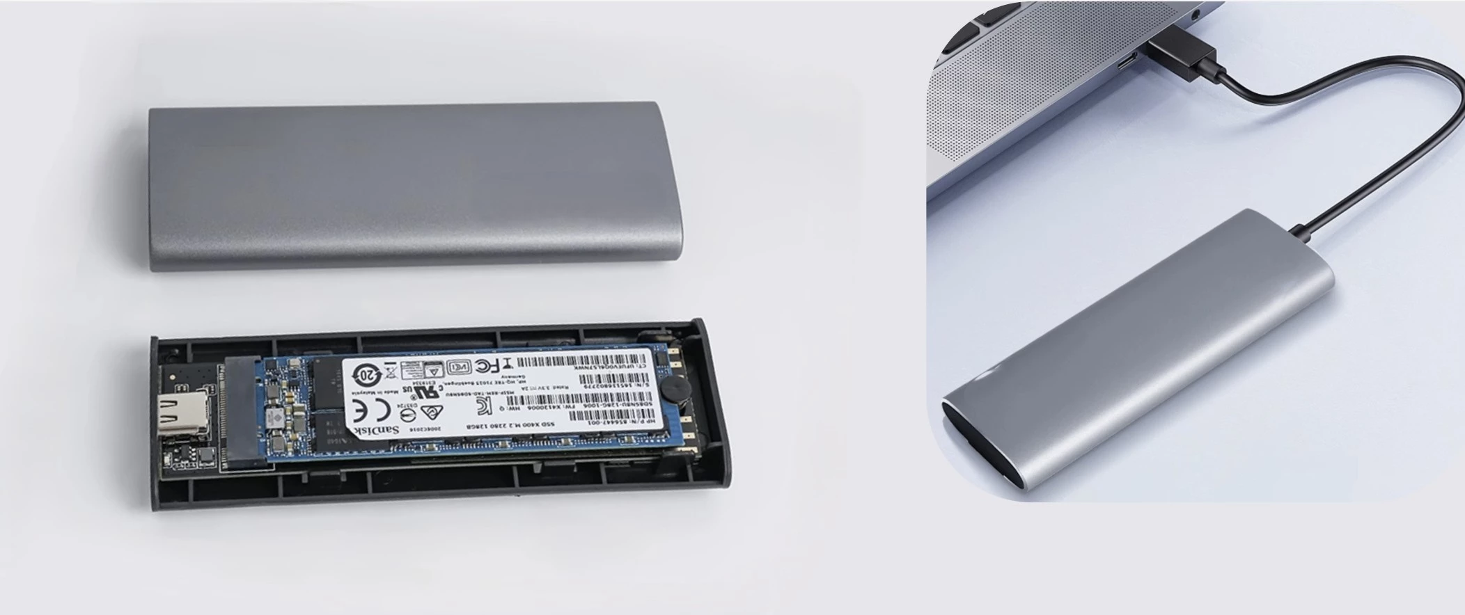

Install the M.2 NVMe SSD into the SSD enclosure, then connect the enclosure to your PC's USB port.
