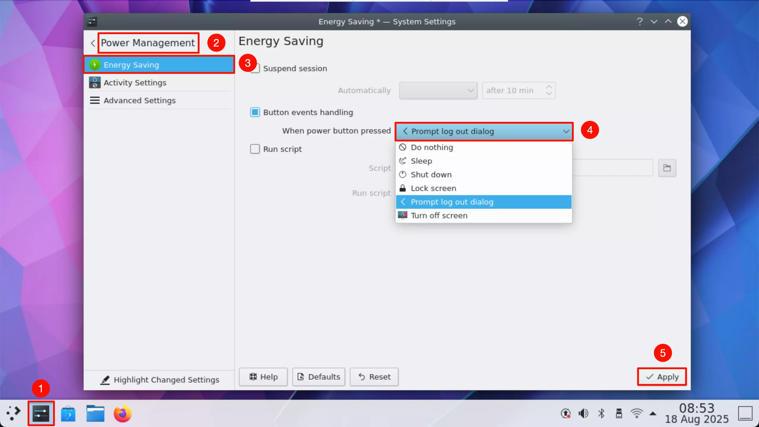

    • Custom behavior: - You can customize the power key function via ① : System Settings -> ② : Power Management -> ③ : Energy Saving -> ④ : Button events handling, then click ⑤ : Apply to save the settings.
