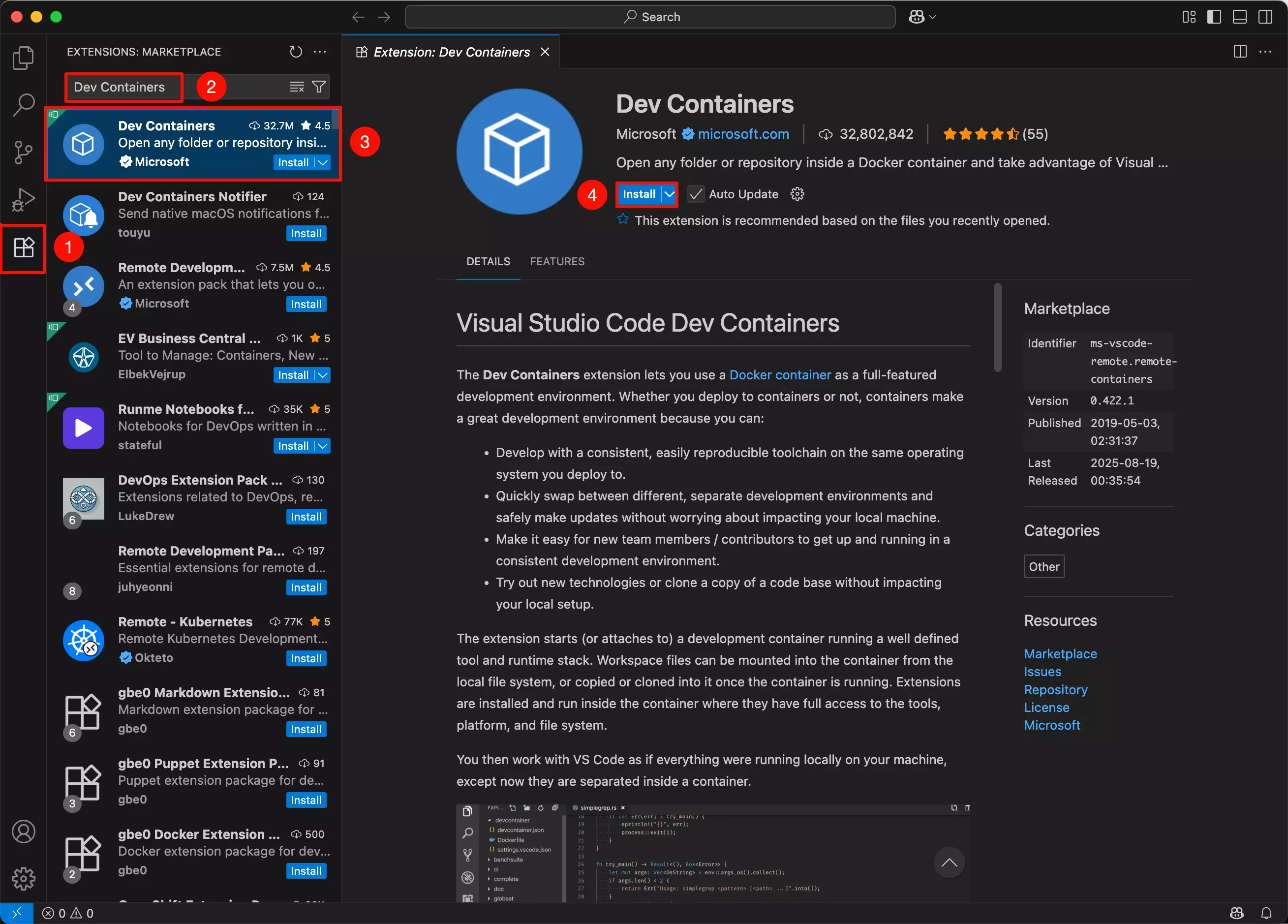

Install Extension Plugin
You need to install the Dev Containers extension in VS Code.
① : Click the Extensions option
② : Search for Dev Containers
③ : Select the Dev Containers extension
④ : Click the Install option to install the Dev Containers extension

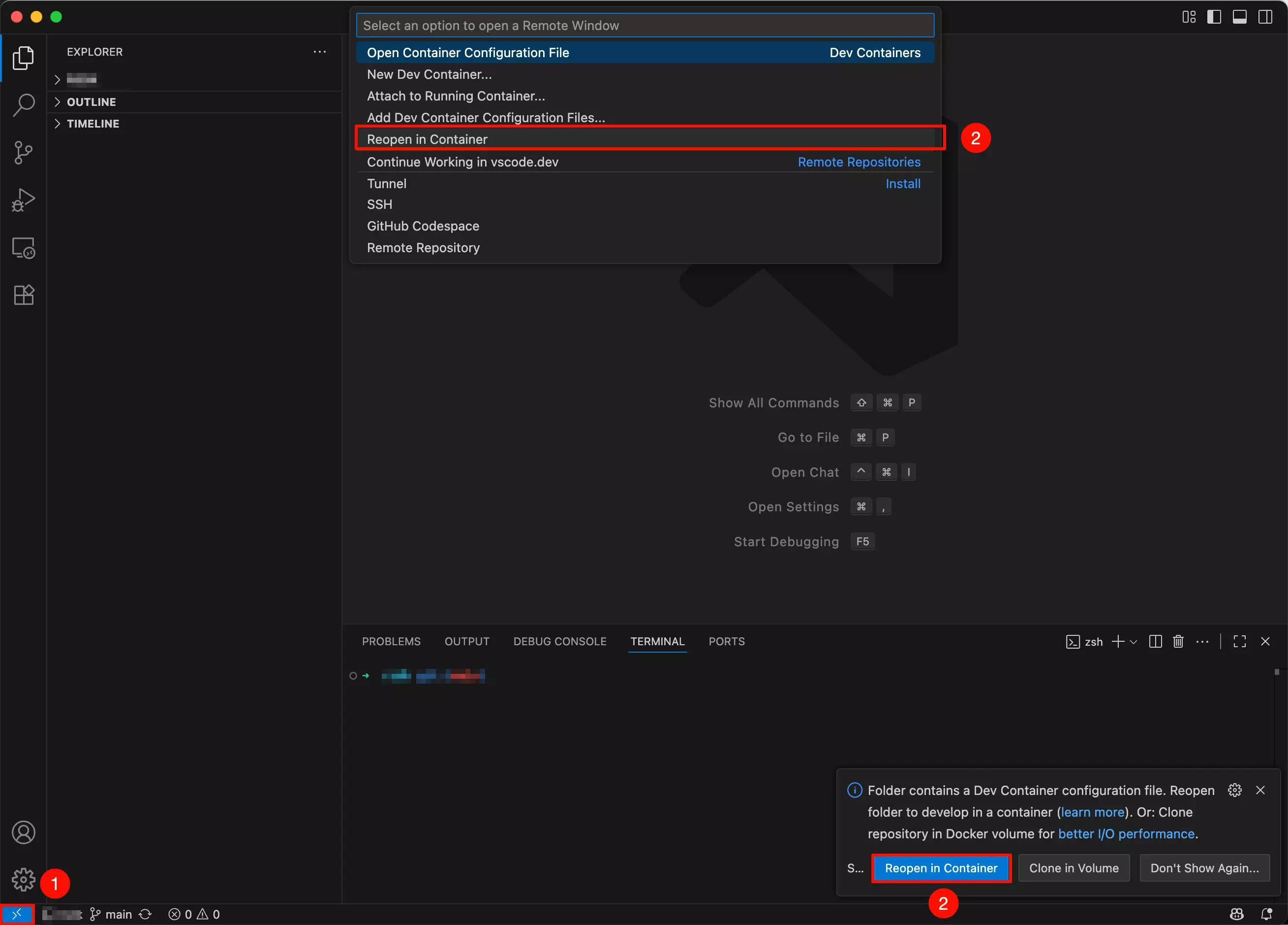

Start Development Environment
Open the U-Boot source code directory. Generally, the Dev Container extension will automatically detect the configuration files in the folder and prompt you to reopen the container development environment.
When starting the development environment for the first time, Dev Containers will automatically download and install dependencies. Please be patient and wait for the process to complete.
① : Click the Remote option in the bottom left corner
② : Select the Reopen in Container option
