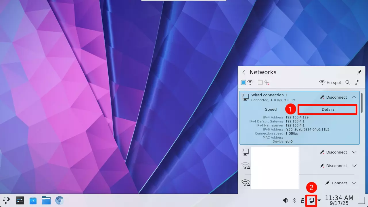

Connect the board's Gigabit Ethernet port to a router using an Ethernet cable. Once connected, the router will automatically assign an IP address to the board.
Connect the board's Ethernet port to a router using an Ethernet cable. Once connected, the router will automatically assign an IP address to the board.
  1. Click the network icon
  2. Select the Details option to view network connection details such as IP address, subnet mask, gateway address, etc.
For example, 192.168.4.129 is the IP address assigned by the router.
