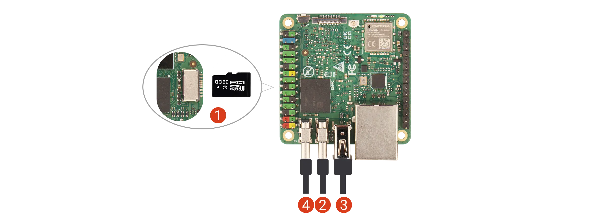

Boot the system​
① Insert the microSD card into the microSD slot
② Connect a monitor using a USB‑C to HDMI/DP cable
③ Connect keyboard/mouse via USB‑A (use a USB hub if needed)
④ Power the board with a 5V USB‑C power adapter
If power is OK, the power LED turns green. If the system boots, the status LED blinks blue.

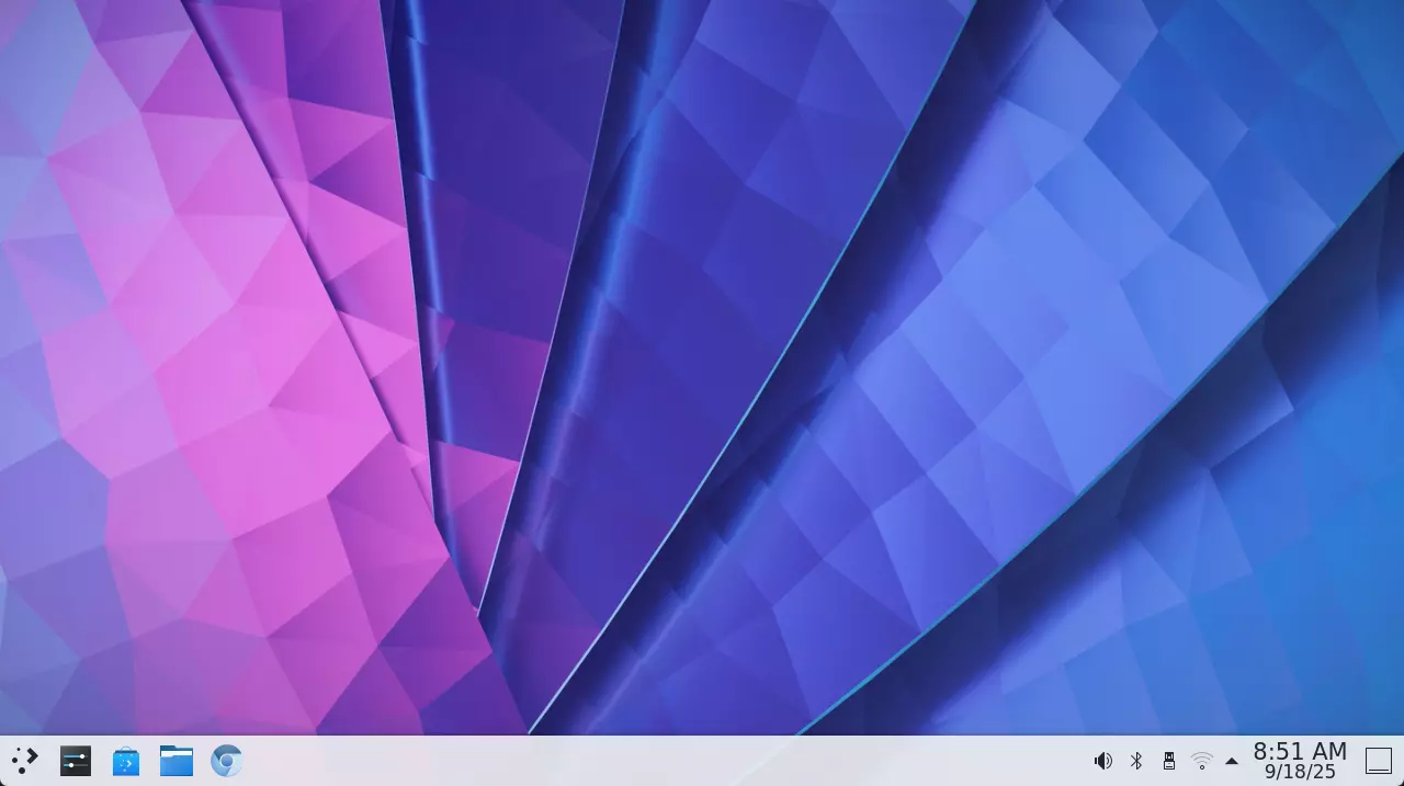

After booting successfully, you should see the desktop. Log in using the credentials below.
Default credentials​
For official system images:
ItemValue
Usernameradxa
Passwordradxa
Log in​
Log in with the default credentials.
