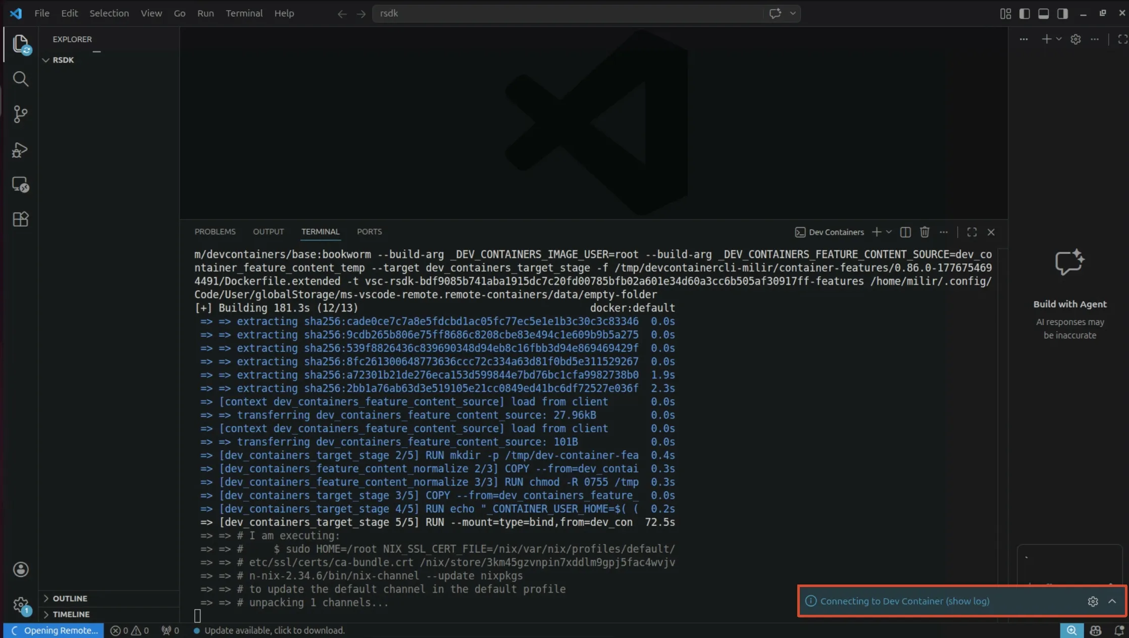

Start development environment
Open the Radxa OS SDK (rsdk) source code directory with Visual Studio Code: The
Dev Containerextension will usually automatically detect the configuration file in the folder and prompt you to reopen in the container development environment.tipWhen starting the development environment for the first time, Dev Containers will automatically download and install dependencies. Please be patient as this may take some time.
- Click the
Remoteoption in the bottom-left corner - Select the
Reopen in Containeroption
Wait for the container to automatically connect and initialize the environment. You can click the bottom right corner to select to display logs in the terminal.
