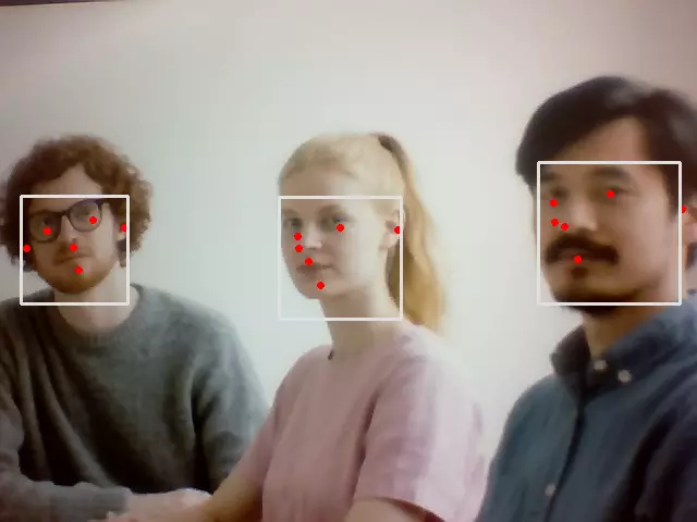

Face Detection
This example captures video from the camera, detects faces, and draws bounding boxes around them.
To run this example:
  1. Create a new file named face_detection.py
  2. Copy the following code into face_detection.py
  3. Run the example with python3 face_detection.py
  4. Click on the preview window and press 'q' to quit
face_detection.py
#!/usr/bin/env python3
# -_- encoding: utf-8 -_-
import cv2
import mediapipe as mp
mp_face_detection = mp.solutions.face_detection
mp_drawing = mp.solutions.drawing_utils
cap = cv2.VideoCapture(0)
with mp_face_detection.FaceDetection(
model_selection=0, min_detection_confidence=0.5) as face_detection:
while cap.isOpened():
success, image = cap.read()
if not success:
print("Ignoring empty camera frame.") # If loading a video, use 'break' instead of 'continue'.
continue
# To improve performance, optionally mark the image as not writeable to
# pass by reference.
image.flags.writeable = False
image = cv2.cvtColor(image, cv2.COLOR_BGR2RGB)
results = face_detection.process(image)
# Draw the face detection annotations on the image.
image.flags.writeable = True
image = cv2.cvtColor(image, cv2.COLOR_RGB2BGR)
if results.detections:
for detection in results.detections:
mp_drawing.draw_detection(image, detection)
# Flip the image horizontally for a selfie-view display.
cv2.imshow('MediaPipe Face Detection', cv2.flip(image, 1))
if cv2.waitKey(1) & 0xFF == ord('q'):
break
cap.release()
cv2.destroyAllWindows()
Preview:

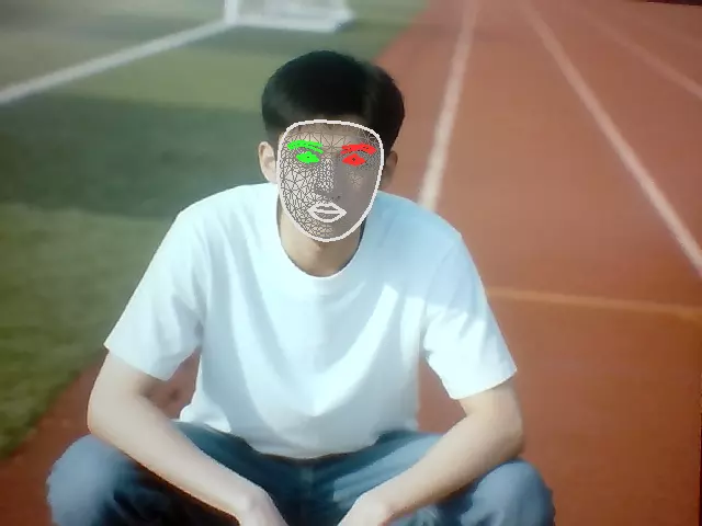

Face Mesh
This example captures video from the camera, detects faces, and applies a mesh overlay on detected faces.
  1. Create a new file named face_mesh.py
  2. Copy the following code into face_mesh.py
  3. Run the example with python3 face_mesh.py
face_mesh.py
import cv2
mp_drawing_styles = mp.solutions.drawing_styles
mp_face_mesh = mp.solutions.face_mesh
drawing_spec = mp_drawing.DrawingSpec(thickness=1, circle_radius=1)
with mp_face_mesh.FaceMesh(
max_num_faces=1,
refine_landmarks=True,
min_detection_confidence=0.5,
min_tracking_confidence=0.5) as face_mesh:
if not success:
continue
results = face_mesh.process(image)
# Draw the face mesh annotations on the image.
if results.multi_face_landmarks:
for face_landmarks in results.multi_face_landmarks:
mp_drawing.draw_landmarks(
image=image,
landmark_list=face_landmarks,
connections=mp_face_mesh.FACEMESH_TESSELLATION,
landmark_drawing_spec=None,
connection_drawing_spec=mp_drawing_styles
.get_default_face_mesh_tessellation_style())
image=image,
connections=mp_face_mesh.FACEMESH_CONTOURS,
.get_default_face_mesh_contours_style())
image=image,
connections=mp_face_mesh.FACEMESH_IRISES,
.get_default_face_mesh_iris_connections_style())
cv2.imshow('MediaPipe Face Mesh', cv2.flip(image, 1))
break
cap.release()
Preview:

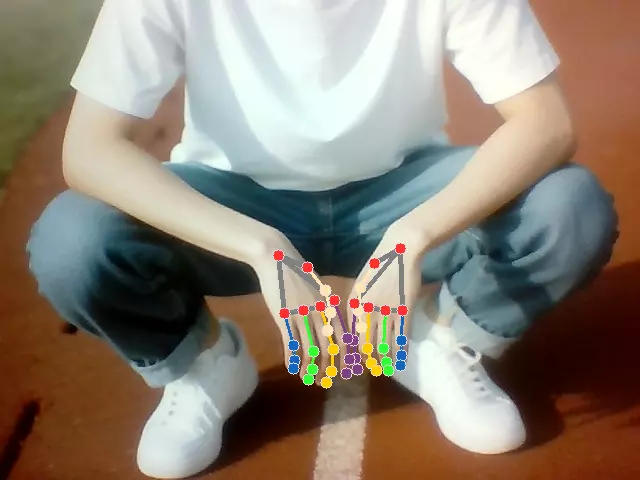

Hand Detection
Read the camera image and perform hand detection, drawing the skeleton on the detected hand.
Run the example steps:
  1. Create a new file named hand_detection.py
  2. Copy the code into hand_detection.py
  3. Run the example with python3 hand_detection.py
hand_detection.py
import cv2
mp_hands = mp.solutions.hands
with mp_hands.Hands(
model_complexity=0,
min_tracking_confidence=0.5) as hands:
if not success:
continue
results = hands.process(image)
# Draw the hand annotations on the image.
if results.multi_hand_landmarks:
for hand_landmarks in results.multi_hand_landmarks:
image,
hand_landmarks,
mp_hands.HAND_CONNECTIONS,
mp_drawing_styles.get_default_hand_landmarks_style(),
mp_drawing_styles.get_default_hand_connections_style())
cv2.imshow('MediaPipe Hands', cv2.flip(image, 1))
break
cap.release()
Preview:

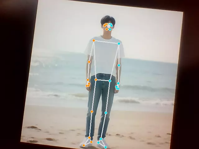

骨骼检测
读取摄像头画面并进行人体检测,在检测出来的人体上绘制骨骼。
  1. Create a new file named pose_detection.py
  2. Copy the following code into pose_detection.py
  3. Run the example with python3 pose_detection.py
pose_detection.py
import cv2
mp_pose = mp.solutions.pose
with mp_pose.Pose(
min_tracking_confidence=0.5) as pose:
if not success:
continue
results = pose.process(image)
# Draw the pose annotation on the image.
image,
results.pose_landmarks,
mp_pose.POSE_CONNECTIONS,
landmark_drawing_spec=mp_drawing_styles.get_default_pose_landmarks_style())
cv2.imshow('MediaPipe Pose', cv2.flip(image, 1))
break
cap.release()
Preview:

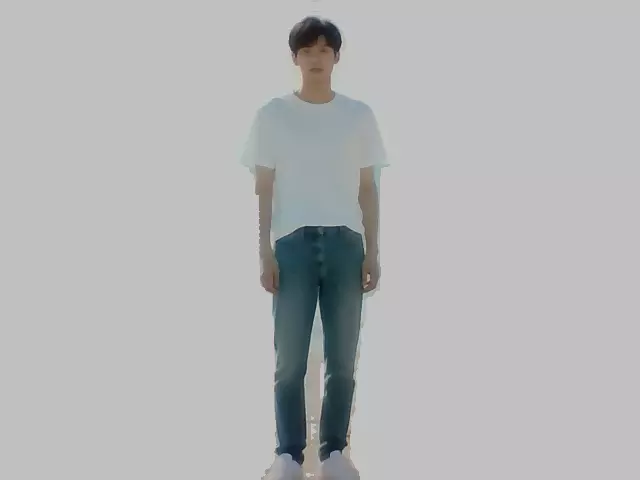

Background Segmentation
Read the camera image and perform background segmentation, replacing the background with a solid color.
  1. Create a new file named back_seg.py
  2. Copy the code into back_seg.py
  3. Run the example with python3 back_seg.py
back_seg.py
import cv2
import numpy as np
mp_selfie_segmentation = mp.solutions.selfie_segmentation
BG_COLOR = (192, 192, 192) # gray
with mp_selfie_segmentation.SelfieSegmentation(
model_selection=1) as selfie_segmentation:
bg_image = None
if not success:
continue
# Flip the image horizontally for a later selfie-view display, and convert
# the BGR image to RGB.
image = cv2.cvtColor(cv2.flip(image, 1), cv2.COLOR_BGR2RGB)
results = selfie_segmentation.process(image)
# Draw selfie segmentation on the background image.
# To improve segmentation around boundaries, consider applying a joint
# bilateral filter to "results.segmentation_mask" with "image".
condition = np.stack(
(results.segmentation_mask,) * 3, axis=-1) > 0.1
# The background can be customized.
# a) Load an image (with the same width and height of the input image) to
# be the background, e.g., bg_image = cv2.imread('/path/to/image/file')
# b) Blur the input image by applying image filtering, e.g.,
# bg_image = cv2.GaussianBlur(image,(55,55),0)
if bg_image is None:
bg_image = np.zeros(image.shape, dtype=np.uint8)
bg_image[:] = BG_COLOR
output_image = np.where(condition, image, bg_image)
cv2.imshow('MediaPipe Selfie Segmentation', output_image)
break
cap.release()
Preview:

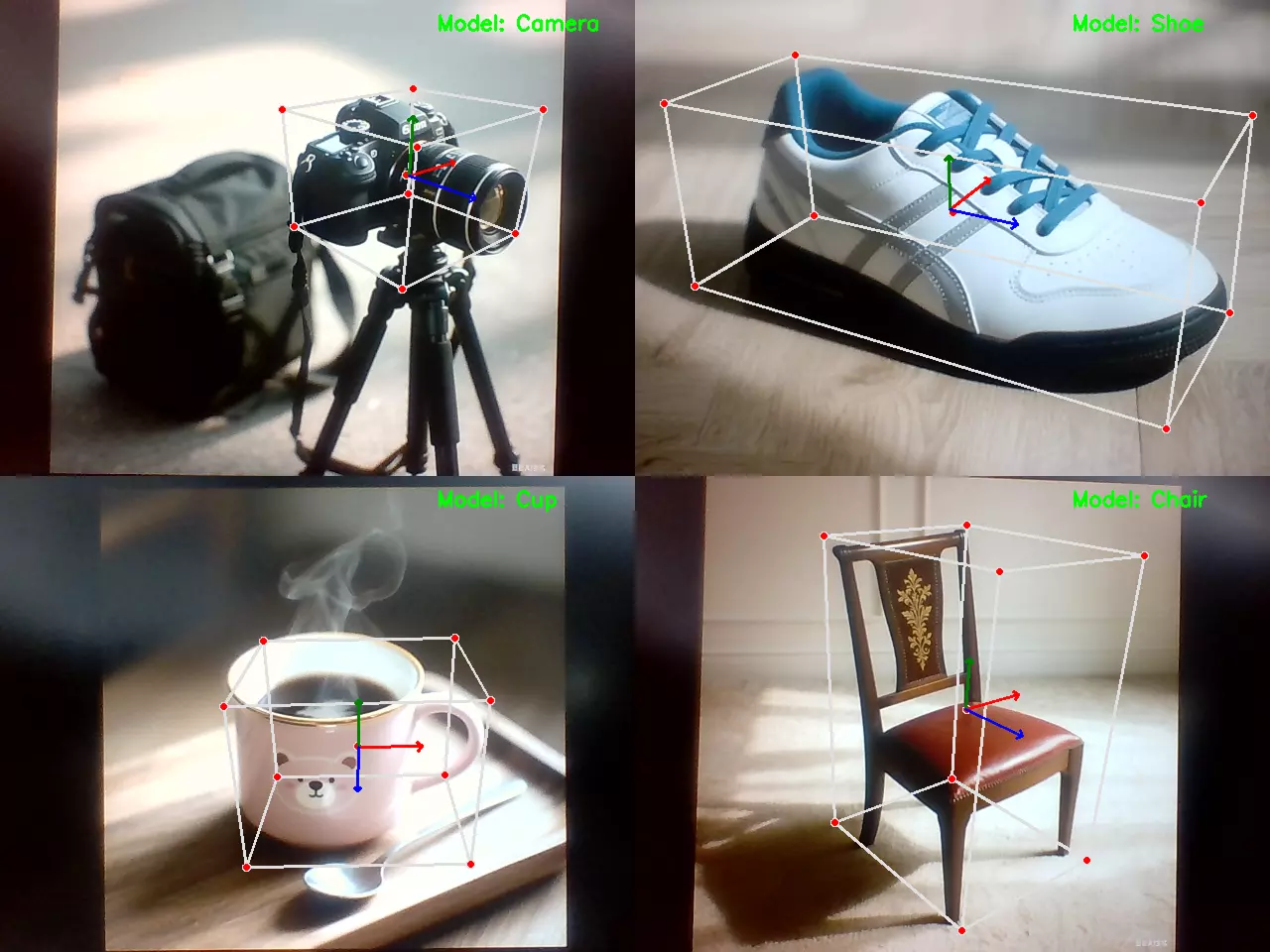

3D Object Detection
Read the camera feed and perform 3D object detection (supports four models: shoe, chair, cup, and camera), then draw 3D bounding boxes around the detected objects.
  1. Create a new file named 3d_object_detection.py
  2. Copy the following code into 3d_object_detection.py
  3. Run the example with python3 3d_object_detection.py
# -_- coding: utf-8 -_-
import cv2
# Initialize MediaPipe components
mp_objectron = mp.solutions.objectron
# Available models
MODELS = ['Shoe', 'Chair', 'Cup', 'Camera']
current_model = 0 # Start with first model
# Initialize video capture
# Create initial Objectron instance
objectron = mp_objectron.Objectron(
static_image_mode=False,
max_num_objects=5,
min_tracking_confidence=0.99,
model_name=MODELS[current_model]
if not success:
continue
# Process image
results = objectron.process(image)
# Draw results
if results.detected_objects:
for detected_object in results.detected_objects:
image, detected_object.landmarks_2d, mp_objectron.BOX_CONNECTIONS)
mp_drawing.draw_axis(image, detected_object.rotation,
detected_object.translation)
# # First flip the image for display
# image = cv2.flip(image, 1)
# Then add text to the already-mirrored image
# Note: We adjust the x-position to account for mirroring
text_x = image.shape[1] - 200 # Right side position
cv2.putText(image, f"Model: {MODELS[current_model]}", (text_x, 30),
cv2.FONT_HERSHEY_SIMPLEX, 0.7, (0, 255, 0), 2)
# Show final view
cv2.imshow('MediaPipe Objectron', image)
# Key handling
key = cv2.waitKey(5) & 0xFF
if key == 27 or key == ord('q'): # ESC or 'q' to quit
break
elif key == ord('f'): # 'f' for next model
current_model = (current_model + 1) % len(MODELS)
max_num_objects=5,
print(f"Switched to model: {MODELS[current_model]}")
cap.release()
Preview:
