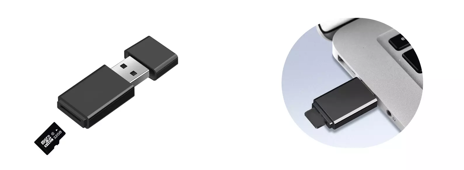

You need to prepare the following hardware devices in advance:
  • MicroSD card
  • MicroSD card reader
To ensure the system runs smoothly, choose a MicroSD card with a U1 or higher rating for system burning and usage.
Hardware Connection​
Insert the MicroSD card into the MicroSD card reader, then connect the card reader to your computer.

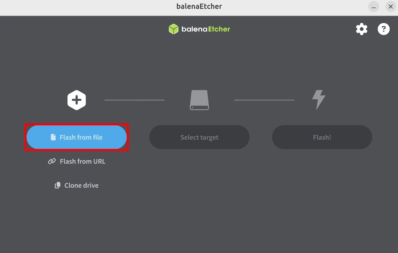

Select System Image​
Click the Flash from file option and select the system image file you downloaded and extracted earlier.

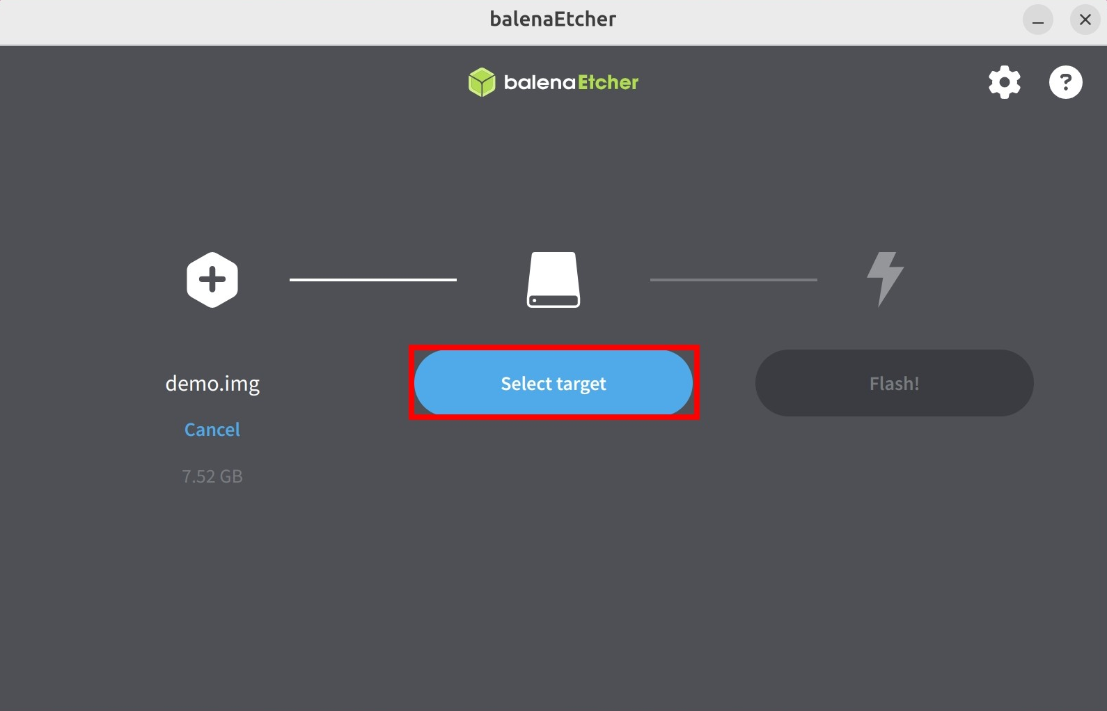

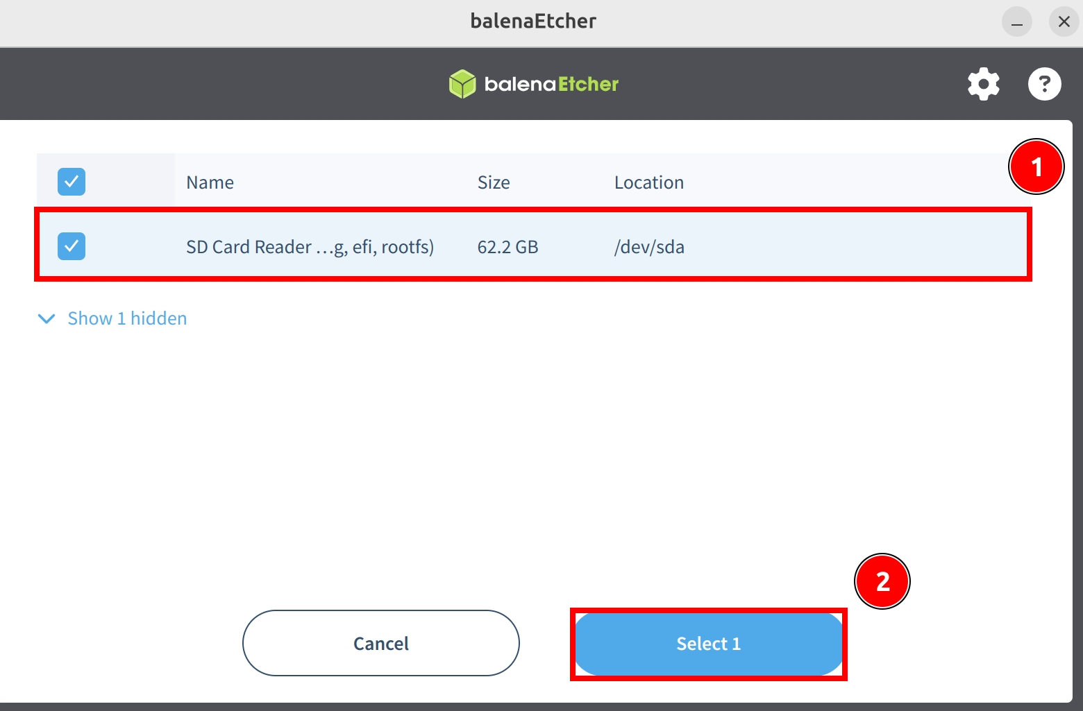

Select Storage Device​
Click the Select target option and choose the MicroSD card device.

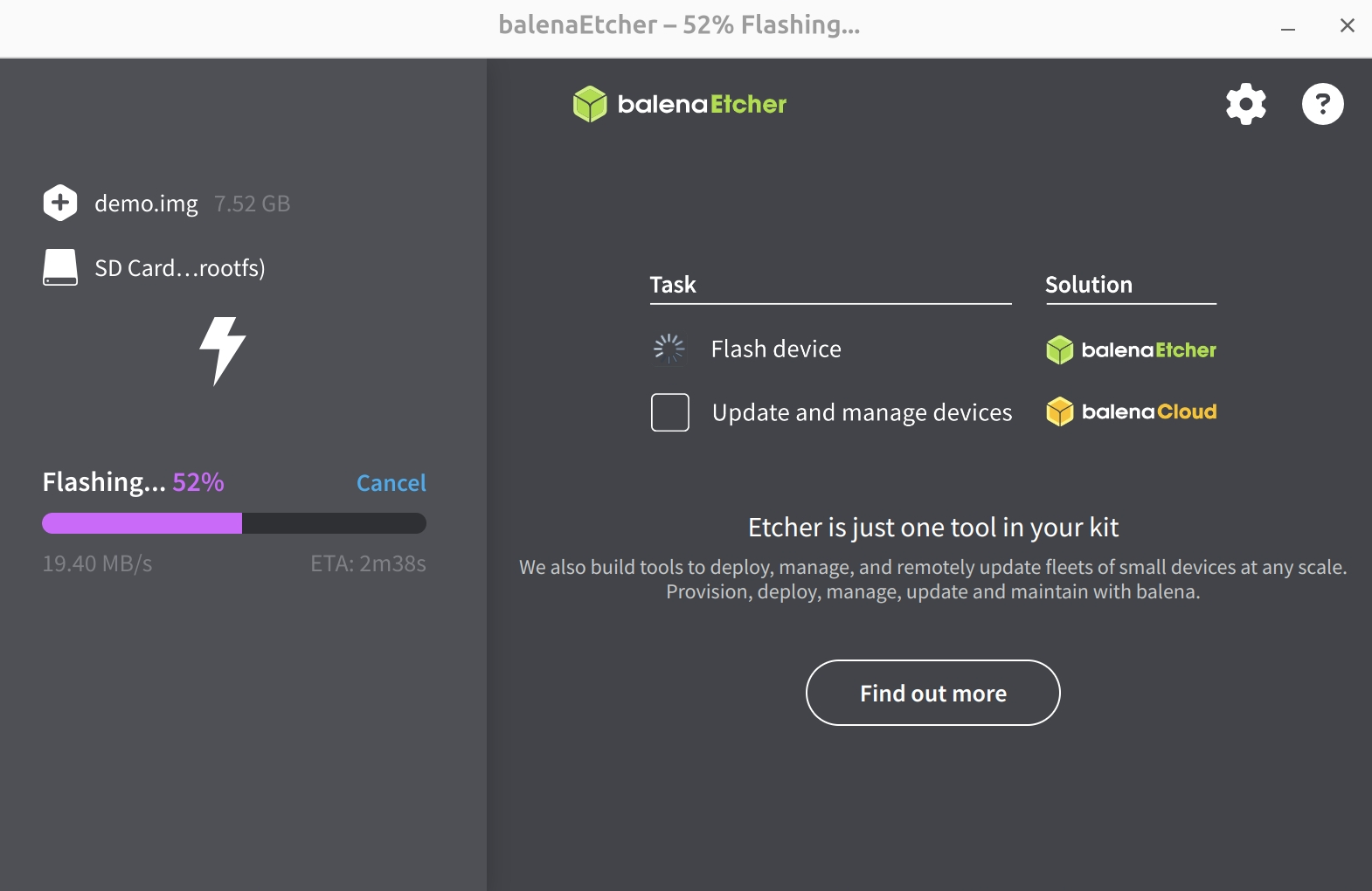

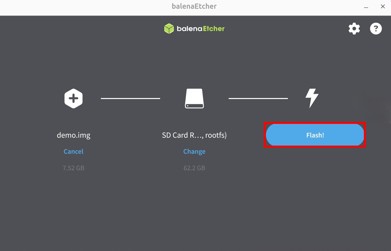

Start Flashing​
Click the Flash! option to start flashing the system image to the MicroSD card.

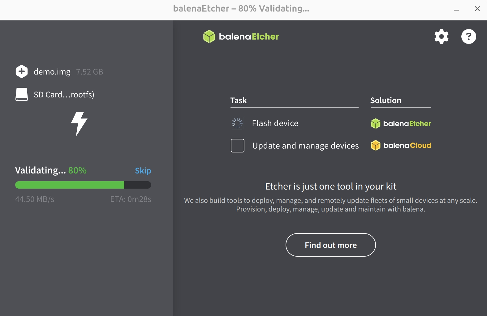

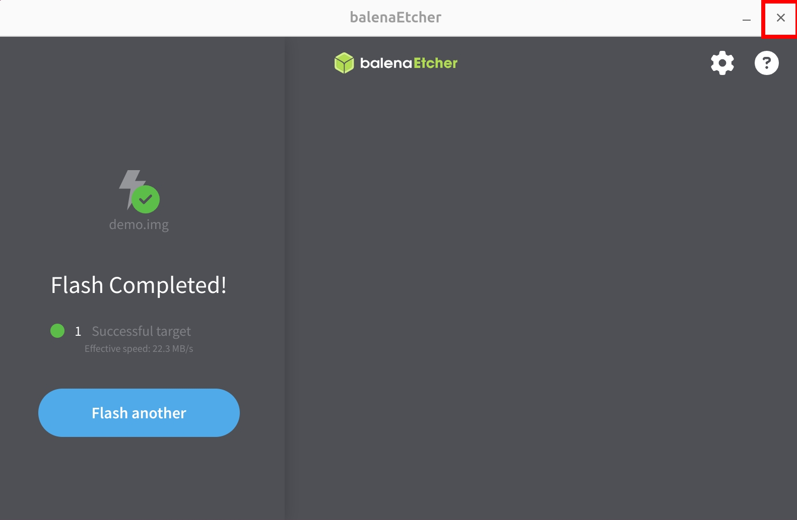

Waiting for system installation to complete
Waiting for system verification to complete
After successfully installing the system image, close the Etcher software!
