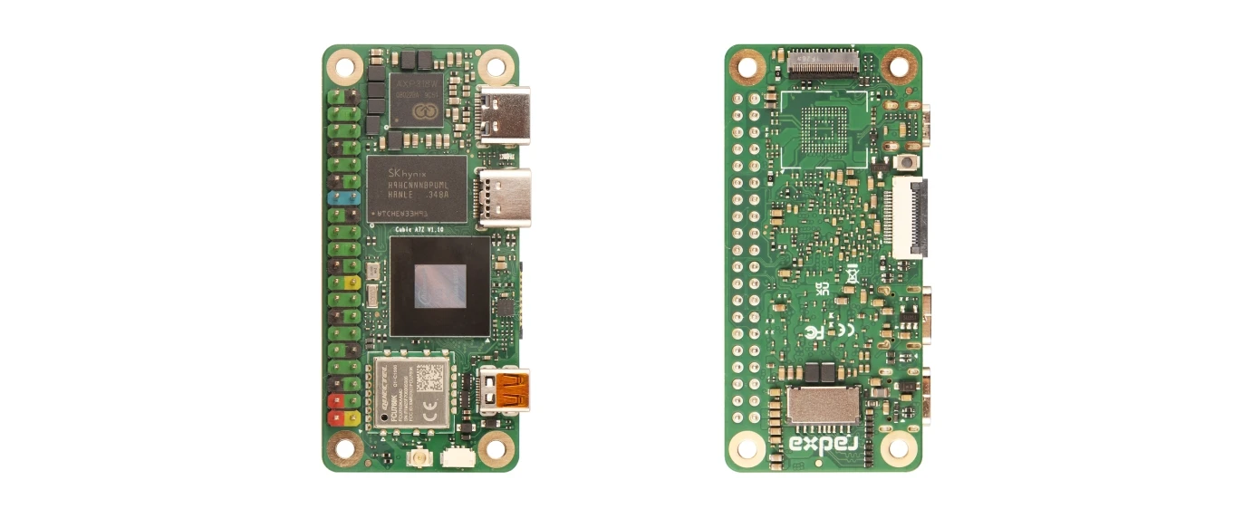

Product Overview​
Cubie A7Z V1.10 / V1.11 front and back
