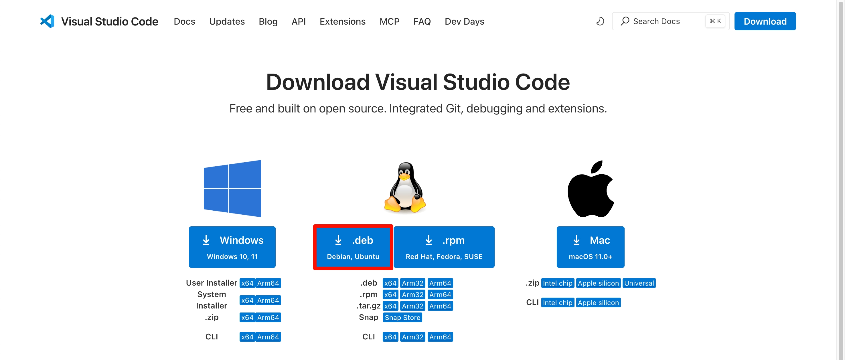

Visit the Visual Studio Code download page and select the appropriate installation package for your system. For Ubuntu, choose the .deb package.
