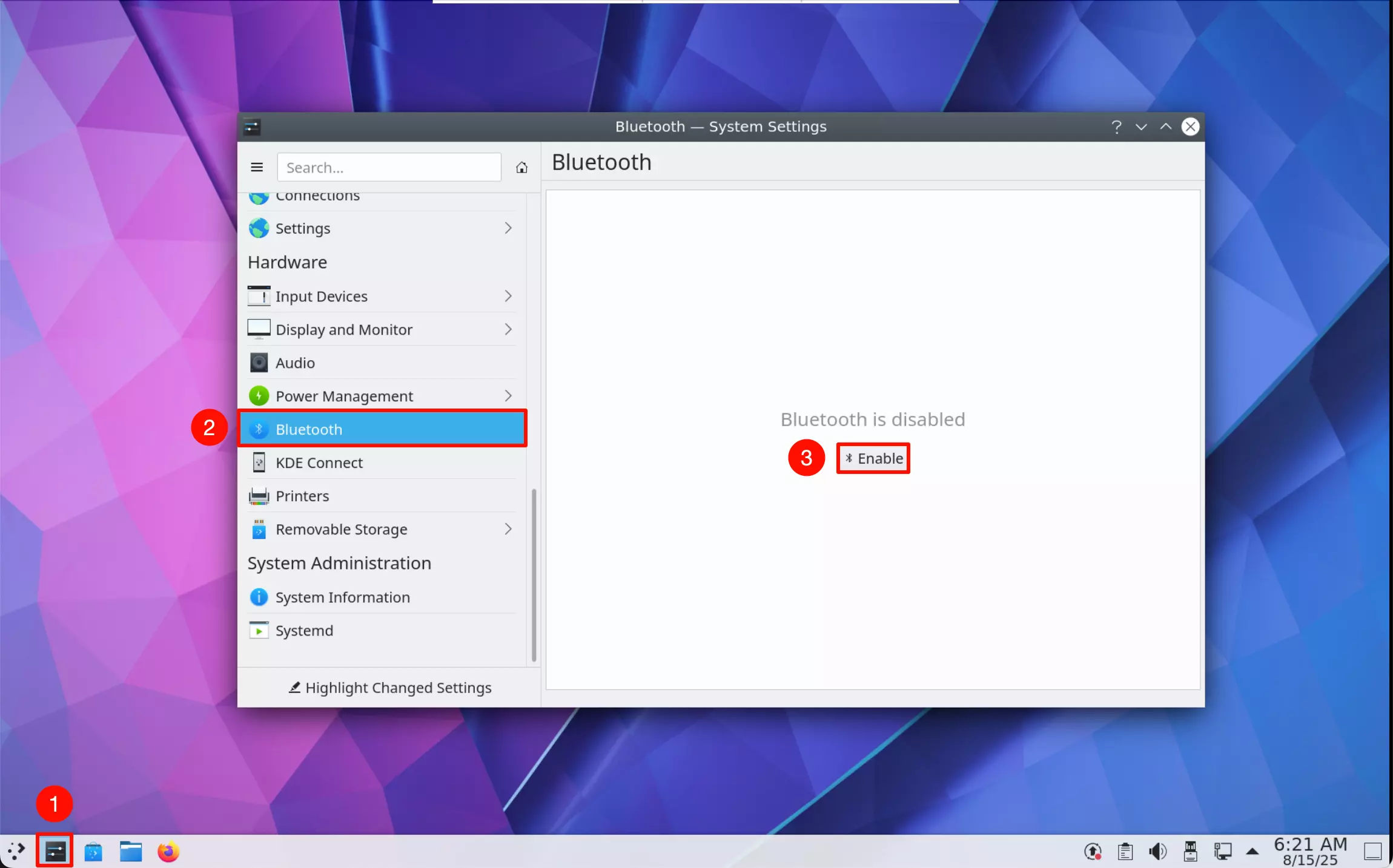

- Enable Bluetooth
① : Click the System Settings
icon
② : Select the Bluetooth
option
③ : Click Enable
to turn on Bluetooth

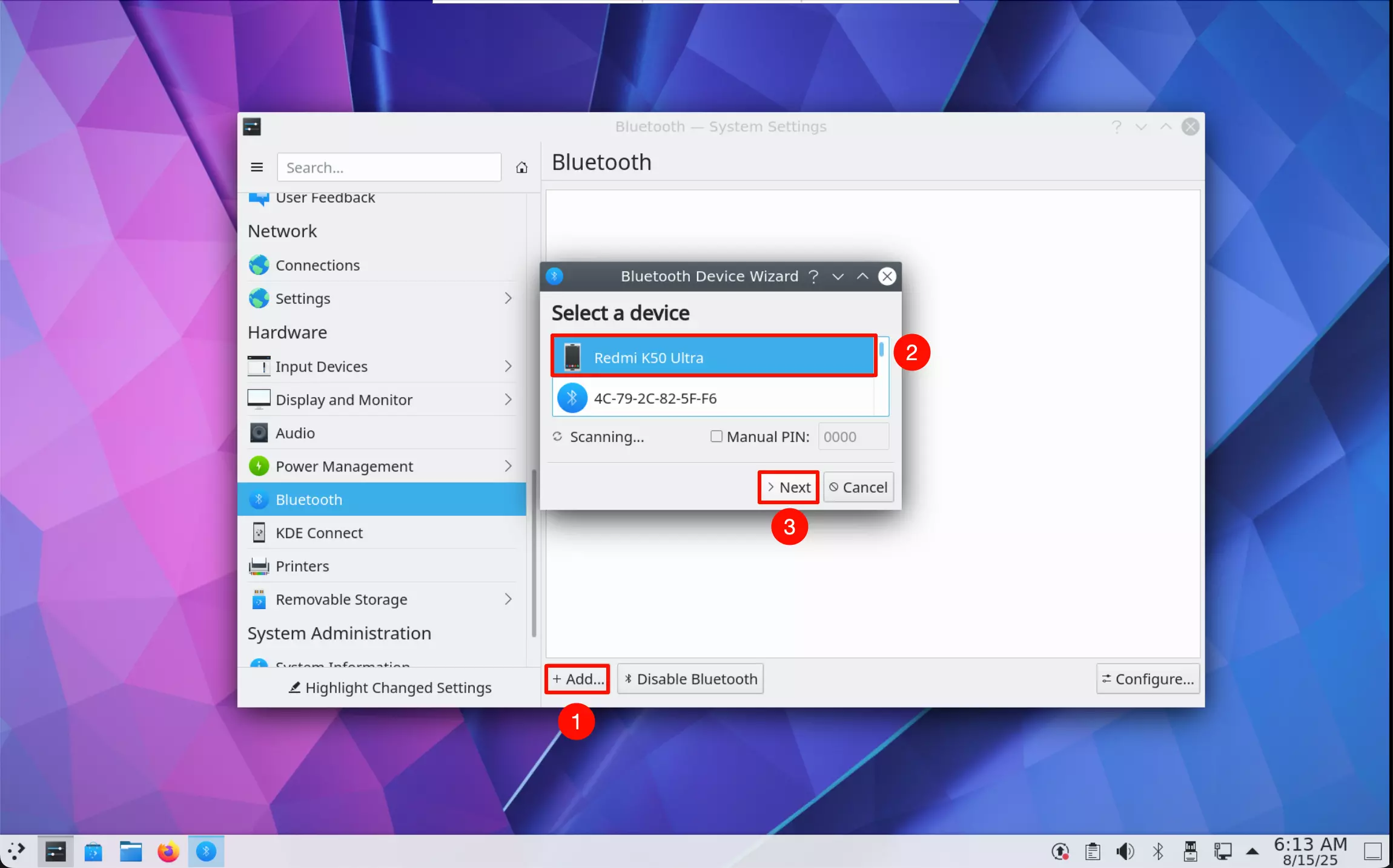

- Connect Bluetooth Device
① : Click Add ...
to automatically scan for nearby Bluetooth devices
② : Find the Bluetooth device you want to connect to in the list of available devices
③ : Click Next
to connect to the selected Bluetooth device

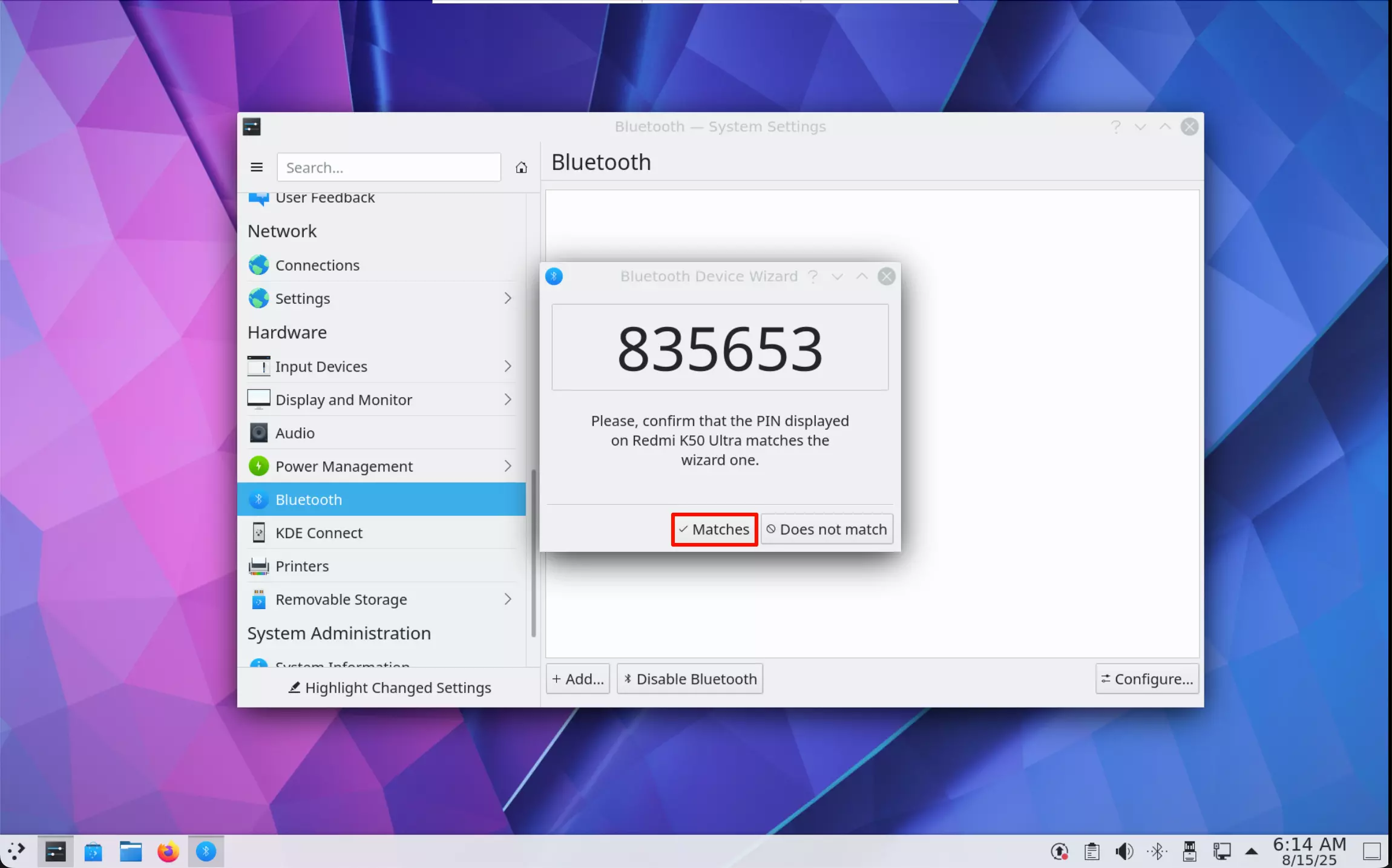

- Pair Bluetooth Device
During the connection process, you'll need to pair your Bluetooth device. Follow the on-screen instructions to complete the pairing.

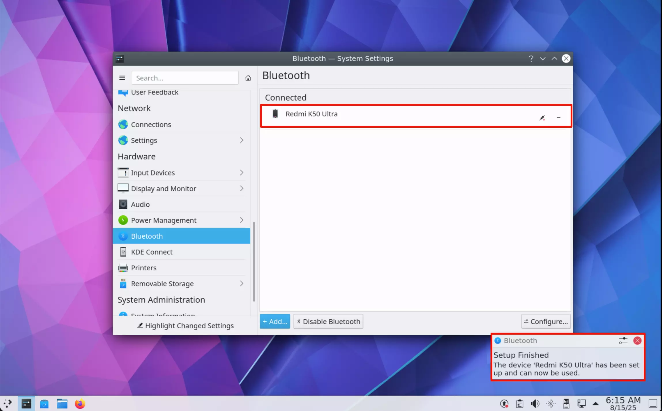

- Connection Successful
After successfully connecting the Bluetooth device, the system will display a confirmation message.
