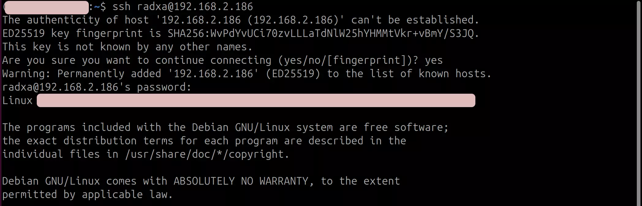

On another device, open a terminal and enter the following command to log in remotely:
ssh <user-name>@<ip-address>
# Example
ssh [email protected]
Where <user-name>
and <ip-address>
are the actual username and IP address of the target device, respectively.
During the connection process, you'll need to enter yes
to confirm the connection.

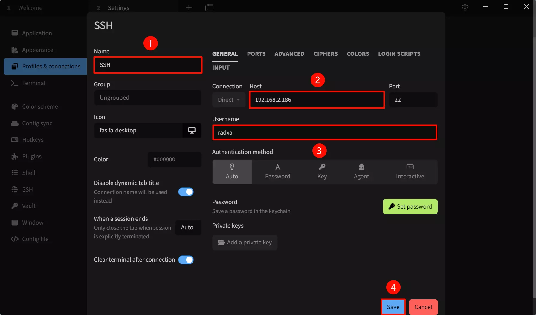

SSH Configuration
① --> Settings
: Click the settings option
② --> Profiles & connections
: Click to configure connection options
③ --> New profile
: Click to add a new configuration
Select SSH Template
Choose a base configuration as a template: Select the SSH connection
template. You can modify parameters such as device name, IP address, and port in the subsequent configuration interface.
After selecting the SSH connection
template, modify the following parameters:
① --> Name
: Set the connection name
② --> Host
: Enter the IP address of the target device
③ --> User
: Set the username (default is radxa
for factory settings)
④ --> Save
: Save the configuration
The default port number is 22
, which typically doesn't need to be changed.

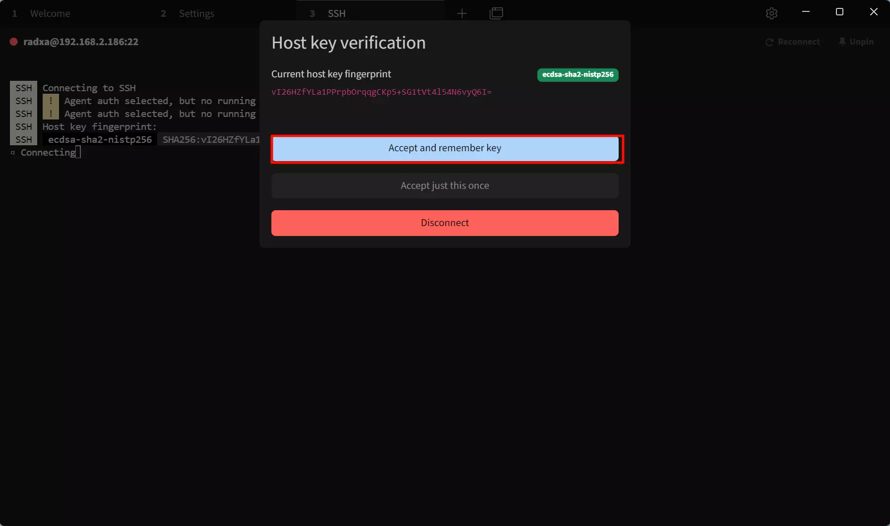

After clicking the run button, Tabby will display a key verification and password input interface.

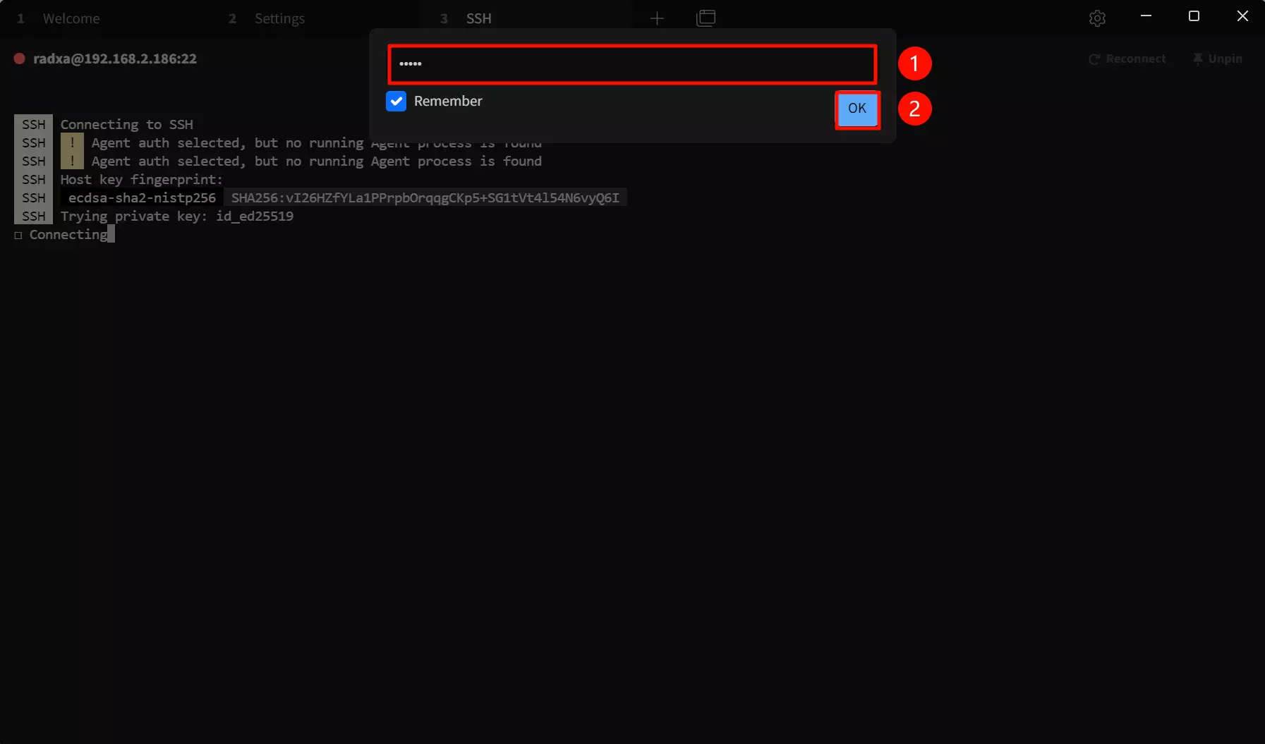

① --> password : Enter the password for the target device
② --> OK : Confirm the connection
It's recommended to check the Remember
option so you won't need to enter the password on subsequent connections.
After a successful connection, the remote interface will appear.
After successfully logging in via SSH, you can run commands to control the system through the SSH session.
