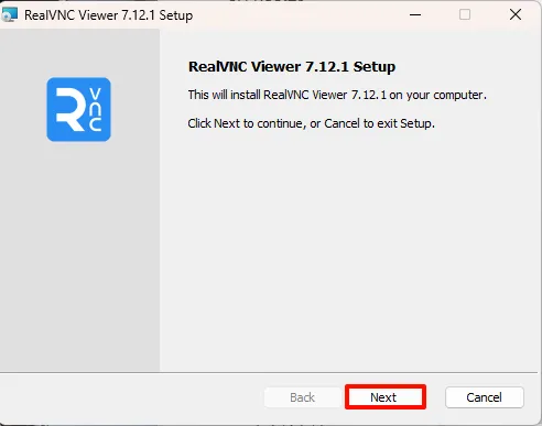

  • Enter installation
Click Next to enter the installation program.

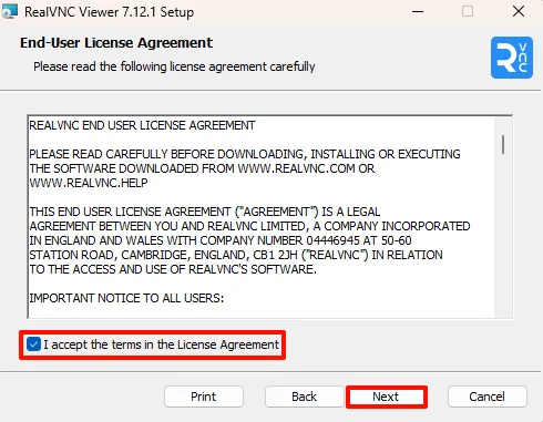

  • Accept agreement
Check the License agreement and click Next to continue.

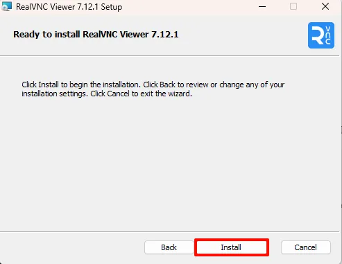

  • Start installation
Click Install to start the installation.

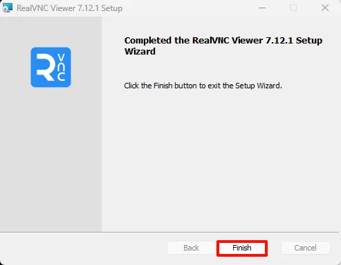

  • Complete installation
Click Finish to complete the installation.

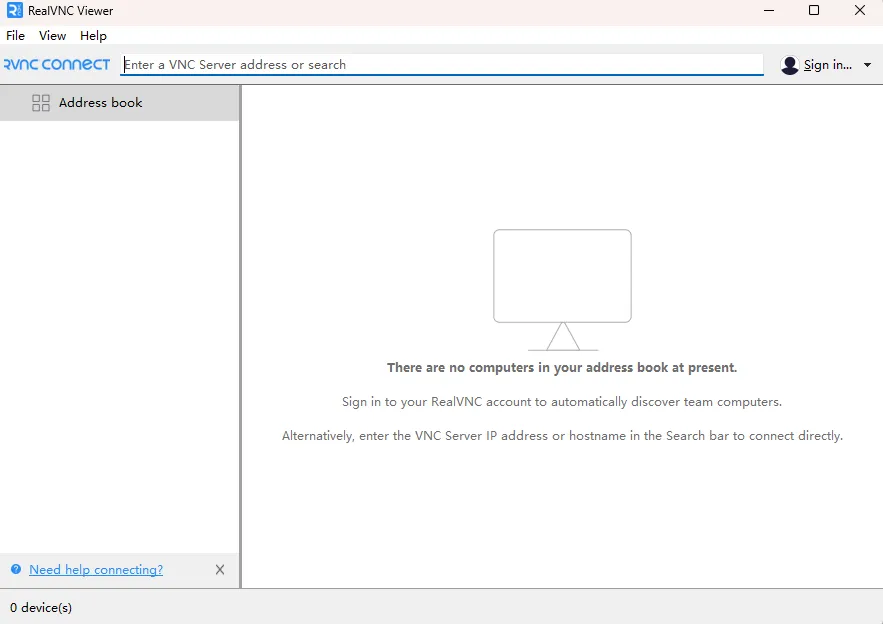

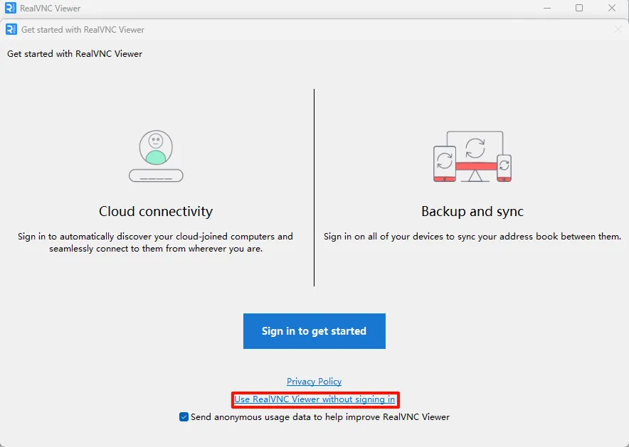

Run VNC Viewer
After installation, open the VNC Viewer software. You can choose to use VNC Viewer without logging into an account.
VNC Viewer Interface

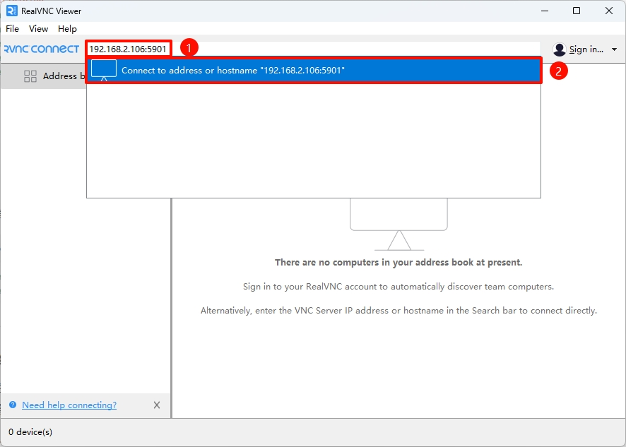

On another device, open the VNC Viewer software and connect to the board using its IP address and port number.
① : Enter the board's IP address and port number
② : Click Connect to address ··· to connect to the board

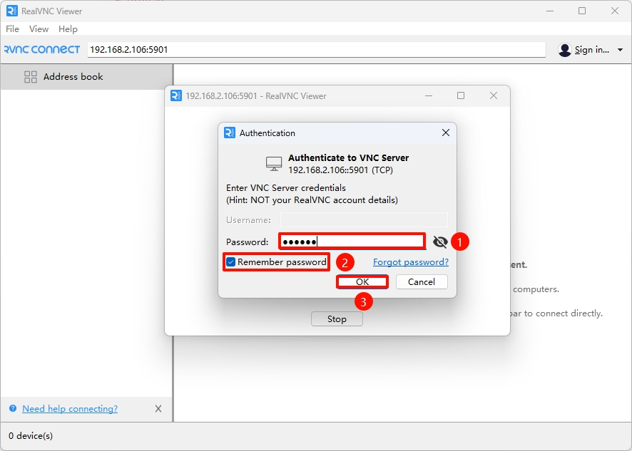

① : Enter the VNC remote password you set earlier
② : Check the Remember password option to save the password for future logins
③ : Click OK to connect

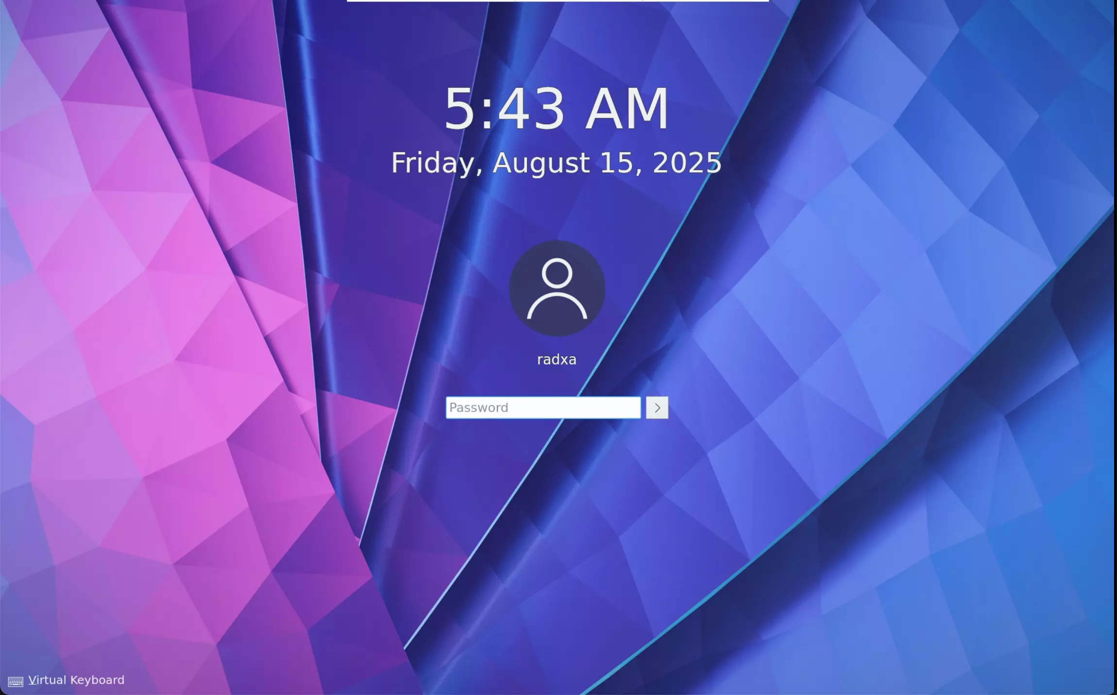

VNC Black Screen
If you encounter a black screen when connecting via VNC, check if the system's auto-login feature is enabled. If it is, try disabling the auto-login option.
