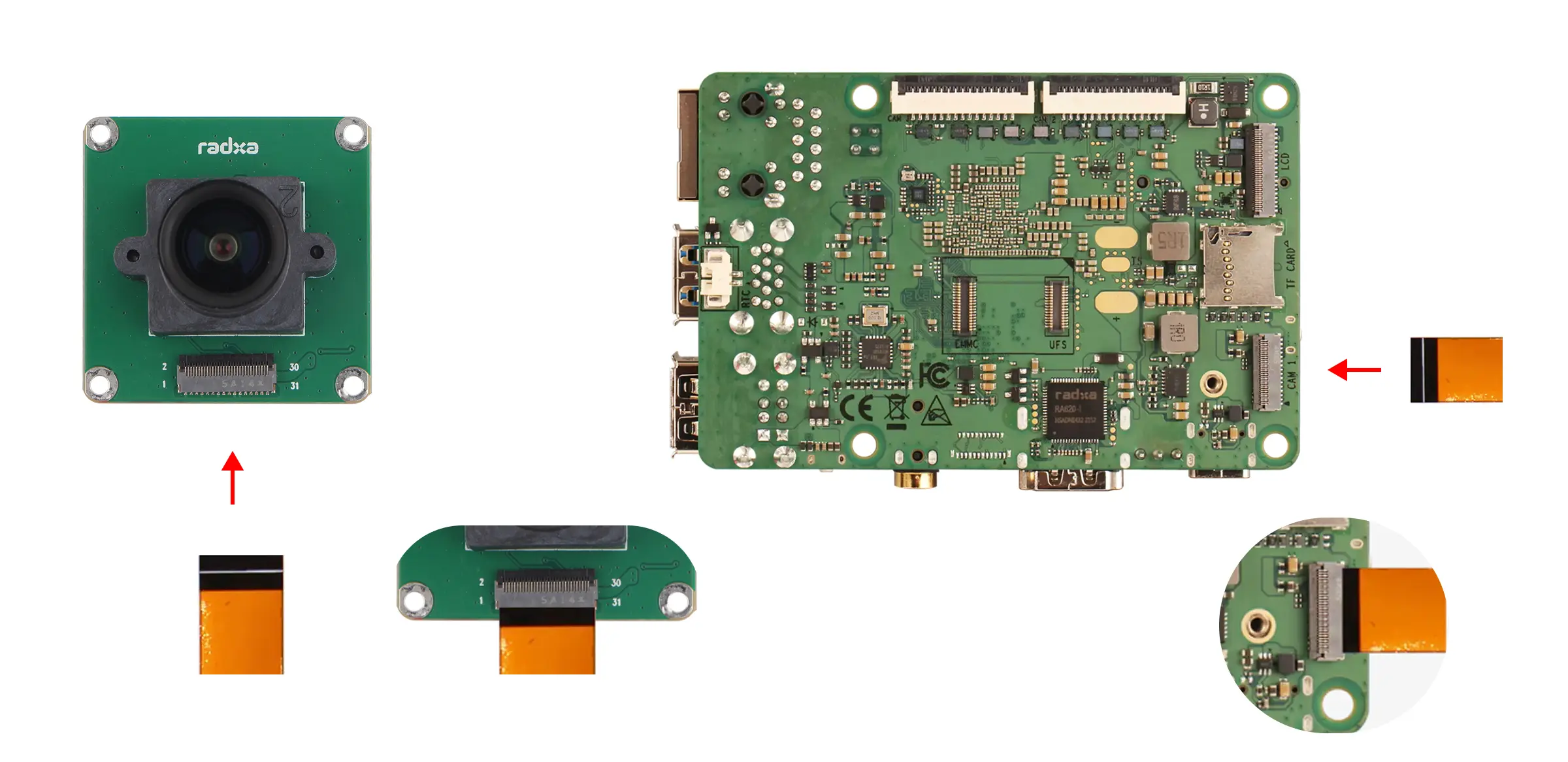

Camera FPC cable​
Hardware connection​
Notes
