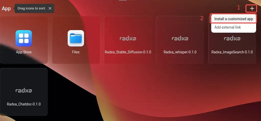

  • Click the "+" icon in the CasaOS App bar and select "Install a customized app"
    CasaOS App Installation Settings

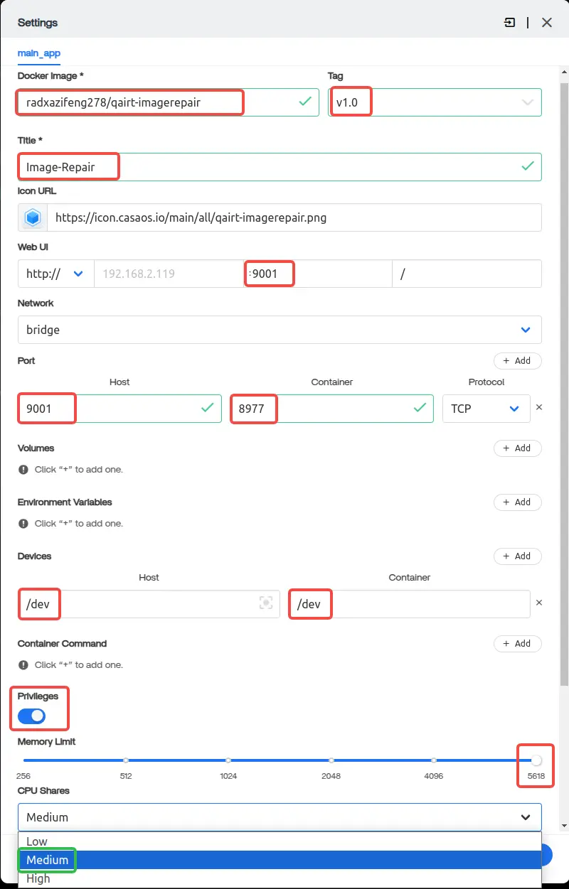

  • Fill in the required information for installing the Radxa Real-ESRGAN (QCS6490) container
    CasaOS App Installation Configuration
  • Configuration Details
    Docker Image: The image name that will be automatically pulled from Docker Hub
    radxazifeng278/qairt-imagerepair:v1.0
    Title: App name (user-defined)
    Icon URL: App icon (optional)
    Web UI Port: The default access port for the app. Recommended to choose between 7000-10000 and must not conflict with other CasaOS app ports
    Port: Docker container port mapping. The host port is the Web UI port specified above, container port is 8977
    8977
    Devices: Mount the NPU into the Docker container. It's recommended to mount all devices
    • Host:
      /dev
    • Container:
      /dev
    Privileges: Enable to obtain root privileges
    Memory Limit: Container memory limit, recommended to set to maximum, otherwise the service may fail to start
    CPU Shares: CPU allocation, recommended: Medium
    radxa Real-ESRGAN
    Docker Imageradxazifeng278/qairt-imagerepair:v1.0
    TitleImage Repair
    Web UI port9001
    Host Port9001
    Container Port8977
    Host Devices/dev
    Container Devices/dev
    PrivilegesOn
    Memory LimitMax
    CPU SharesMedium

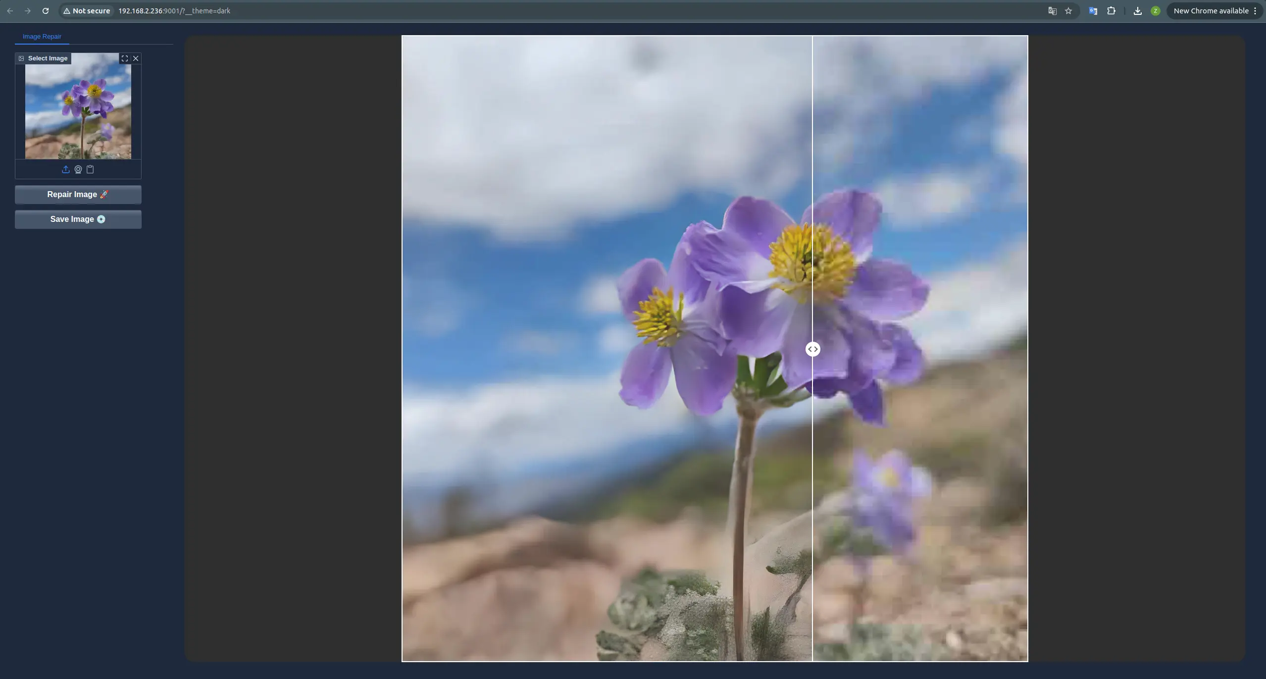

    Real-ESRGAN AI Image Restoration App Interface

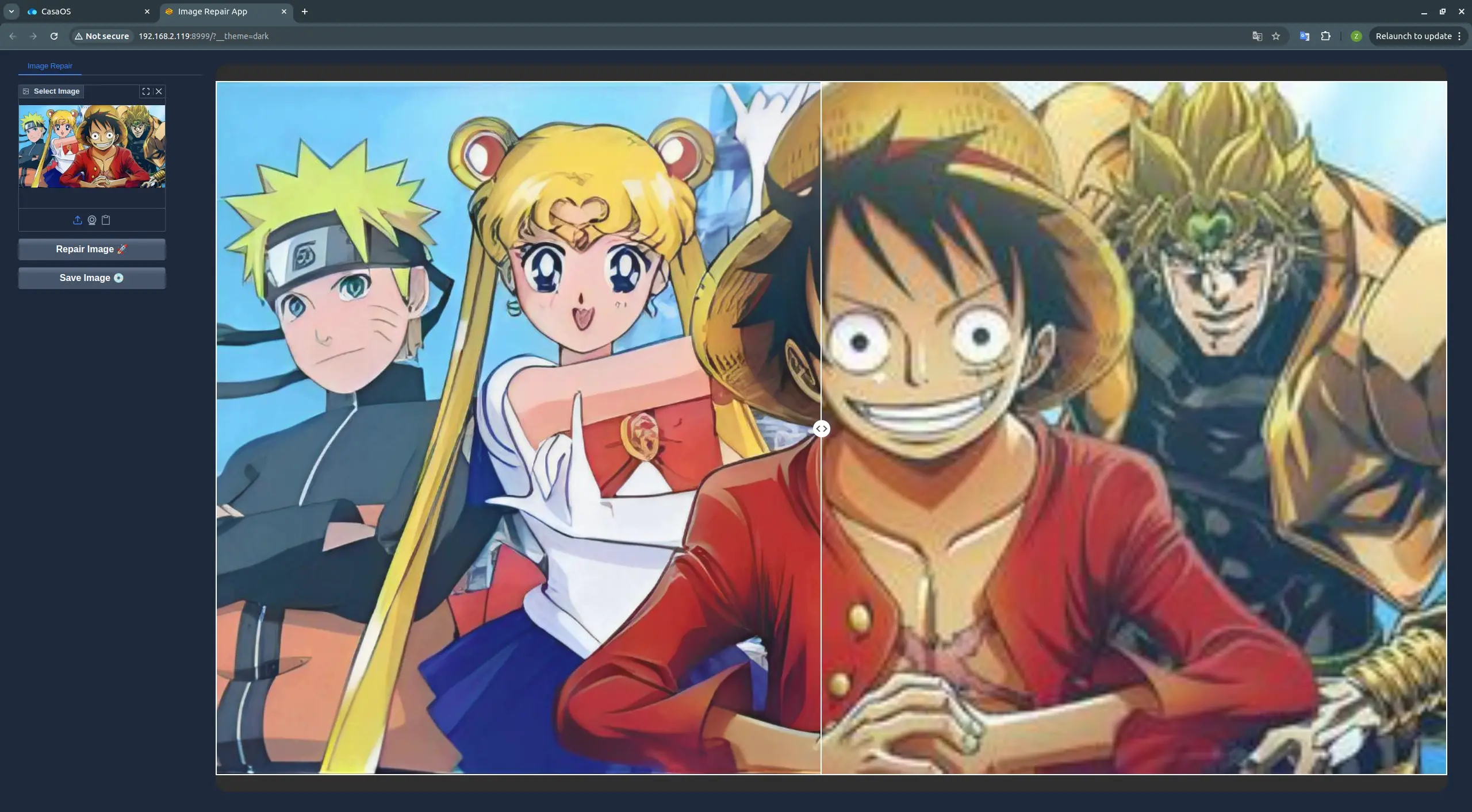

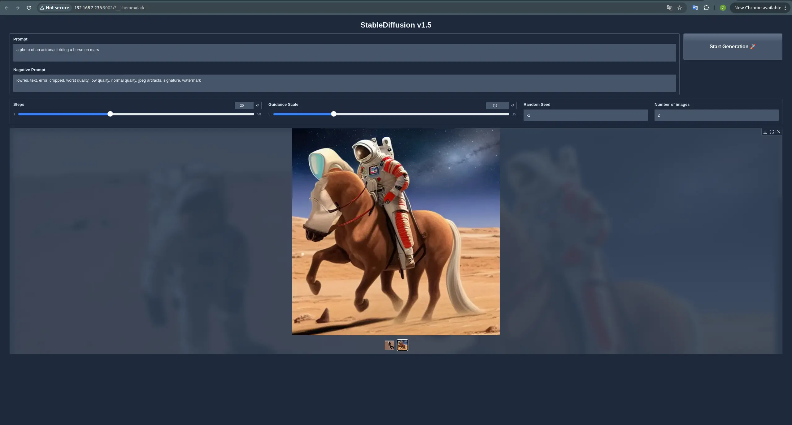

Installing StableDiffusion v1.5 Text-to-Image App (QCS9075)​
  • Fill in the required information for installing the Radxa StableDiffusion v1.5 (QCS9075) container
    radxa StableDiffusion v1.5
    Docker Imageradxazifeng278/sd1.5-9075:v1.3
    TitleStableDiffusion v1.5
    Web UI port9002
    Host Port9002
    Container Port8978
    Host Devices/dev
    PrivilegesOn
    Memory LimitMax
    CPU SharesMedium
    StableDiffusion v1.5 Text-to-Image App Interface

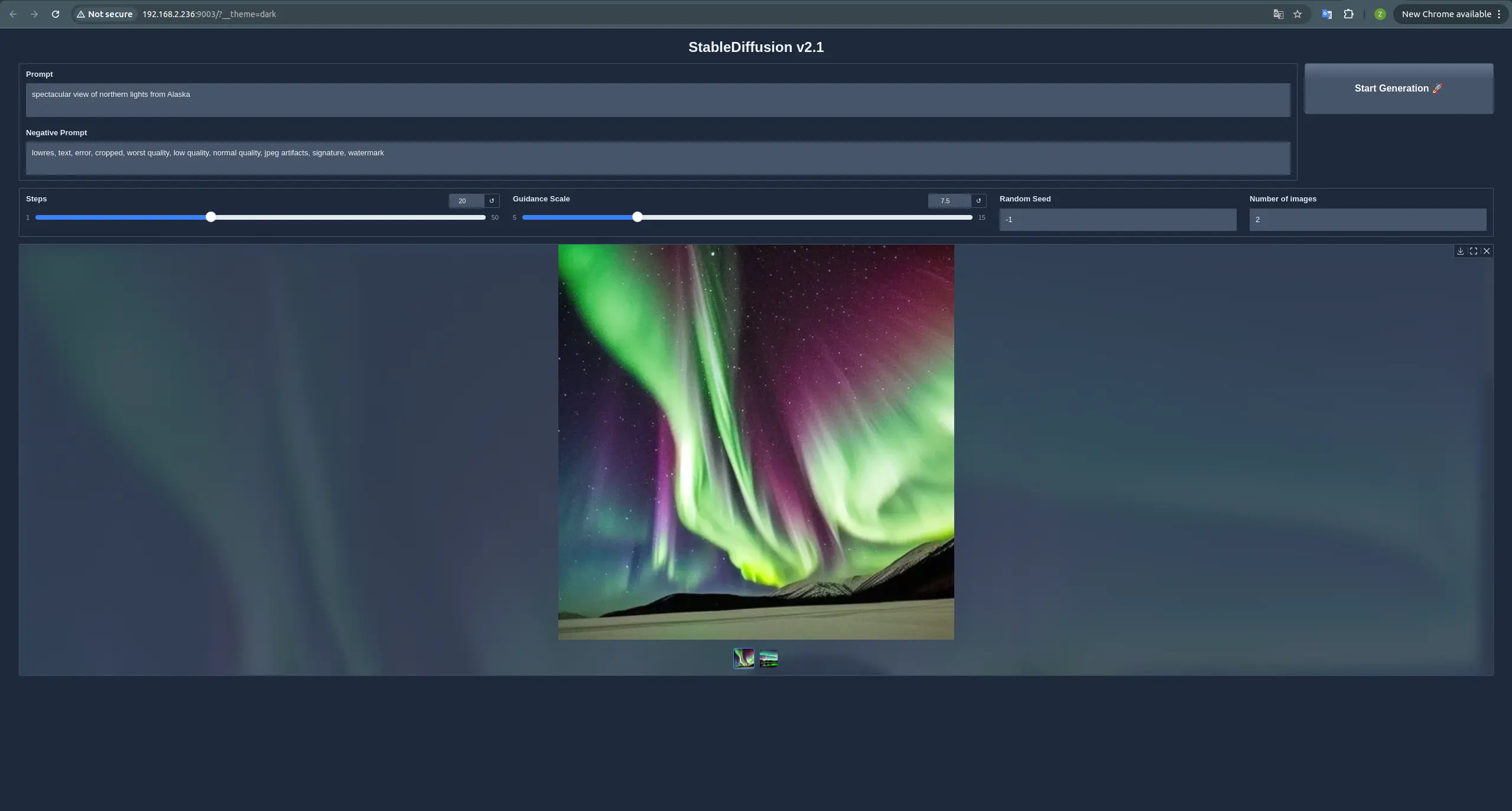

Installing StableDiffusion v2.1 Text-to-Image App (QCS9075)​
  • Fill in the required information for installing the Radxa StableDiffusion v2.1 (QCS9075) container
    radxa StableDiffusion v2.1
    Docker Imageradxazifeng278/sd2.1-9075:v1.3
    TitleStableDiffusion v2.1
    Web UI port9003
    Host Port9003
    Container Port8979
    Host Devices/dev
    PrivilegesOn
    Memory LimitMax
    CPU SharesMedium
    StableDiffusion v2.1 Text-to-Image App Interface

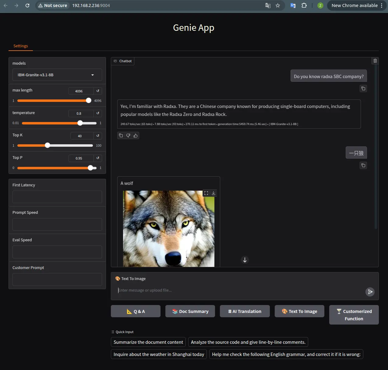

Installing Genie App (QCS9075)​
Genie APP is a versatile LLM chat software that integrates IBM Granite v3.1 8B with StableDiffusion v2.1, supporting features such as Q&A with LLM, AI translation, AI document summarization, and text-to-image generation.
  • Fill in the required information for installing the Radxa Genie App (QCS9075) container
    radxa genie-app
    Docker Imageradxazifeng278/genie-app-9075:v1.3
    TitleGenie-APP
    Web UI port9004
    Host Port9004
    Container Port8976
    Host Devices/dev
    PrivilegesOn
    Memory LimitMax
    CPU SharesMedium
    Genie App Interface
