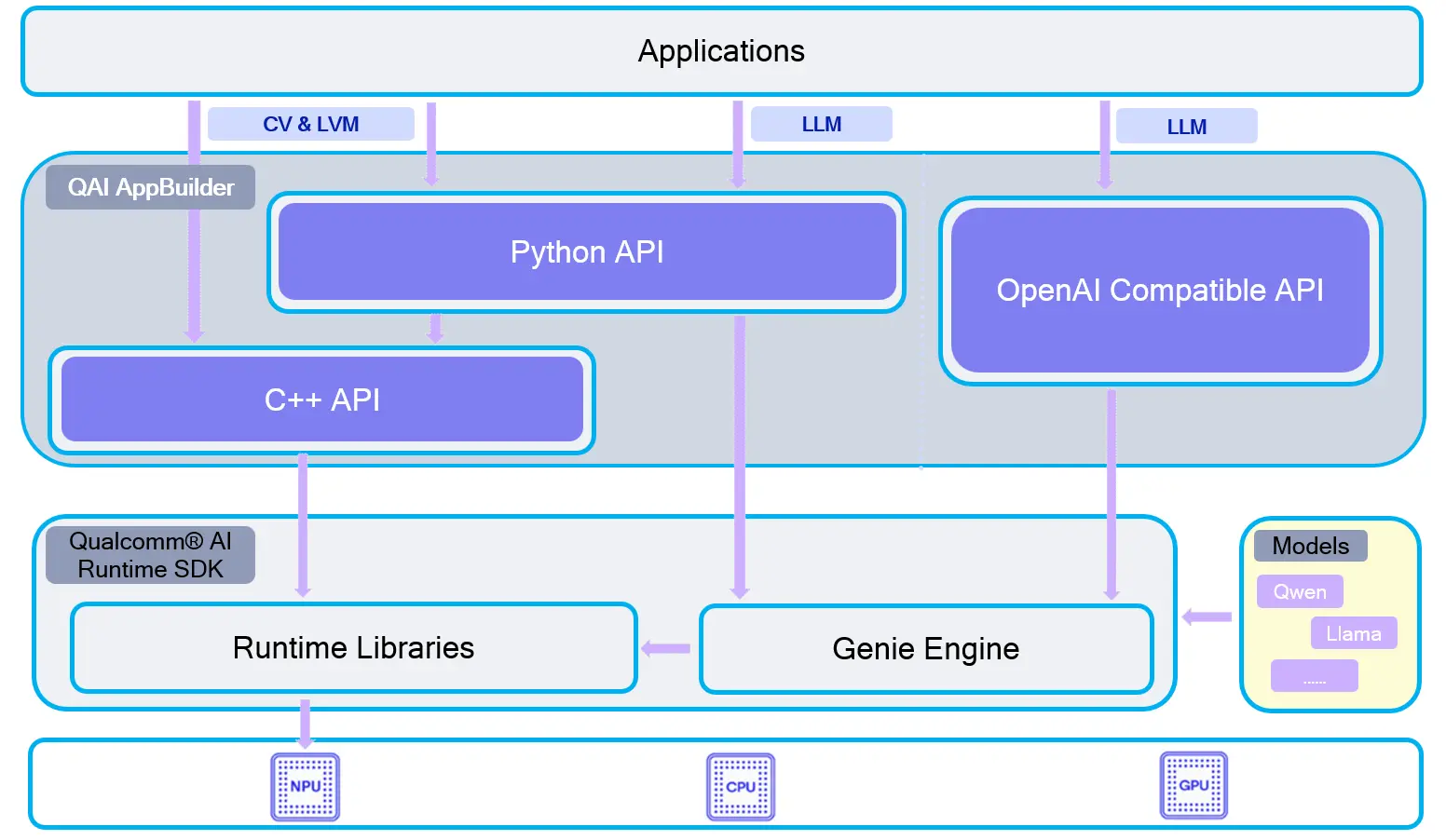

Quick AI Application Builder (QAI AppBuilder) helps developers easily use the Qualcomm® AI Runtime SDK to deploy AI models and design AI applications on Qualcomm® SoC platforms equipped with the Qualcomm® Hexagon™ Processor (NPU). It encapsulates model deployment APIs into a set of simplified interfaces for loading models to the NPU and performing inference. QAI AppBuilder significantly reduces the complexity of model deployment for developers and provides multiple demos as references for designing their own AI applications.
Supports Python API / C++ API
QAI-APPBUILDER architecture
