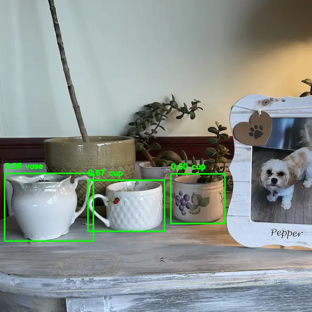

Expected result
After the output-order fix, a successful run on QCS6490 or QCS9075 writes:
ComputerVision/Object_Detection/yolov8_det/output.png
Without a display, Error: no DISPLAY environment variable specified may appear; ignore it if output.png exists and the exit code is 0.
- Example result (illustrative; actual result depends on the input and model package)
output image
