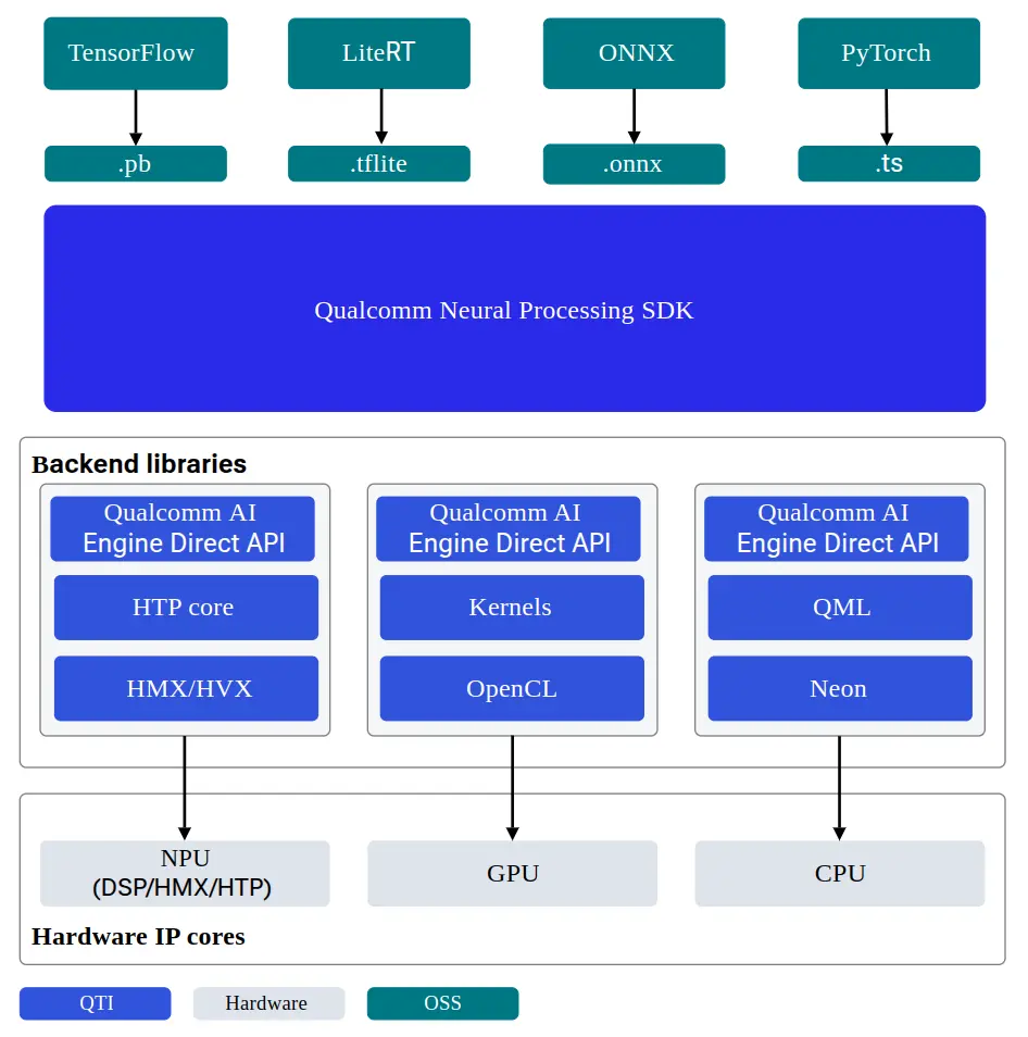

QAIRT SDK Installation
The QAIRT (Qualcomm® AI Runtime) SDK is a software package that integrates Qualcomm® AI software products, including Qualcomm® AI Engine Direct, Qualcomm® Neural Processing SDK, and Qualcomm® Genie. QAIRT provides developers with all the necessary tools for porting and deploying AI models on Qualcomm® hardware accelerators, along with the runtime for running models on CPU, GPU, and NPU.
Currently, the QAIRT SDK supports model porting for Pytorch, TensorFlow, TFLite, and ONNX frameworks.
Supported inference hardware accelerators: CPU, GPU, NPU.
QAIRT SDK Architecture
