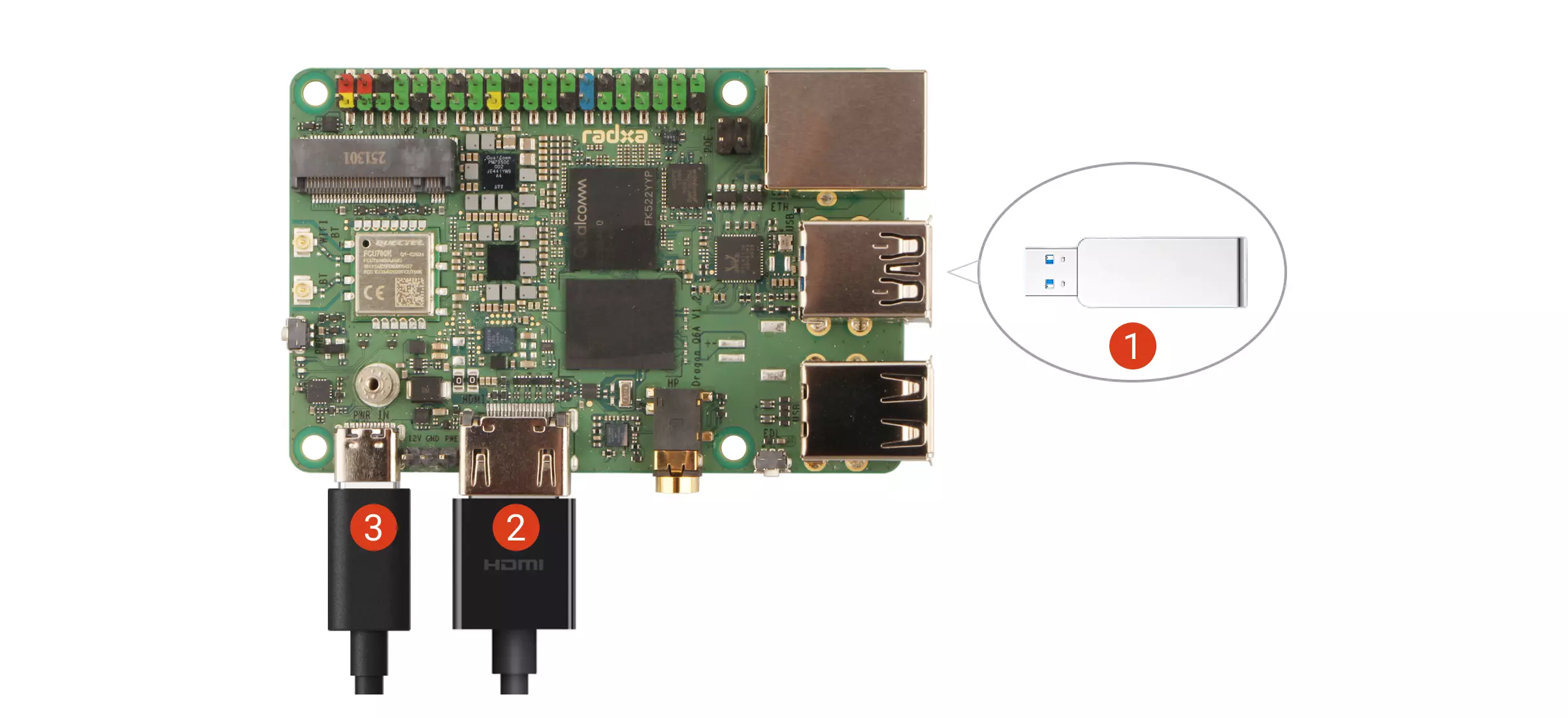

Booting the System​
After completing the system installation, insert the USB drive into the USB port of the Dragon Q6A, then power on the Dragon Q6A using the 12V Type-C power adapter to boot the system.
① : Connect the USB drive
② : Connect the monitor to the board using an HDMI cable
③ : Power on the Dragon Q6A using the 12V Type-C power adapter
When the system boots normally, the power indicator will light up green and the status LED will blink blue.
