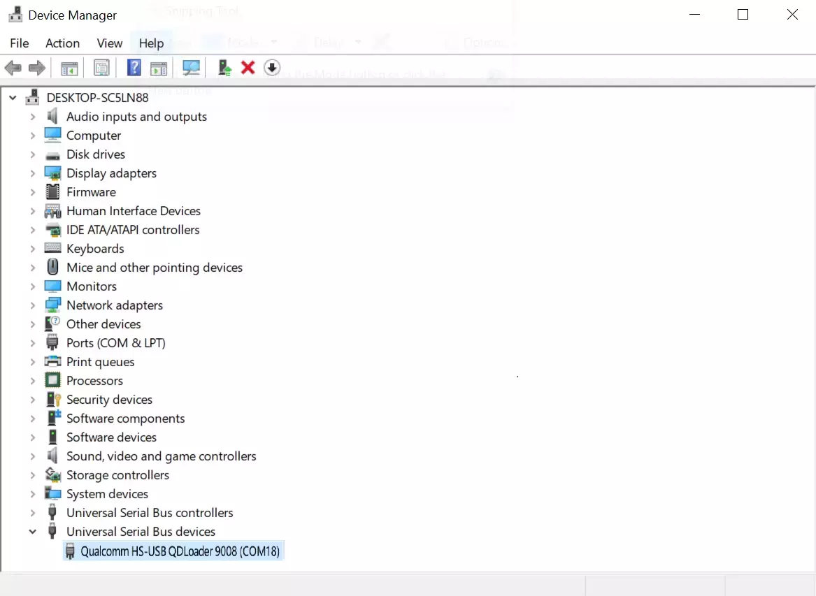

  • Device Recognition
In Windows, you can check if the device is properly recognized by opening the Device Manager.

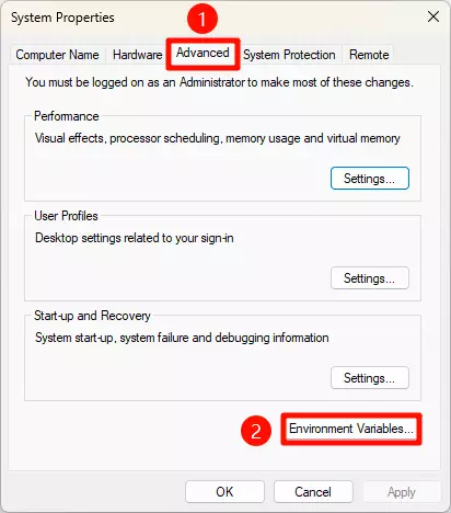

  1. Press Win + R to open the Run dialog, type sysdm.cpl, and click OK.
  1. In the System Properties window, click the Advanced tab, then click the Environment Variables... button.

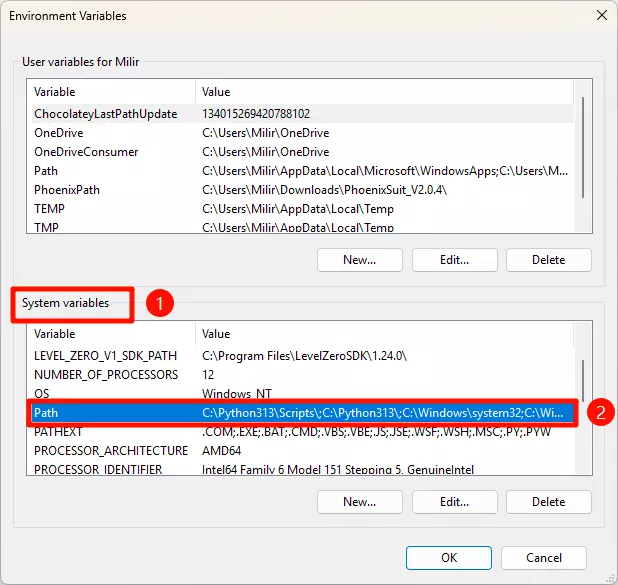

  1. In the Environment Variables window, double-click the Path variable under System variables.

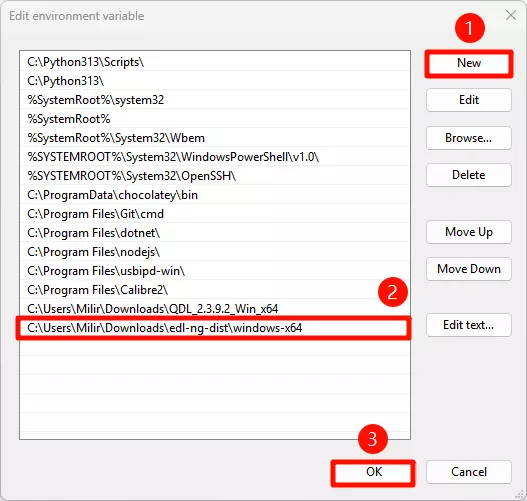

  1. In the Edit Environment Variable window, click the New button, then enter the path to your platform's EDL tools, and click OK.
