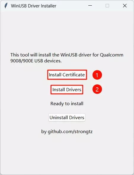

- Install the EDL driver
Double-click the qcom_winusb_drv_inst.exe
driver installation package and follow the steps below to complete the driver installation.
① : Click the Install Certificate
option to install the certificate
② : Click the Install Driver
option to install the driver

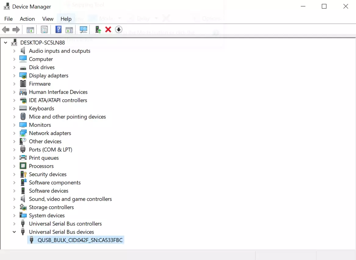

- Device recognition
In Windows systems, you can go to the system's Device Manager to check whether the device is being recognized normally.
In Linux systems, you can use the lsusb
command to check whether the device has entered EDL mode.
lsusb
After the device enters EDL mode, it will display information similar to the following:
Bus 001 Device 008: ID 05c6:9008 Qualcomm, Inc. Gobi Wireless Modem (EDL mode)
